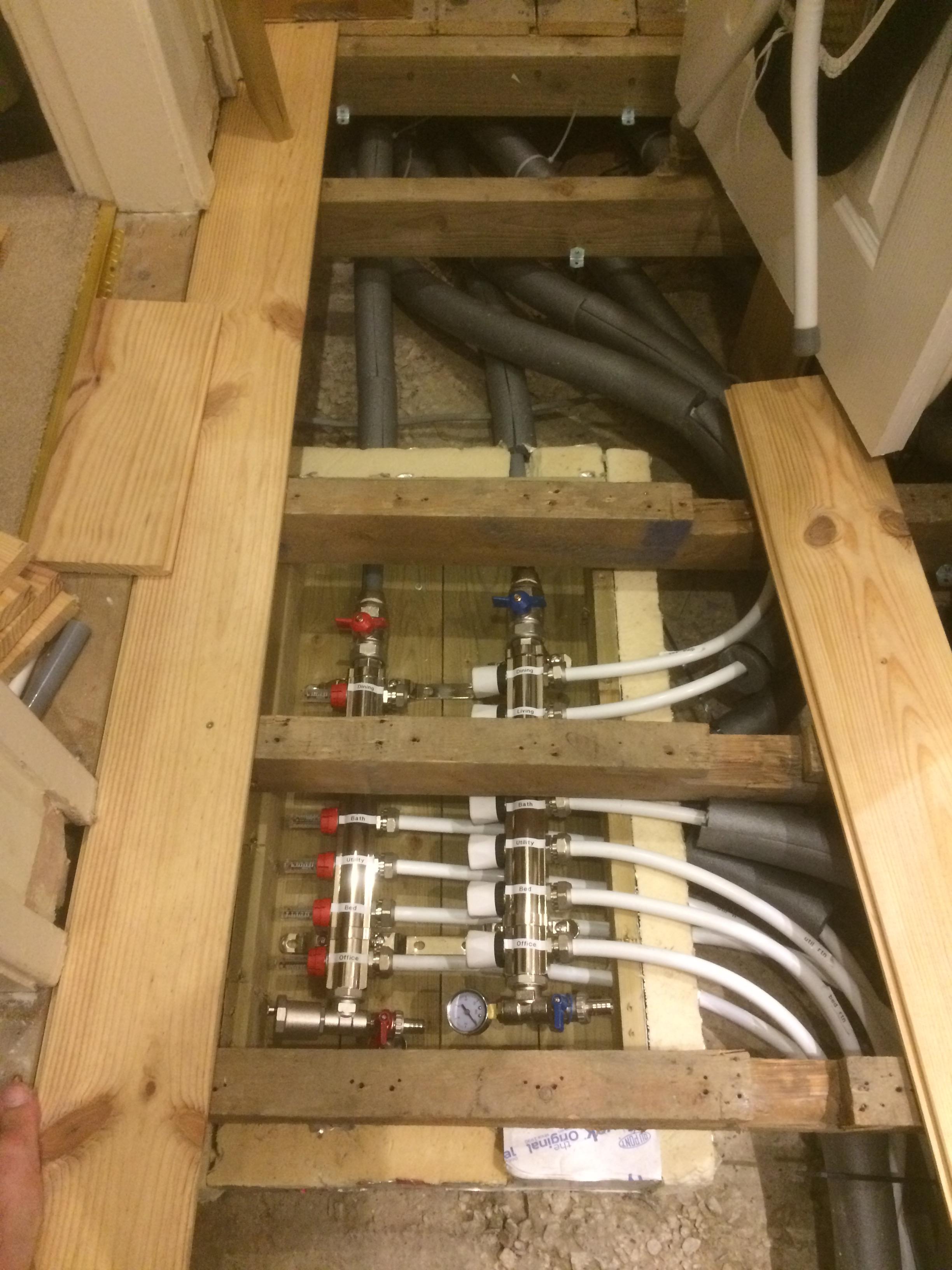

Kdlt Posted December 5, 2019 Share Posted December 5, 2019 (edited) Hello All, I am part way through doing a complete renovation on my house and recently found the buildhub forums, which have provided some great knowledge and inspiration. I am currently doing a complete re-plumb and after reading multiple threads on here and seeing Pics of NickTheWelsh Wizards manifold installs, i decided that was definitely the way to go. So, i've bought a load of Hep20 pipe and and several brass 4 way manifolds and have spent the last few days running all of the pipes for hot and cold water. Next i will need to run the pipes for all of the radiators. What is the buildhub best practice / recommended way of doing these? Do i run them all on separate pipe runs for flow and return from each rad back to manifolds in same way as the hot and cold pipes? Any tips on the best way to do it and which components to use would be much appreciated. Thanks in advance. Edited December 5, 2019 by Kdlt Added detail 1 Link to comment Share on other sites More sharing options...
MikeGrahamT21 Posted December 6, 2019 Share Posted December 6, 2019 Yeah each radiator would have its own dedicated flow and return, otherwise theres not much point in having a manifold. No special components, just your pipe of choice, insulation, lockshield and TRV ? and a lot of patience if you aren't ripping all your floors up. Link to comment Share on other sites More sharing options...

Raks Posted January 3, 2020 Share Posted January 3, 2020 2 hours ago, MikeGrahamT21 said: I finished the radiator system over a year ago now, its worked really well, definitely as well as I expected Do you know which manifold and pipe brand did they use? I was suggested to use hep2o for manifold and pipe system as most of the European brands do not have 15mm standard pipes, but that 15mm is a barrier pipe (pb or pex) without an aluminium layer (no MLCP). I wonder if that makes any difference in performance and long term. Because we will connect 10+ radiators and each are 5 to 8 meters away from the manifold, it was an pumped manifold. (same as the UFH) ps: I was gonna ask the same questions to @Kdlt about the manifolds and pipe choices. Link to comment Share on other sites More sharing options...
MikeGrahamT21 Posted January 3, 2020 Share Posted January 3, 2020 Everything came from this place: https://pswtradesuppliers.co.uk/ I used 16mm MLCP as I found that products such as Hep2o, and JG, although having an oxygen barrier (very important in a CH system), they only seemed to be viable up to about 50C, which is no good for CH, hence why I chose to use 16mm pipe and the relevant euro cones, which I found very easy. More importantly, the eurocones actually fit inside the normal TRVs/Lockshields, so instantly become compatible with little outlay. Oxygen barrier is very important as it will protect your radiators from corrosion. I have a few radiators which are about 10m away from the manifold, and haven't noticed any issues without a pump, get a solid 2ltr/min flow on all of the rads when all are fully open. Link to comment Share on other sites More sharing options...
