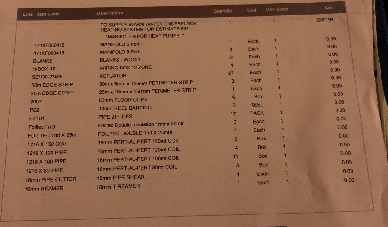

Hi i am ordering my ufh through WUNDA  using the castellated plates I have a choice of two pipe types   PERT/AL/PERT   or  HDPE- AL – PEX     approximately  130sq m
with 12 port manifold supplied from 8.5kW ashp  on reading all the posts on hear pex al pex would seem to be the preferred option
but WUNDA have the choice of these two pipes
On the WUNDA site it states HDPE pipe is hard to work with especially with tight bends
Will the PERT/AL/PERT be a better choice over HDPE  for a first time installer ?  meaning me and whoever I can rope in

just had a look at my invoice but it doesn't detail the type of pipe, it was either pert or pex. i think it may have been pert and the job's a doddle with the castellations
Edited by Simplysimon
spelling
Here’s my invoice from Wunda albeit ages ago. Can confirm that the pipe was easy to work with (first time installers).
See towards the end of this thread.
Thanks all I think it will be the pert al pert as that would seem to make it a bit easier.   Thanks.  Adam
