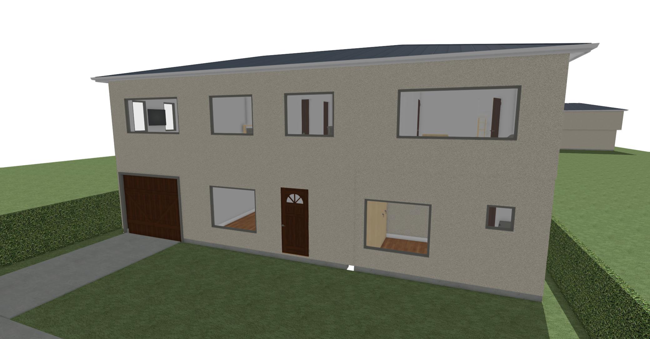

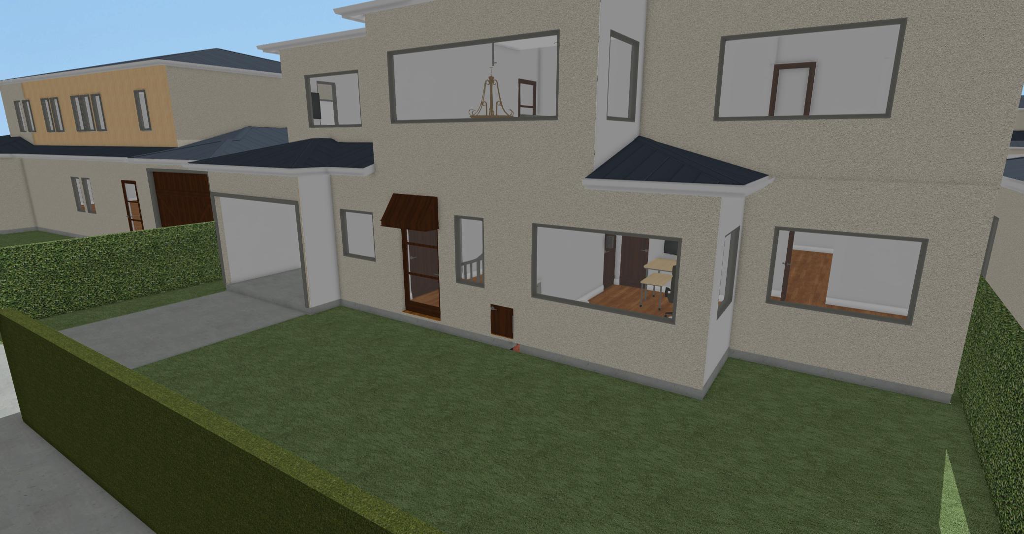

Ferdinand Posted December 6, 2019 Share Posted December 6, 2019 (edited) Trust you welcome a candid comment; I am taking it that you are exploring the universe of possibilities. IMO this one will be very (and unnecessarily) expensive to build because of all those stepins from GND to 1st Floor - as I make it you have about 20-25m of upstairs outside wall which is above voids on the Ground Floor, and the corresponding amount of single storey roof. Won't that mean umpteen columns and beams, each of which will cost you £500+ extra? And then you will have sealing and jointing and flashing and cold bridge and access problems. Simplify away the vast majority of it by adjusting your room sizes. On the design approach, I get a feeling that you are still doing a bottom up "sum of parts" thing - here starting with a list of rooms and what you want each one to be, rather than looking at the house as a whole. Even the (good) presentation is a series of tableaux rather than a walkthrough of a house. You need a unified whole. I am slightly reminded of the Windmill Theatre "tableaux vivant" circa late 1930s in the design/presentation; I want a full blown Moulin Rouge Can Can instead. I think you are being driven by what other people do, or find acceptable, rather than thinking about your own requirements. "What is normal" or "what do other people want" are questions for a developer. Self builders can nod to them, but they should imo be subsidiary. Trust yourself. On details, I agree with @epsilonGreedy that there is too much subdivision. IMO the way to get wow in a relatively small house is to have fewer, larger rooms, using vistas etc creatively. There is also imo a too-large amount of circulation space. What is that long balcony expressly to be able to have a pot plant at the end ? ? Put the espace in the bedroom. On that sneak pantry: two points. Firstly the need for it is a symptom of a different problem - access to the kitchen is not thought out thoroughly. Secondly, it is a pink elephant - what does the extra door, the corridor, and 3 cupboards add over a simple door from the hall to the generous utility? Put the space in the hall to give you WOW, make the loo a better size with a shower for infirm visitors, and put the cupboards in the utility. (Were you to stick with the sneak pantry I would say put the 2 doors opposite each other at the kitchen end and make the rest a bigger shower and proper cloak closet.) On fixing the layout, I would probably put the theatre front to back on the RHS, incorporating the playroom (gives you your 5.5m). I would then make the kitchen-diner-living into one room screened off from the theatre, by a wall or those bifolds. (As they are they will mean there is a 1m wide run of floor you can never use). I would make the the theatre the correct size for repurposing as a garage - may never happen but it answers a real question with a "yes, you can". Children's playroom? Somewhere else or "let them watch films" or accept that mutual-murdering and cinema will not often happen simultaneously. As you suggest, I have ignored the upstairs. But how will you clean that window at the front above the door? Ferdinand Edited December 6, 2019 by Ferdinand Link to comment Share on other sites More sharing options...

puntloos Posted December 6, 2019 Author Share Posted December 6, 2019 4 hours ago, Ferdinand said: Trust you welcome a candid comment; I am taking it that you are exploring the universe of possibilities. Absolutely not, this is the finalfinal amazeballs design worthy of the Bill S. Preston Esquire and Theodore Logan price for excellence and anyone raising any critique is wrong and makes me and multiple puppies very sad. 4 hours ago, Ferdinand said: IMO this one will be very (and unnecessarily) expensive to build because of all those stepins from GND to 1st Floor - as I make it you have about 20-25m of upstairs outside wall which is above voids on the Ground Floor, and the corresponding amount of single storey roof. Form over function, obviously. Slightly more seriously though, what I think you're saying is that for simplicity and therefore build cost, walls should ideally be in a straight line through multiple floors, not offset. Makes a ton of sense, and well, this is frankly purely laziness on my part. Meaning: our architect has provided quite a nice design for our top floor (I'm not sure I can share her work freely on this open forum.. I think they retain some ownership on this, plus they were just sketches so far. I can share privately if interested, PM me, but it wouldn't fit the ground floor either.) so the top floor of this house is not really mindfully designed to actually fit, but really just a bunch of ideas thrown together. You're very right that ha, pretty much no 1st floor walls match with the ground floor ones. I award myself a B- for Bogus design. Single-storey roof though, not sure if that's a problem? I guess we have 'more than one roof' - one 2nd floor and "a few" 1st floor sections, is that dramatically more costly than one big roof? I'm sure it is.. but the house does look prettier for it. As an example - compare a pretty old version of the house design: with the current (sorry a bunch of render artifacts in the current that I meant to fix, but you get the idea) Perhaps it's not worth the $$$ and of course mindful of your point of supporting walls vs beams and columns etc but IMO the new one is a more aesthetically pleasing design.. 4 hours ago, Ferdinand said: Won't that mean umpteen columns and beams, each of which will cost you £500+ extra? Uh. Ask a pro, not me. QUick note: many people speak about very expensive omgomg and actually mean "5000 GBP extra cost" - yes it adds up and I strongly appreciate sturdy/solid/elegant designs, but purely from a financial point of view 5000 isn't making me blink too badly.. 4 hours ago, Ferdinand said: And then you will have sealing and jointing and flashing and cold bridge and access problems. Simplify away the vast majority of it by adjusting your room sizes. Yup, sounds sensible 4 hours ago, Ferdinand said: On the design approach, I get a feeling that you are still doing a bottom up "sum of parts" thing - here starting with a list of rooms and what you want each one to be, rather than looking at the house as a whole. Even the (good) presentation is a series of tableaux rather than a walkthrough of a house. Difficult to be honest about from my point of view, I'd like to think my view is more 'as a whole' than you give credit for but frankly it is true that my requirements doc provides a ton of 'atomic' requirements that are patched together rather than a big vision through and through. You and I had the same discussion earlier and perhaps I'm too engineery and not artistic enough ... for one, this is exactly why I'm using a proper architect in this as well I'm hoping my design has a decent philosophy behind it, and ticks a ton of boxes.. but there you go 4 hours ago, Ferdinand said: You need a unified whole. I am slightly reminded of the Windmill Theatre "tableaux vivant" circa late 1930s in the design/presentation; I want a full blown Moulin Rouge Can Can instead. Do you have some examples of what it would look like? 4 hours ago, Ferdinand said: I think you are being driven by what other people do, or find acceptable, rather than thinking about your own requirements. "What is normal" or "what do other people want" are questions for a developer. Self builders can nod to them, but they should imo be subsidiary. Trust yourself. Well, I do agree, but if anything that's what I'd argue I was doing.. for example not going for a full garage, having a large hall sacrificing 'bedrooms' (both number and size.. I could easily do 5BR if I really wanted) etc. 4 hours ago, Ferdinand said: On details, I agree with @epsilonGreedy that there is too much subdivision. IMO the way to get wow in a relatively small house is to have fewer, larger rooms, Well, surely that's exactly what we have with the very oversized living area? 4 hours ago, Ferdinand said: using vistas etc creatively. Example? As for under-sized rooms: - Utility is currently massive, obviously. Only turning it into a real garage is a compromise the 'next buyer' could choose to make - Sneak pantry... I could imagine this going away in favor of even larger garage but there should be plenty storage anyway.. it got there mainly because the wife envisioned the whole 'not bothering the movie-watchers' scenario. - secret/consumer unit- reason it's there is that for having a nice TV watching experience, the office was actually too big.. the sofa was far away from the screen... Anything else? I kinda agree with the 'feeling' but I'm not sure what exact steps to take. I think EGreedy suggested removing pantry/toilet, but he(she?) needs a massive garage, we definitely don't.. 4 hours ago, Ferdinand said: There is also imo a too-large amount of circulation space. This I think you might be correct in.. of course that pantry is a culprit there.. but I'm hoping our Architect will optimize that. 4 hours ago, Ferdinand said: What is that long balcony expressly to be able to have a pot plant at the end ? ? Yes, that's Ferdy the Fern. No, it's.. one of the artifacts of my design crappitude.. which is that my top floor is not reallly solidly designed. The key reason that I didn't do your below suggestion: 4 hours ago, Ferdinand said: Put the espace in the bedroom. Is exactly because the space is only a small amount of sqm and it makes the spacious feel of the hallway much much better in the renders: vs I would much prefer that walkway to 'go somewhere sensible' but even when it doesn't, the spaciousness seems to matter... 4 hours ago, Ferdinand said: On that sneak pantry: two points. Firstly the need for it is a symptom of a different problem - access to the kitchen is not thought out thoroughly. Well, perhaps.. I'd love to hear better solutions.. maybe I'm a cynic but I think *most* of houses such as this one don't have any solution for 'sneaking into the kitchen while the main living is in use' use case, they just assume that people will have to deal with people barging through the 'theatre'.. But maybe no solution is better than a poor one? 4 hours ago, Ferdinand said: Secondly, it is a pink elephant - what does the extra door, the corridor, and 3 cupboards add over a simple door from the hall to the generous utility? Put the space in the hall to give you WOW, make the loo a better size with a shower for infirm visitors, and put the cupboards in the utility. It's a fair point. I guess this might come from my simple assumption to create a small-but-feasible optional garage, and take everything else from there. The space was there, the hallway had to be in its current place to not clash with the pillars in the living room... it's good of you to flag since it might not even be needed. 4 hours ago, Ferdinand said: (Were you to stick with the sneak pantry I would say put the 2 doors opposite each other at the kitchen end and make the rest a bigger shower and proper cloak closet.) Good idea. Hm, choices. 4 hours ago, Ferdinand said: On fixing the layout, I would probably put the theatre front to back on the RHS, incorporating the playroom (gives you your 5.5m). The problem with such a design would be that we enjoy "looking at the garden" - in particular from the seating area. Either the seats would face directly away from the garden(as I think you are proposing), or the screen would block said garden view... 4 hours ago, Ferdinand said: I would then make the kitchen-diner-living into one room screened off from the theatre, by a wall or those bifolds. (As they are they will mean there is a 1m wide run of floor you can never use). Someone put it to us once that "unused space is a luxury" - I wonder if thats a correct sentiment in general and here in particular. Agreed that you could never put something permanent where the bifolds are now, but Id note that the bifolds will probably be open 99% of the year, only to close in the case of guests who we would want to shield from kitchen mess/noise. 4 hours ago, Ferdinand said: I would make the the theatre the correct size for repurposing as a garage - may never happen but it answers a real question with a "yes, you can". This is an interesting idea i'd have to mull over a bit more, thanks. Still, the point stands that in your proposed spot, the cineroom would be too 'cine-room-y' and not 'family-living-area-with-nice-multimedia-y' 4 hours ago, Ferdinand said: Children's playroom? Somewhere else or "let them watch films" or accept that mutual-murdering and cinema will not often happen simultaneously. - eh, depends on how many kids there will be 4 hours ago, Ferdinand said: As you suggest, I have ignored the upstairs. But how will you clean that window at the front above the door? "Very Carefully" .. Worth thinking about but that one doesn't sound too hard with some extend-o-pole-swiping thing. A lot harder with windows above a piece of flat-ish roof on the 1st floor. Thanks a ton for all your candid comments, they are much appreciated, I was hoping for you to respond 1 Link to comment Share on other sites More sharing options...

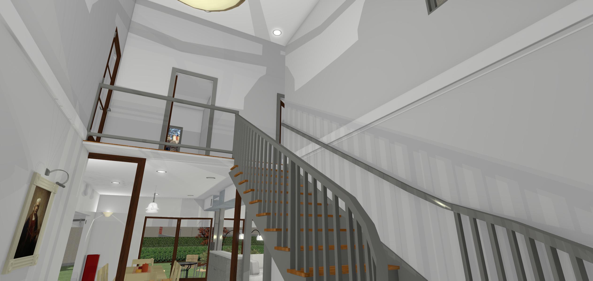

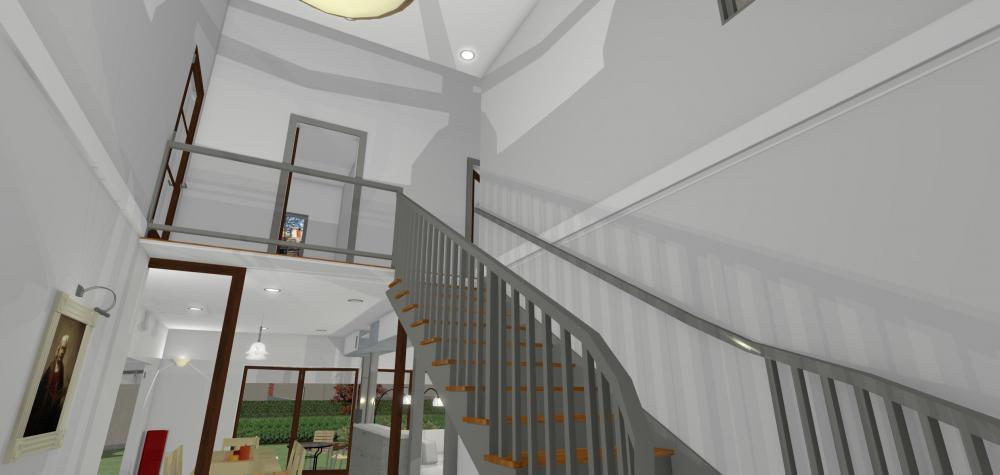

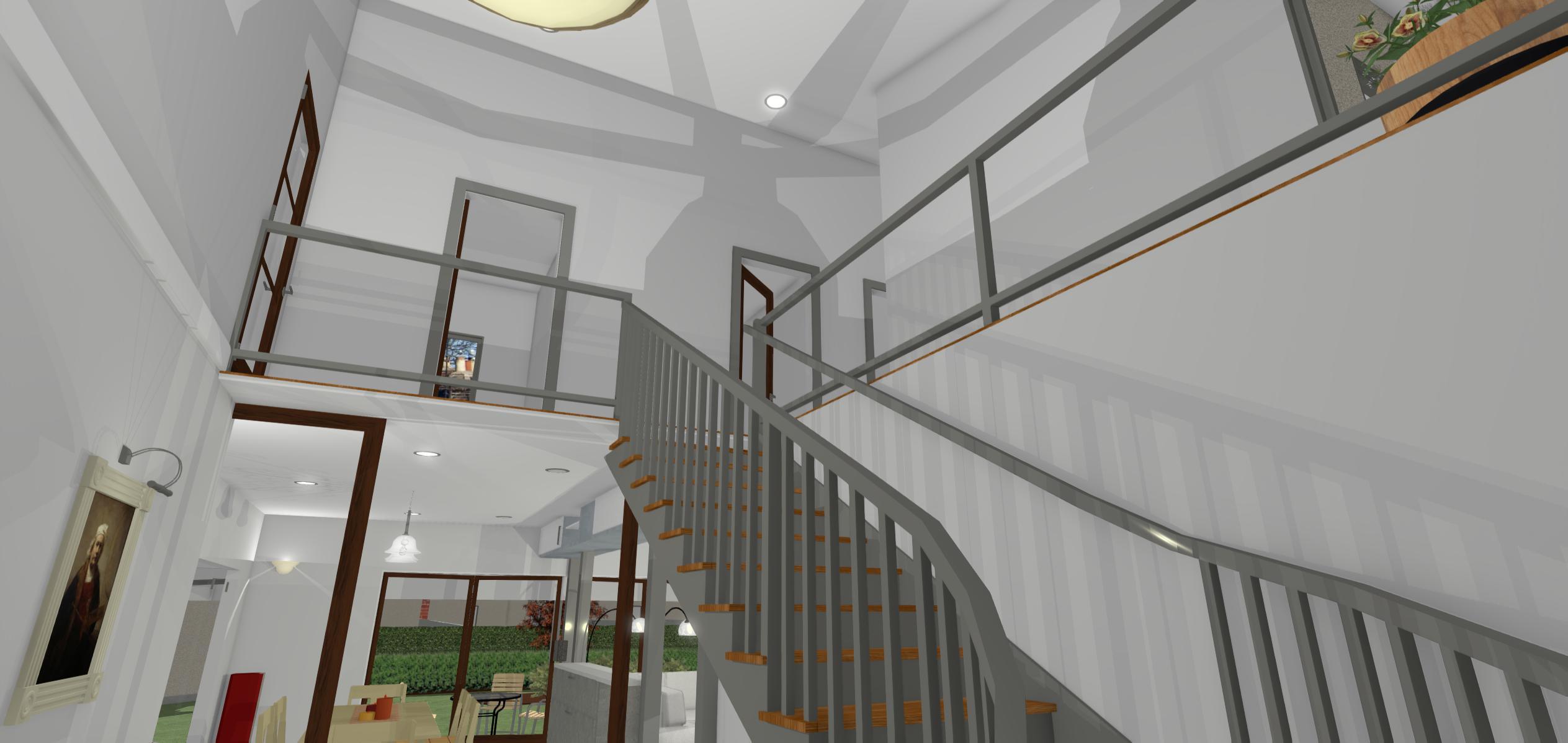

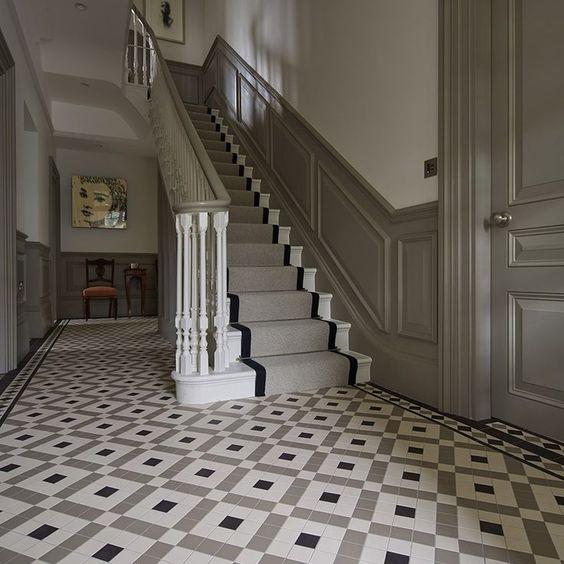

Ferdinand Posted December 7, 2019 Share Posted December 7, 2019 (edited) Followup. I think that WOW in a hall depends on having a huge space (say with a staircase AND a dining table - in our family small manor house there was a Jacobean staircase with a 15ft high x 6ft wide arched window, and the hall was about 20ft x 16ft in addition), or playing to create perceptions of space. Surprises also help, so eg a dark low ceiling porch into a bright high ceiling space is dramatic - Frank Loydd Wright did this in houses. Perhaps try: Pull sneak corridor into hall. Try some sort of rooflight feature to give something to draw the eye upwards. Try a dogleg staircase across the side and back, which will mean they see the double height space immediately on entering. I think that perhaps your kitchen and office are a little 'average'. In my kitchen I have 30+ 600mm unit spaces in toto (excluding utility, and counting everything), How many do you have? What happens if you pull the secret space into the office. 4m x 3m to me is neither a compact study (which would be 3x3m) nor somewhere sufficient for a big worktable in addition to the desk for holding meetings or doing 5000 piece jigsaws, Ferdinand Edited December 7, 2019 by Ferdinand 1 Link to comment Share on other sites More sharing options...

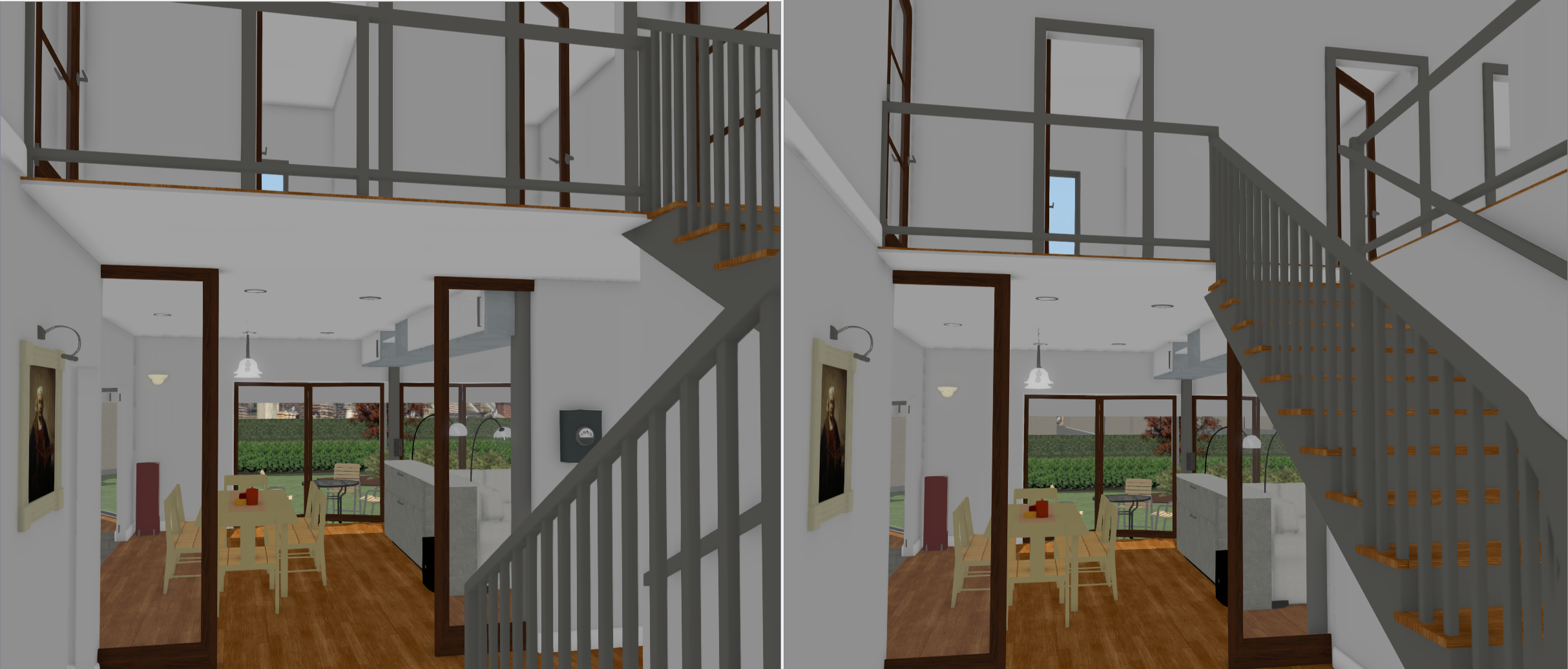

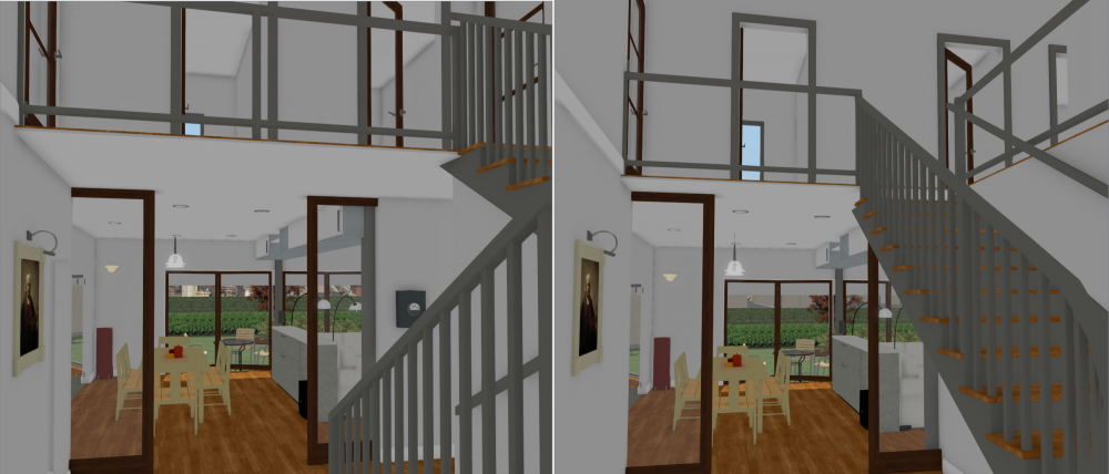

Ferdinand Posted December 12, 2019 Share Posted December 12, 2019 (edited) 1 hour ago, puntloos said: Ha, well, just doing what I can to make sure I understand the nature of the project Just hoping I'm not forgetting aardvark. Well, the main idea is that we weren't planning to create a proper loft, but instead just extending the kids room unto the roof, or perhaps having some type of ladder to a fun space in there might work.. Did my render of this - Not reflect what you had in mind? (obviously it can be done a bit more elegantly..) Hmm. indeed I think I see the idea, many staircases can only sort-of show what's above them.. a ceiling light will help, no? If you look at them, that was a standard part of the hall layout in smaller Edwardian and 1930s house which, though modest compared to a mansion, try to ape the style of larger houses. There could be some or all of: - A space inside the front door before the staircase - A small floor pattern to make it look bigger - Something to create the impression of further distance eg a chair, panelling or wall decoration - Something that can be perceived out of the other end of the hall - in your case it could be a vista through your living area and then through a window to a focal point at the end of the garden. - if you want you could try a visually closed door with a surprise space beyond, or orientation of long, narrow floor tiles. - something to stop your eye visually half way so it lingers. The trick is choice of elements, and how they are used to do what you want. Edited December 12, 2019 by Ferdinand 1 Link to comment Share on other sites More sharing options...
puntloos Posted December 12, 2019 Author Share Posted December 12, 2019 14 hours ago, Ferdinand said: If you look at them, that was a standard part of the hall layout in smaller Edwardian and 1930s house which, though modest compared to a mansion, try to ape the style of larger houses. There could be some or all of: - A space inside the front door before the staircase - A small floor pattern to make it look bigger - Something to create the impression of further distance eg a chair, panelling or wall decoration - Something that can be perceived out of the other end of the hall - in your case it could be a vista through your living area and then through a window to a focal point at the end of the garden. - if you want you could try a visually closed door with a surprise space beyond, or orientation of long, narrow floor tiles. - something to stop your eye visually half way so it lingers. These are really useful, thank you. I think that indeed perhaps the concept of an edwardian house (mini-mansion ) is perhaps interesting for me to study a bit more, trying to retain some of the 'luxurious' features of properties that are more generously proportioned.. 14 hours ago, Ferdinand said: Good picture. Not quite my style, but a more slick modern version would do the same thing. Would you agree that a 'transparent' staircase would be less mysterious than this style, so indeed the eye would move to wonder what is around the back, whilst if you can see through e.g. Link to comment Share on other sites More sharing options...

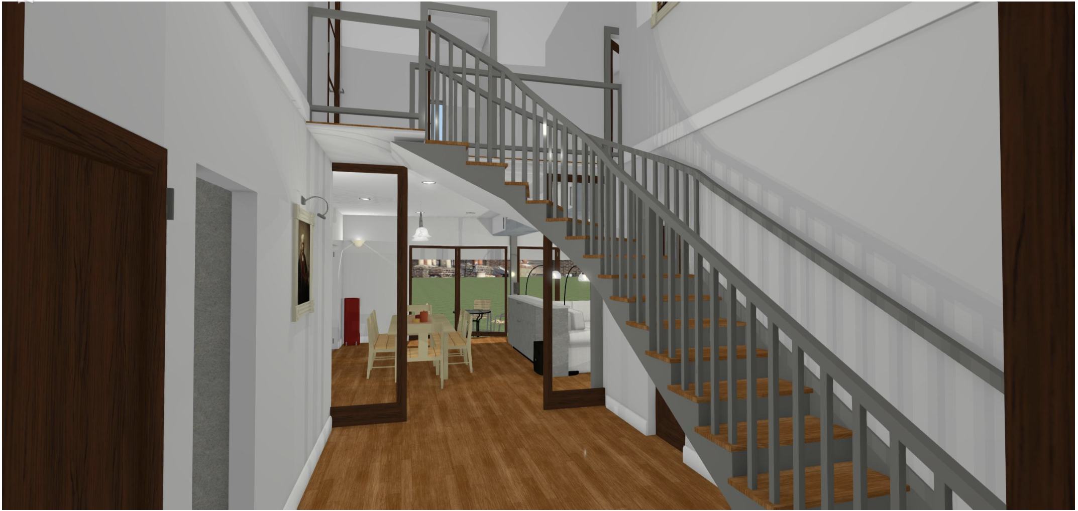

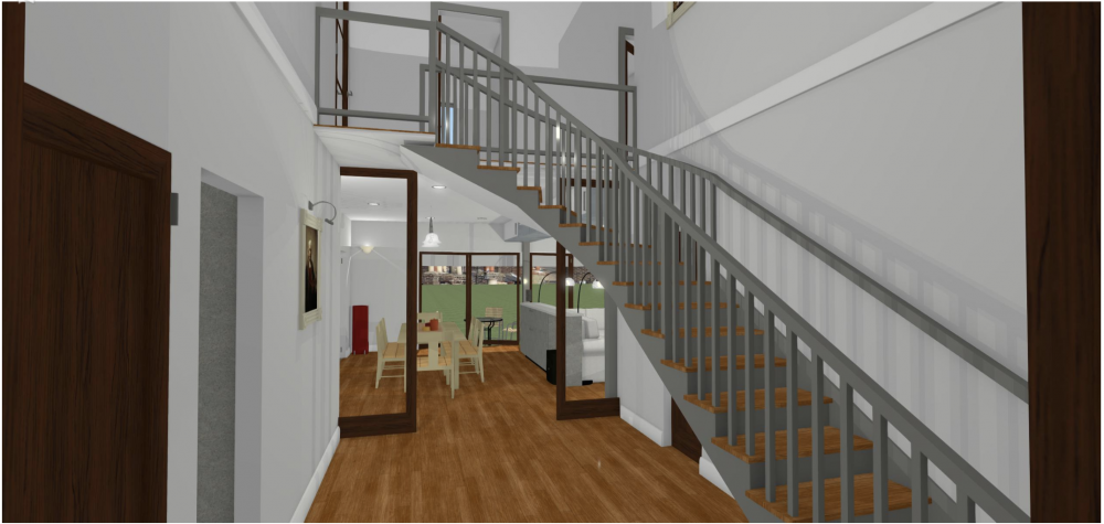

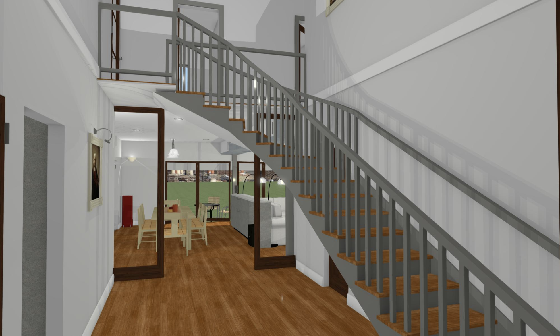

Ferdinand Posted December 12, 2019 Share Posted December 12, 2019 Any reason you can't stick the stairs on the LHS like that, put your loo under the stairs to make space at the front, and put the sneak door from the far side of the loo? Link to comment Share on other sites More sharing options...
puntloos Posted December 27, 2019 Author Share Posted December 27, 2019 On 12/12/2019 at 19:19, Ferdinand said: Any reason you can't stick the stairs on the LHS like that, Left Hand Side? No particular reason, not sure what the main difference is between LH or RH? On 12/12/2019 at 19:19, Ferdinand said: put your loo under the stairs to make space at the front, and put the sneak door from the far side of the loo? Isn't that roughly what I put in the picture (attached below) I designated 'ferdinand staircase (in my updated discussion presentation) No toilet yet but other than that basically there? Clearly swapping LH or RH curving doesn't matter too much, I could.. go either way.. Link to comment Share on other sites More sharing options...
