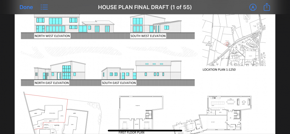

When are we going to see some pictures?

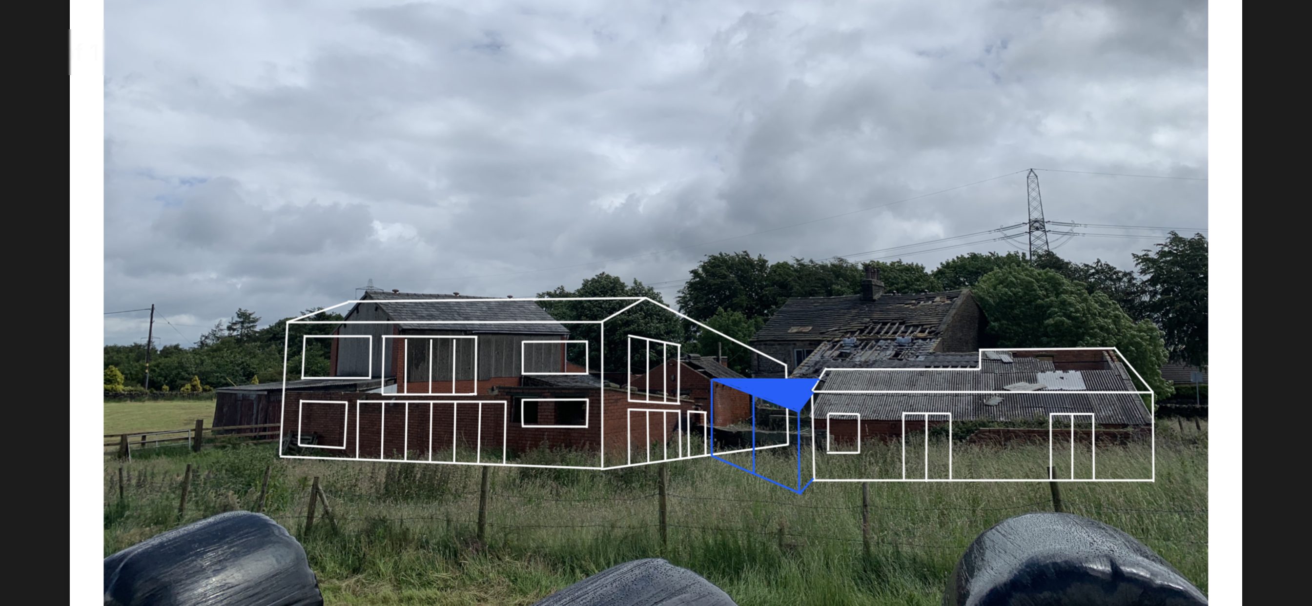

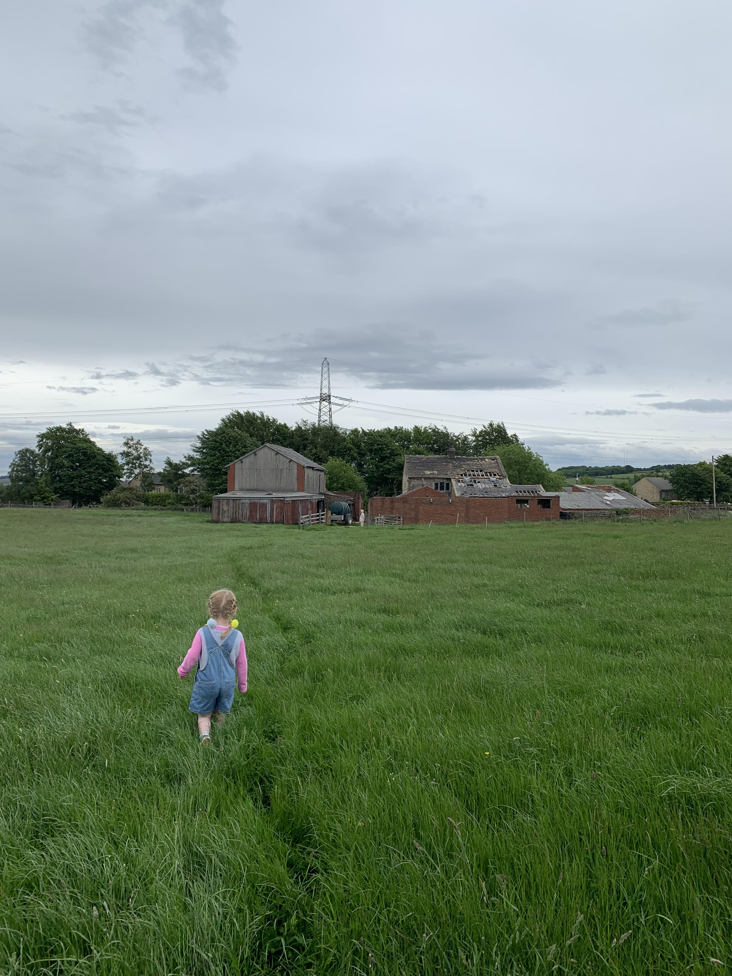

8 minutes ago, Tonymac01 said:
Yes ???
Seems like a nice plot you have found there.

I take it from your photo that you are a younger self builder?
Special ‘helper’ ?
