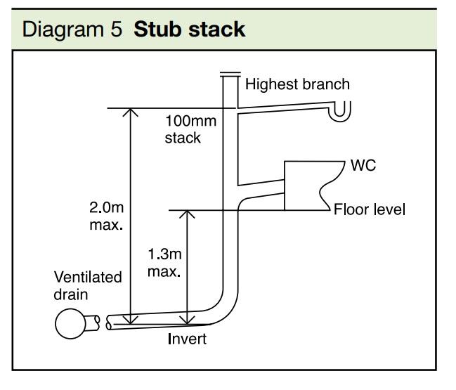

Moonshine Posted November 22, 2019 Posted November 22, 2019 I am thinking about the practicalities of getting foul drainage from a new plot on my land to the existing foul drain of the existing house, a distance of about 25-30m. This would go under the existing houses lands new drive, so in effect it will become a sewer. For this i want to know if the invert levels can be accommodated under the topo accounting to level changes and the invert level of the existing drain it would feed into. The reason for this is that it would save a lot of cost and hassle connecting to the sewer under the road as its a busy road. I want to understand/confirm; Is the best/only design resource needed Approved document H. The vertical distance below the FFL of the house that the foul drain can start moving to the side from the stack location (ADH has this at 1.3m in some situations). The minimum internal diameter of the pipe (75mm?) required. The minimum fall of pipe (ADH seems to have this at 1:80 / 12.5cm every 1m) required. minimum depth of pipe under ground level (ADH seems to 150mm from the crown of the pipe) Man hole covers at every junction point rodding access points? Cheers

Moonshine Posted November 22, 2019 Author Posted November 22, 2019 On 22/11/2019 at 13:58, Mr Punter said: The vertical distance below the FFL of the house that the foul drain can start moving to the side from the stack location (ADH has this at 1.3m in some situations). No comprende Expand fair enough, i probably didn't explain it correctly, see the figure below, this is the maximum value invert level, is there a minimum value?

Mr Punter Posted November 22, 2019 Posted November 22, 2019 On 22/11/2019 at 14:16, Moonshine said: fair enough, i probably didn't explain it correctly, see the figure below, this is the maximum value invert level, is there a minimum value? Expand No minimum. It is normally the long radius bend at the base of the stack and your floor makeup that will decide.
Moonshine Posted November 22, 2019 Author Posted November 22, 2019 On 22/11/2019 at 15:03, Mr Punter said: No minimum. It is normally the long radius bend at the base of the stack and your floor makeup that will decide. Expand Thanks, iirc its a 200mm radius bend (ADH)
