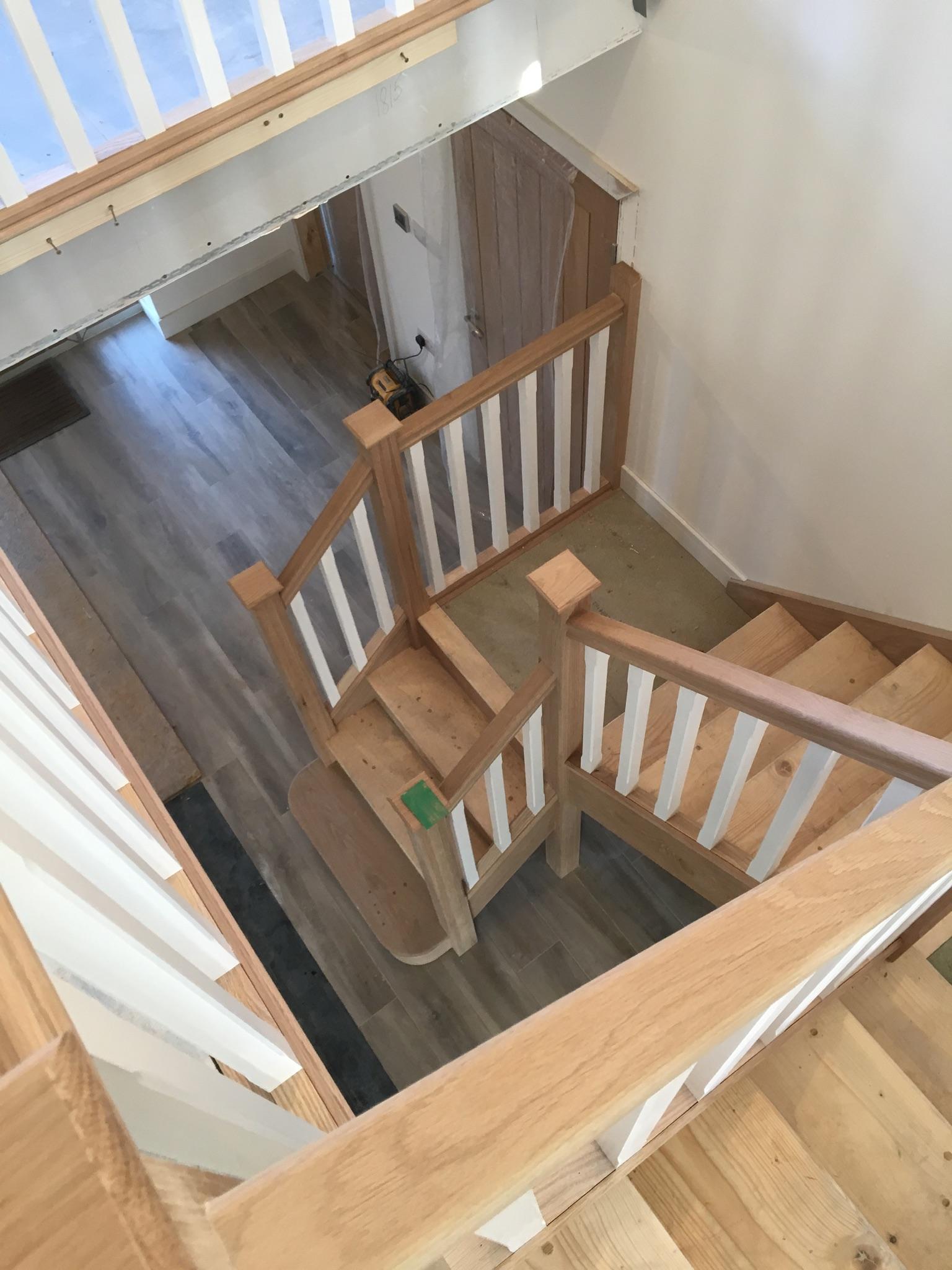

2 hours ago, Oz07 said:
Have always just put onto screed on any job I've fitted some on. Obviously I've not specced these just fitting what's infront of me. On mine I usually sit ontop of agilia as min 75mm thick. Chucked a sheet of mesh in last place as had a structural newel taking small floor load. Architect wanted newel taking through screed insulation down to floor beams. Sounded a nightmare to me and recipe for trouble maybe rotten newel?
150 insulation
UFH pipes
75 mil screed
18 mil Porcelain
Oak stairs straight on top
