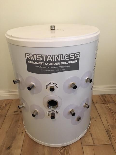

Pictured below is my buffer tank as acquired from Ebay a year or so ago. This is a 90ltr RM Cylinders Stelflow stainless unvented cylinder. It will be connected as follows :-
- To/from an ASHP to provide water heating
- To/from an underfloor heating manifold
- To/From a Dimplex SmartRad wet radiator
It will also be electrically heated using an immersion heater to around 30C for situations when the ASHP is non-functional.
I bought the tank "as is" with no additional parts (Pressure valves, expansion tank etc.). The system will be self contained filled with water/inhibitor at a pressure of a couple of bar.
Does such a system need to be considered as a full scale UVC install complete with pressure relief valves, tundish, part-G etc ? (The cylinder does not have a pressure relief valve fiting). I would guess the inclusion of a heating element would make this desirable if not compulsory.
I am assuming that a sensible connection strategy would be to use the bottom "cold feed" input as the fill point, the top connection for the expansion tank, with the to/from feeds connected to the mid-point connections. Does this make sense or should I be taking all hot water feeds from the very top ?
Does having separate thermostat and heater elements give any advantage ? or should I just use a single combined unit ?
All thoughts more than welcome.

Before I advise on the connections, does the cylinder have any coils or is it all one unified body of water. ?
Edited by Nickfromwales

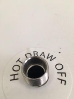

Thanks for the reply Nick - No coils at all, one body of water with a cold-in on the bottom right, hot out at the top and 8 flow/return ports. The thermostat points are sealed pockets. The immersion boss seems to be a standard 2 1/4".
4 minutes ago, Nickfromwales said:
Hot and cold in/ out ? I'm a bit stuck with that, is that a coil? Otherwise how is it defined? Each tapping should be installer definable.
I'm just quoting from the attached labels - there is no difference apart from threads on the tappings. There is definitely no coil.
So if you blow into that does air come out of all the tappings?
Stick your hand over the cold tapping and blow into the hot. If there's back pressure you know there is a coil.
i genuinely don't know why they'd define those two tappings other than  if they are a coil in / out.
There is no back pressure - Just to be certain I shone a torch through the immersion boss and peered into each of the tappings. Light was visible from each so it is just one body of water and definitely no coils. The labels must just be there to add FUD.
Some of the buffers I sell have stratification devices inside (a steel column with lots of holes in it) - so even though it is the same body of water, there are dedicated points for flow and returns that should be used
