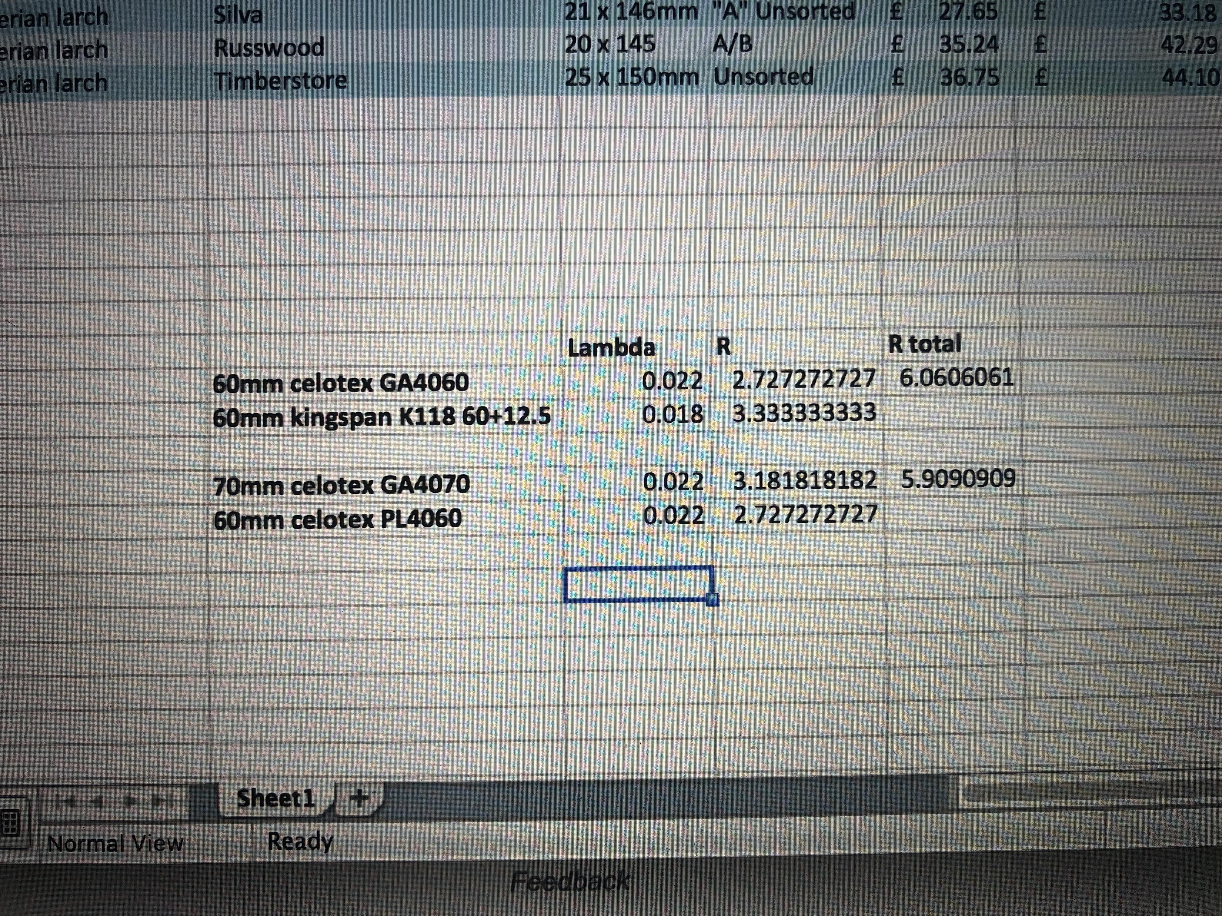

Roz Posted November 4, 2019 Posted November 4, 2019 Can some smart person answer this? Plan submitted to building regs for roof make up 60mm celotex ga4060 (lambda 0.022) between rafters plus 72.5mm insulated koolther K18 plasterboard (60mm insulation Lambda 0.018) is it thermally close to 70mm celotex (lambda 0.022) Between rafters plus 72.5mm Celotex insulated plasterboard PL4060 (60mm insulation lambda 0.022) I don’t know if I have done it right but when I work it out I get a difference of 0.07 in the R value... how relevant is that? The celotex insulated plasterboard is a lot cheaper than the kooltherm and yes we have limited head room hence these thickness values, for a barn conversion
A_L Posted November 4, 2019 Posted November 4, 2019 2 hours ago, Roz said: I don’t know if I have done it right but when I work it out I get a difference of 0.07 in the R value... how relevant is that? The difference is insignificant. However there is a more serious consideration. Whenever insulation is between rafters allowance must be made for the thermal bridging effect of the timber which is significant. Normally the timber is assumed to be 15% by area and the layers in which the celotex 70/60mm are used between rafters have thermal resistances of 1.832/1.570 respectively.
PeterW Posted November 4, 2019 Posted November 4, 2019 How deep are the rafters ..?? That seems to indicate you only have 70-100mm Rafter depth for insulation .??
Roz Posted November 4, 2019 Author Posted November 4, 2019 59 minutes ago, A_L said: The difference is insignificant. However there is a more serious consideration. Whenever insulation is between rafters allowance must be made for the thermal bridging effect of the timber which is significant. Normally the timber is assumed to be 15% by area and the layers in which the celotex 70/60mm are used between rafters have thermal resistances of 1.832/1.570 respectively. 20 minutes ago, PeterW said: How deep are the rafters ..?? That seems to indicate you only have 70-100mm Rafter depth for insulation .?? the rafters are 120mm (ish, whatever the closest size is to that) at 400centres. BCO requested 50mm Of ventilation space above the insulation
