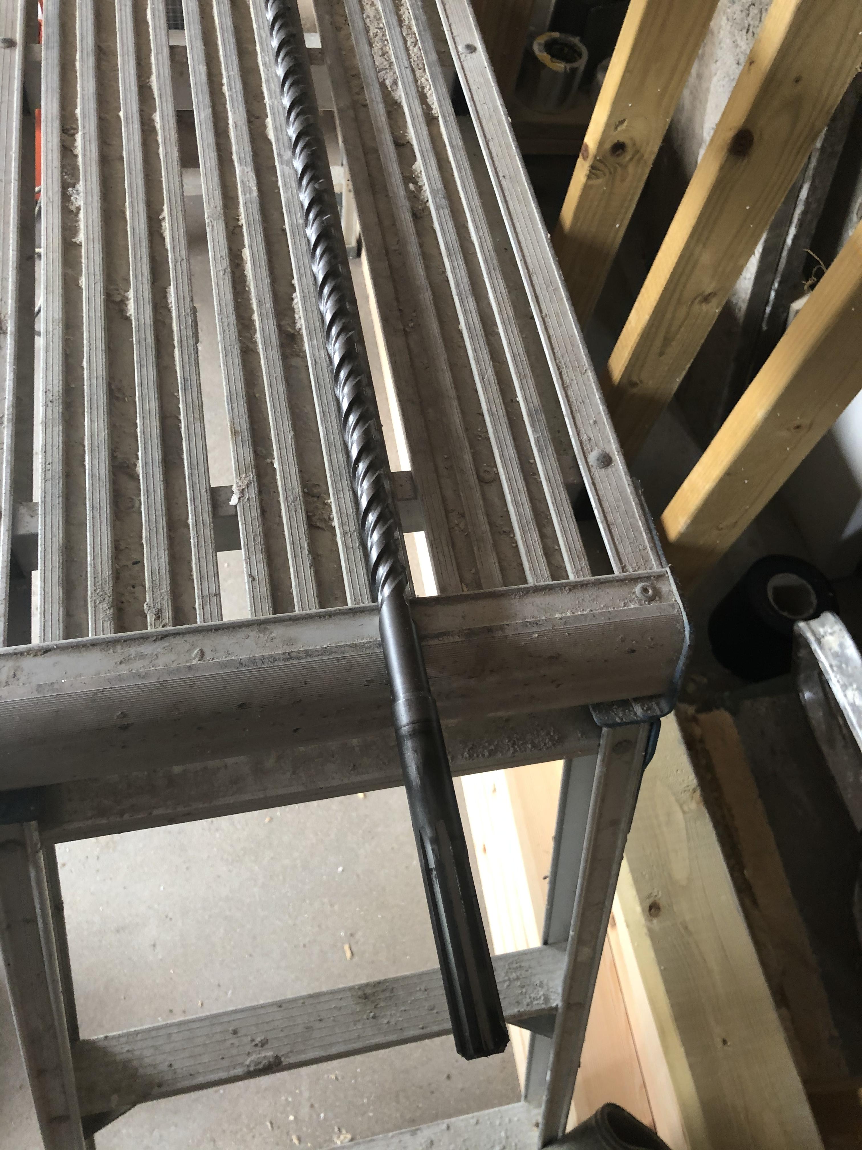

Pocster Posted October 23, 2019 Posted October 23, 2019 Not sure this exists But I’ve got this nice 18mm 800mm drill bit - but the sds fitting is to large for any of my drills ( apart from my Hilti but that’s just a breaker ) . Is there some converter that I can use so it fits a conventional hammer drill ??
SiBee Posted October 23, 2019 Posted October 23, 2019 If the dia of the shank is 18mm then its an SDS max. SDS and SDS plus use a 10mm dia and they are not compatible. You can buy adapters for the opposite way to what you want. You could cut the SDS part off and have some one machine the diameter to fit a normal chuck but then there is no going back. 1
Pocster Posted October 23, 2019 Author Posted October 23, 2019 46 minutes ago, SiBee said: If the dia of the shank is 18mm then its an SDS max. SDS and SDS plus use a 10mm dia and they are not compatible. You can buy adapters for the opposite way to what you want. You could cut the SDS part off and have some one machine the diameter to fit a normal chuck but then there is no going back. Erm ! So no sds max to sds converter ? ?
Pocster Posted October 23, 2019 Author Posted October 23, 2019 They do exist ! https://www.diy.com/departments/erbauer-sds-max-to-sds-plus-chuck-adapter/1738247_BQ.prd
PeterW Posted October 23, 2019 Posted October 23, 2019 No - that’s the wrong way ... it’s Plus to Max 1
Pocster Posted October 23, 2019 Author Posted October 23, 2019 1 hour ago, PeterW said: No - that’s the wrong way ... it’s Plus to Max BUM!
