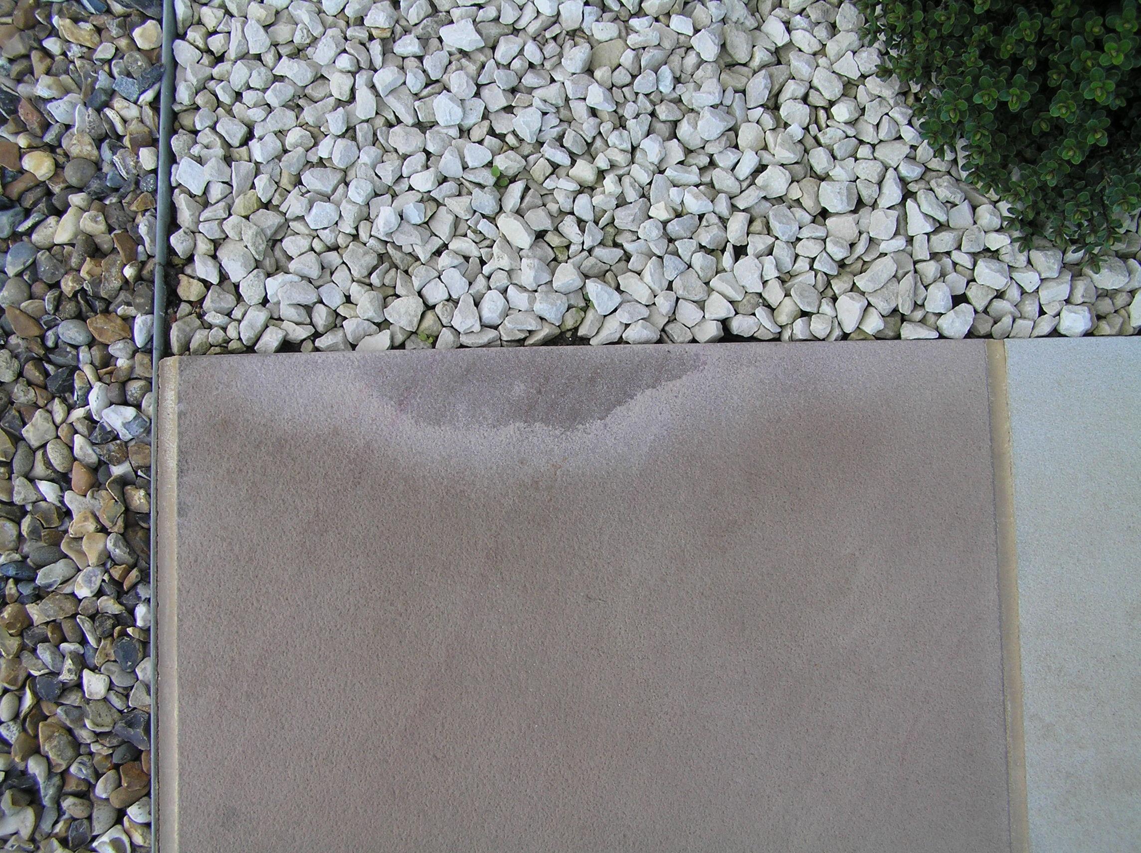

Gone West Posted October 19, 2019 Share Posted October 19, 2019 I had a small piece of horsetail growing up next to the sandstone path leading to the house. I put a small amount of salt (NaCl) on it to kill it, as I often do for horsetail growing on its own. Unfortunately I didn’t know how damaging salt can be to sandstone until I searched the internet. The effects of de-icing on sandstone buildings in some Scottish cities is well documented. It’s a pity I hadn’t heard about it and this is the result. Needless to say I won’t be de-icing my paving with salt this winter. 1 Link to comment Share on other sites More sharing options...
Cpd Posted October 19, 2019 Share Posted October 19, 2019 Everyday is a school day. As a stone mason in Australia I had to repair quite a lot of sandstone stonework that had been re pointed with cement as it causes terrible damage. Link to comment Share on other sites More sharing options...
scottishjohn Posted October 19, 2019 Share Posted October 19, 2019 (edited) I take it that will be why there are no sandstone cliffs next to the sea? Edited October 19, 2019 by scottishjohn Link to comment Share on other sites More sharing options...
