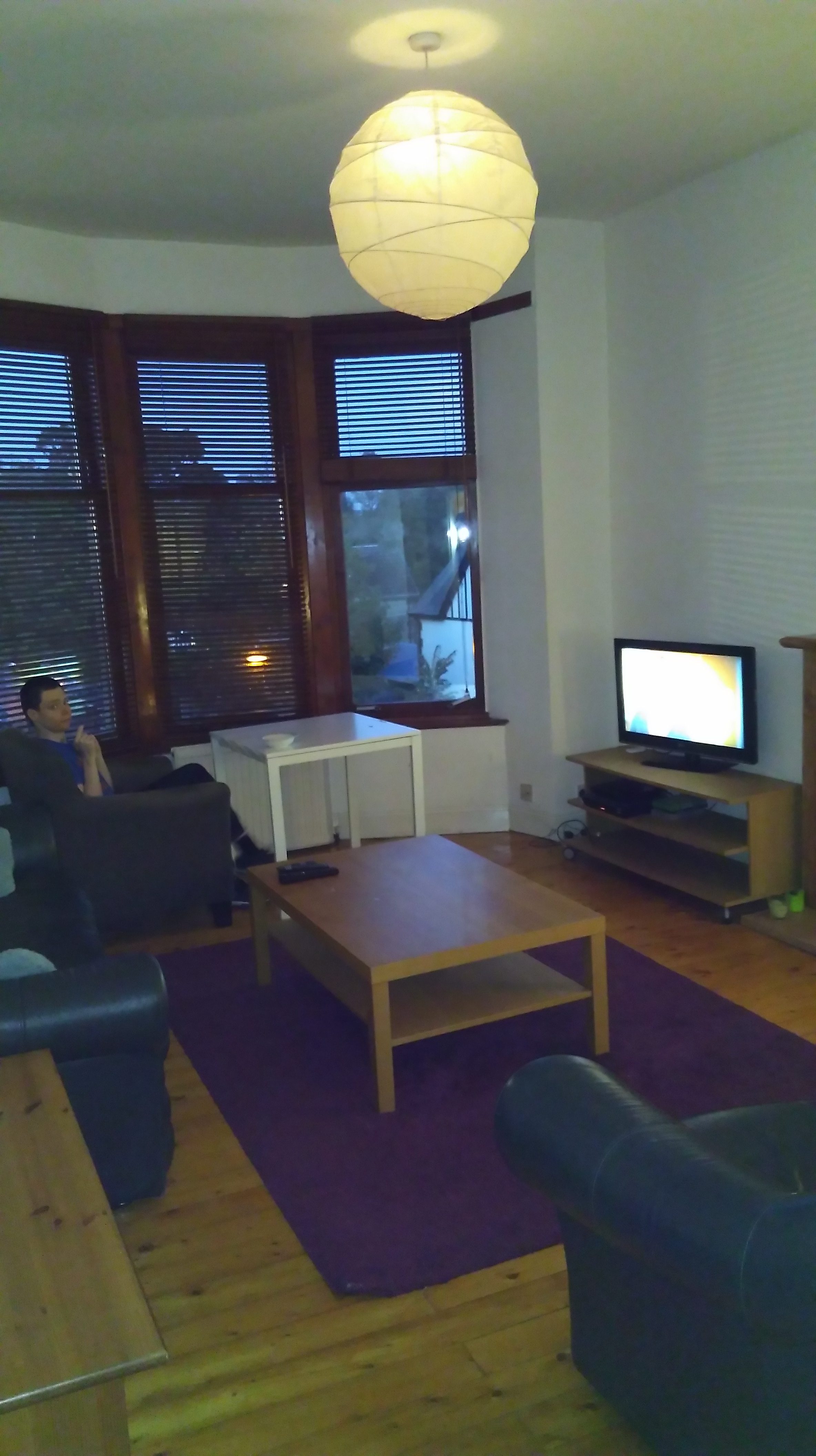

Tennentslager Posted October 15, 2016 Share Posted October 15, 2016 Must admit I was so confused by this height stuff I decided to measure the walls in the flat I'm in at the moment. 3060mm. It's one thing I love about Glasgow tenements. This one is about 100 years old and walls are 600mm thick. I reckon the height was to accommodate the tall windows to get maximum light in Link to comment Share on other sites More sharing options...
