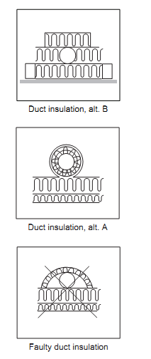

I have the option keeping MVHR ducts above or below loft space.Trying to decide based on practicalities and headroom. How much insulation do these ducts need over/around them? There will be plenty in the loft so will be well covered but would this be enough? It would be more straightforward to keep them in a small suspended ceiling space below this but I don't want to create a particularly low ceiling and I reckon these will need minimum 150mm void to form a 90 bend?
I would not compromise my ceiling height if you have spare loft space, loft insulation is cheap, 200mm laid on top (if insulation exists below them) IMO would be more than adequate. Mine is installed in a warm loft (so no insulation required, apart from incoming from outside to the unit) and it was soooo much easier to instal in an open space.

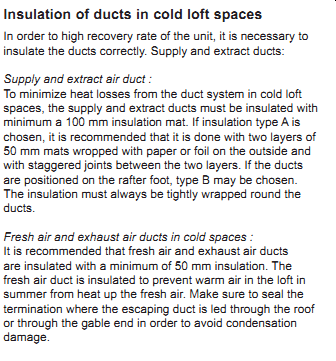

Would I be right in thinking the ducts to rooms would be 'fresh air and exhaust air' in the note above? The insulation doesn't seem so critical in these so perhaps in the loft with the loft wool layered around seems viable. The main ducts will obviously have a more detailed insulation but these will be relatively short runs.
In that Genvex note, fresh air and exhaust are the external ducts that run to the terminals outside the house.
Supply and extract are the ducts inside the house leading to the various rooms.

Doesn't help in the OP's case, but this is another reason why we went for a warm roof as it avoided the need for the MVHR ducting to be insulated (except where the inlet and exhaust enter/leave the building).
You sure @JSHarris that cutout. Everytime I read it I get a different meaning for those ducts!

Yes, as the insulation needed on the externally connected ducts is less than that needed on the internal ducts, when the thing is fitted in a cold loft.
