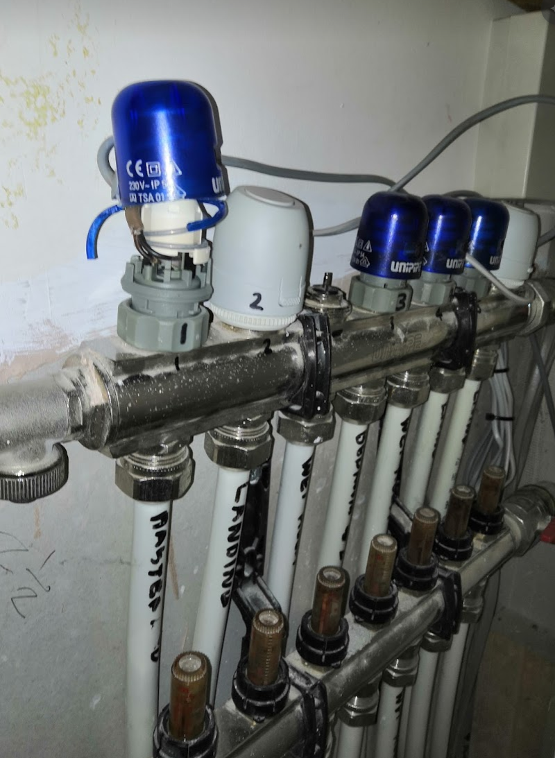

I investigated why the UFH is always on in the bedroom and think I found the answer:
Looks like over time some others may have failed as you can see a mix of blue and beige heads. The wiring box behind them says 240V so I was wondering how achievable it would be to replace this myself. I saw the same type of head here Myson . If I isolate the electricity and both mainfolds ( you can see the isolator at the end), how easy would it be to replace the broken unit? I'm happy with basic wiring and if I need to soldering + have main test kit if needed for diagnosis
cheers
Yes definitely DIY job as long as you turn the power off.  Just connect the new actuator into exactly the same 2 terminals that the old one was connected to.
I used these ones https://www.ebay.co.uk/itm/Underfloor-heating-manifold-actuator-230v-UK-seller-Normally-Closed/263920710929?hash=item3d72e67511:g:NpoAAOSworhbvg0O
I chose them because the mounting screw is metal.  I have had problems before with some where you screw a plastic bit on and then the head clips onto it.
Great thanks, good to know. Where it says "normally closed" this is the default way of working - so nothing to check here before buying?
Great, look forward to my next plumbing experiment when that arrives ?
I’d be looking to upgrade them to the self balancing ones.
They are are an extra £5 and basically will sort the flow and temperature in one go.
Well worth the extra.

Cheers that actuator seems good - much more robust than the one it replaced. It even seems to work ? Well the heating is off so that is at least better!
