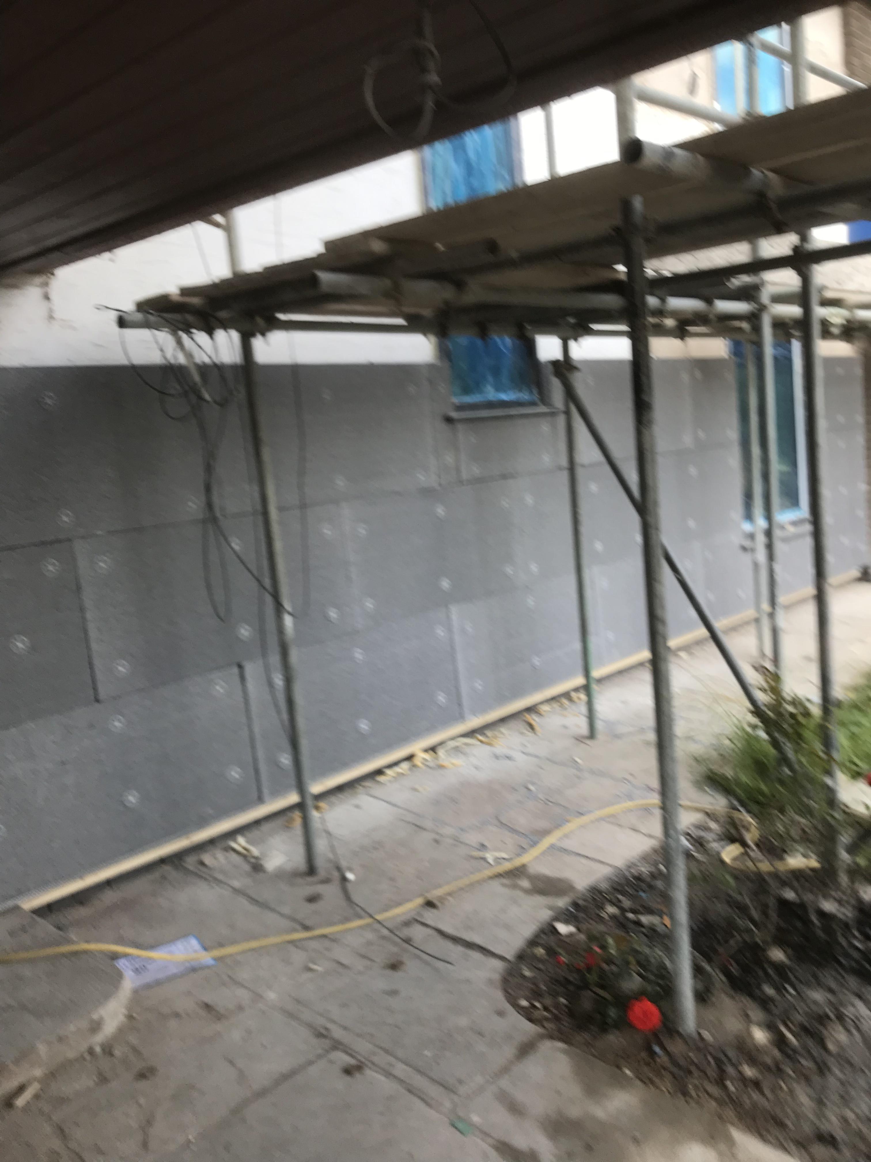

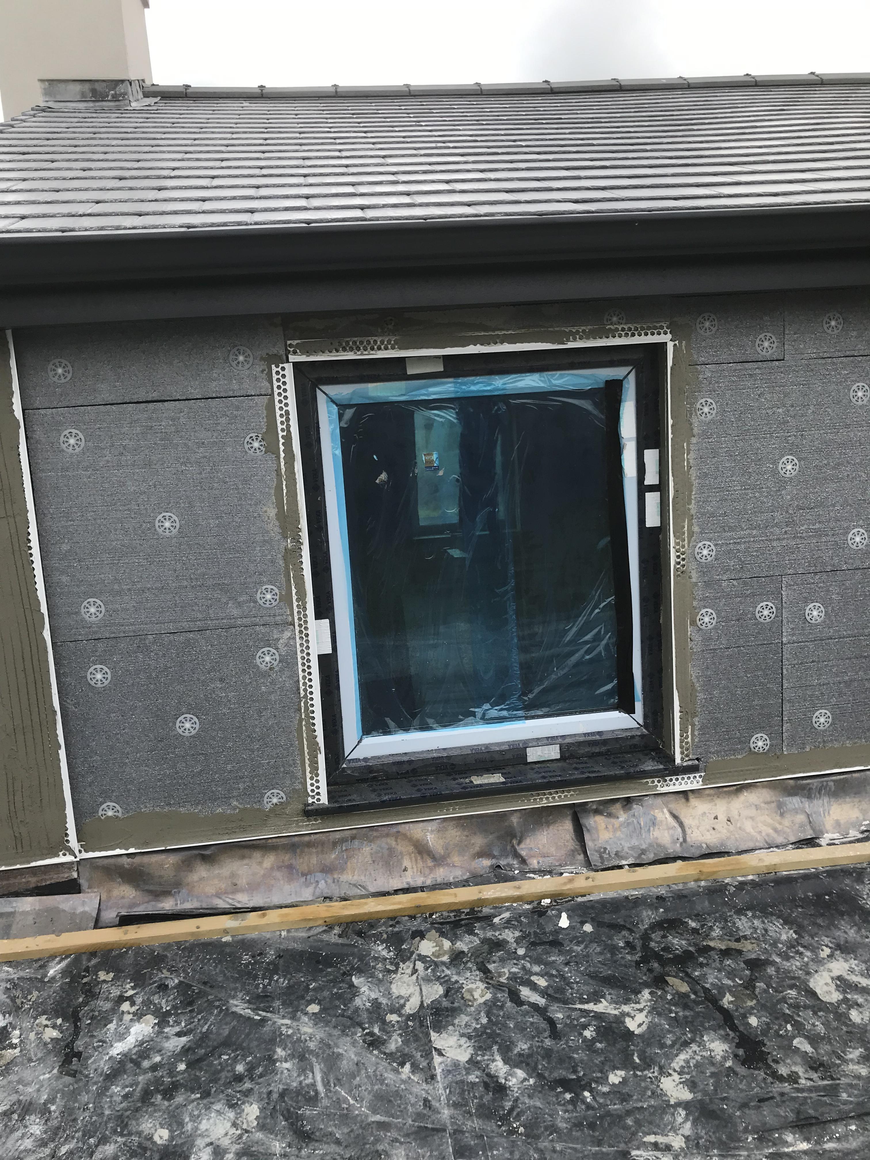

You can compensate with EWI
We have just finished a conversion with the same issue
A pic may help
