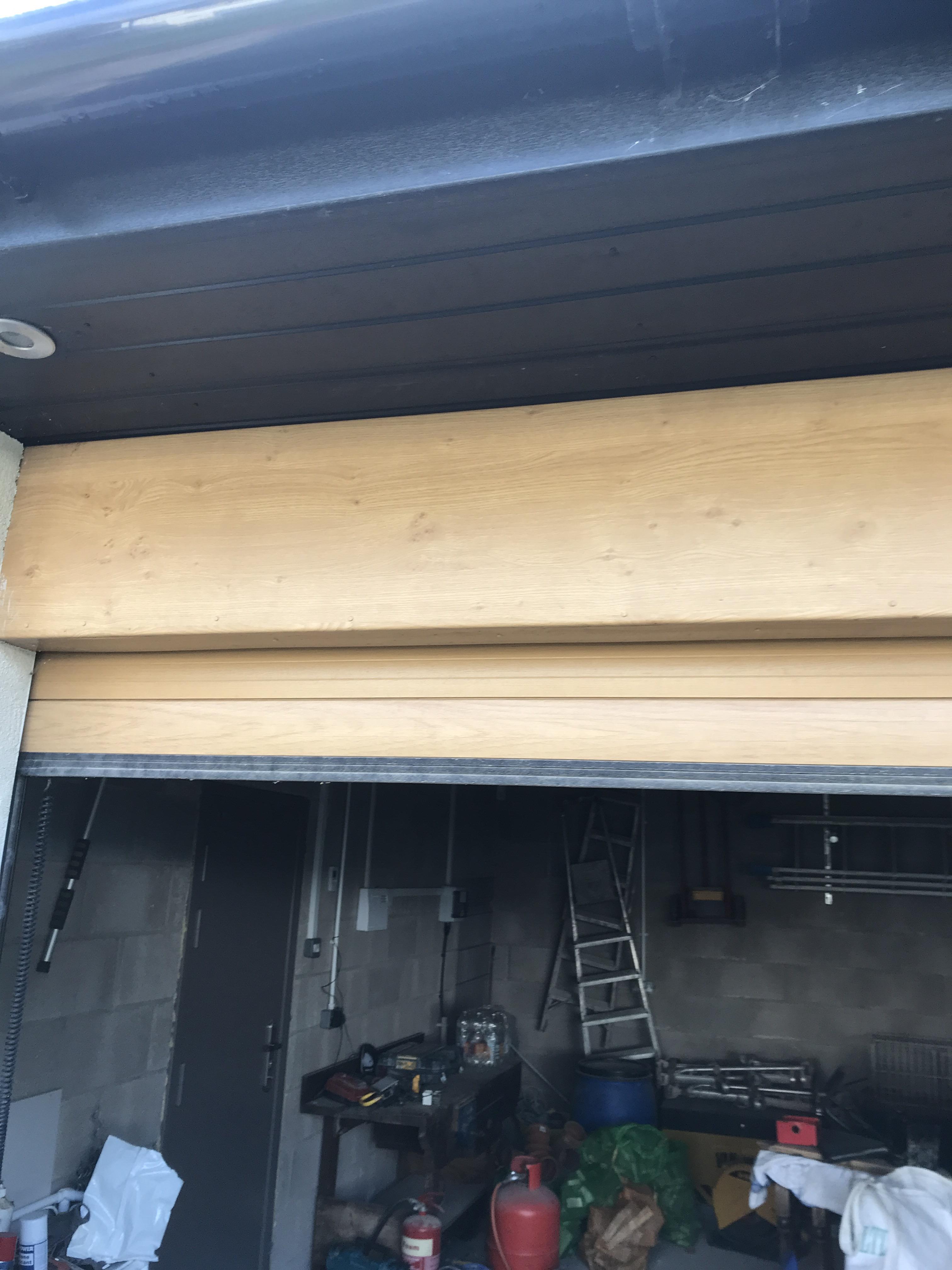

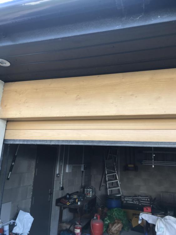

I put the wall plate directly on top of the steel and simply boxed it when I fitted the door

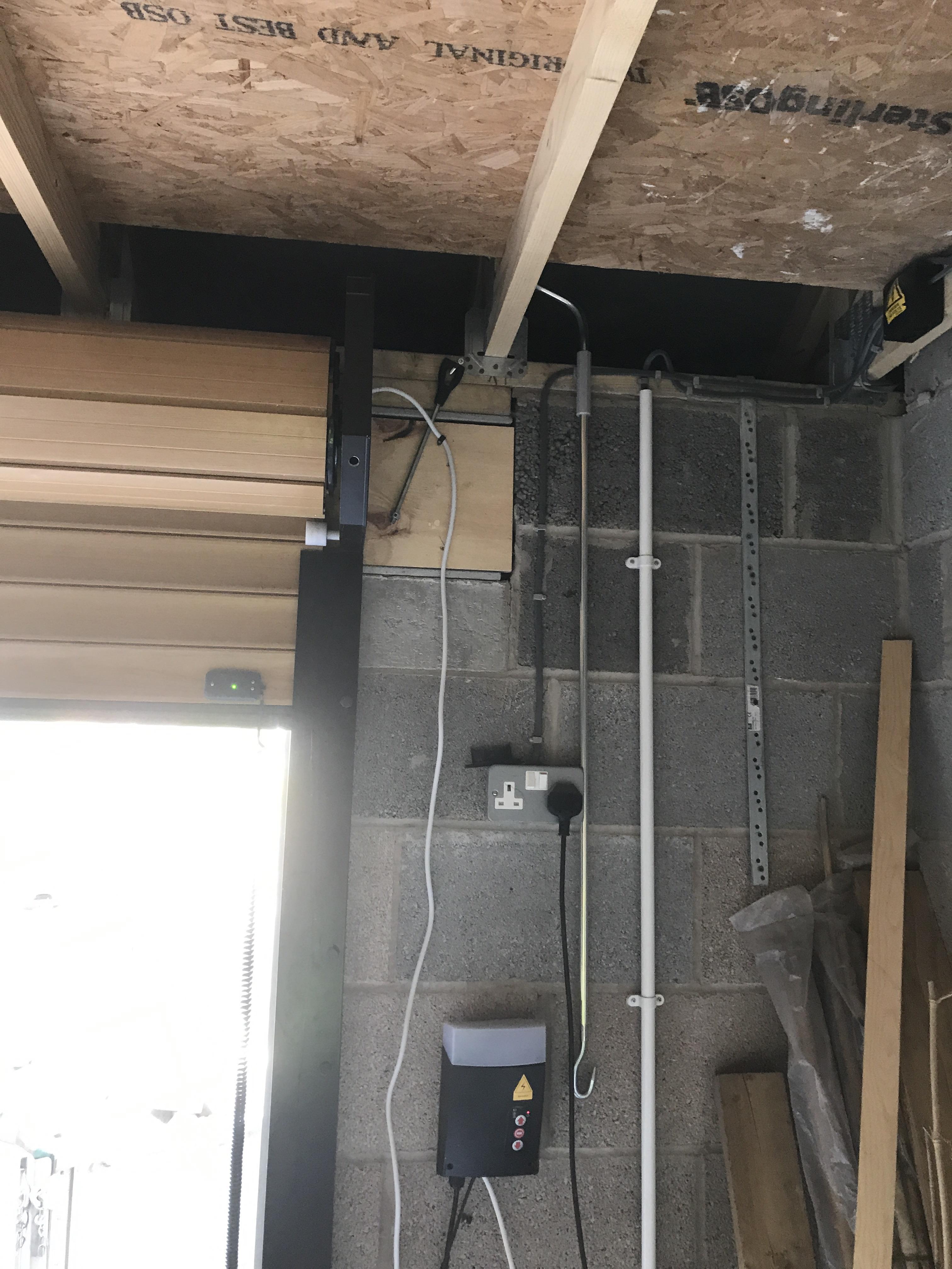

Thanks, useful photo detail there. It looks as though your Lintel is an I beam steel and it was about 50mm below the full bedded 4" x 2" timber wall plate. I could raise the lintel seat height to do something similar but need to ensure I leave enough headroom for a Horman sectional door motor to hang from the roof joists.

Yes I used a steel on both garages
Simply because I had two over from demolition

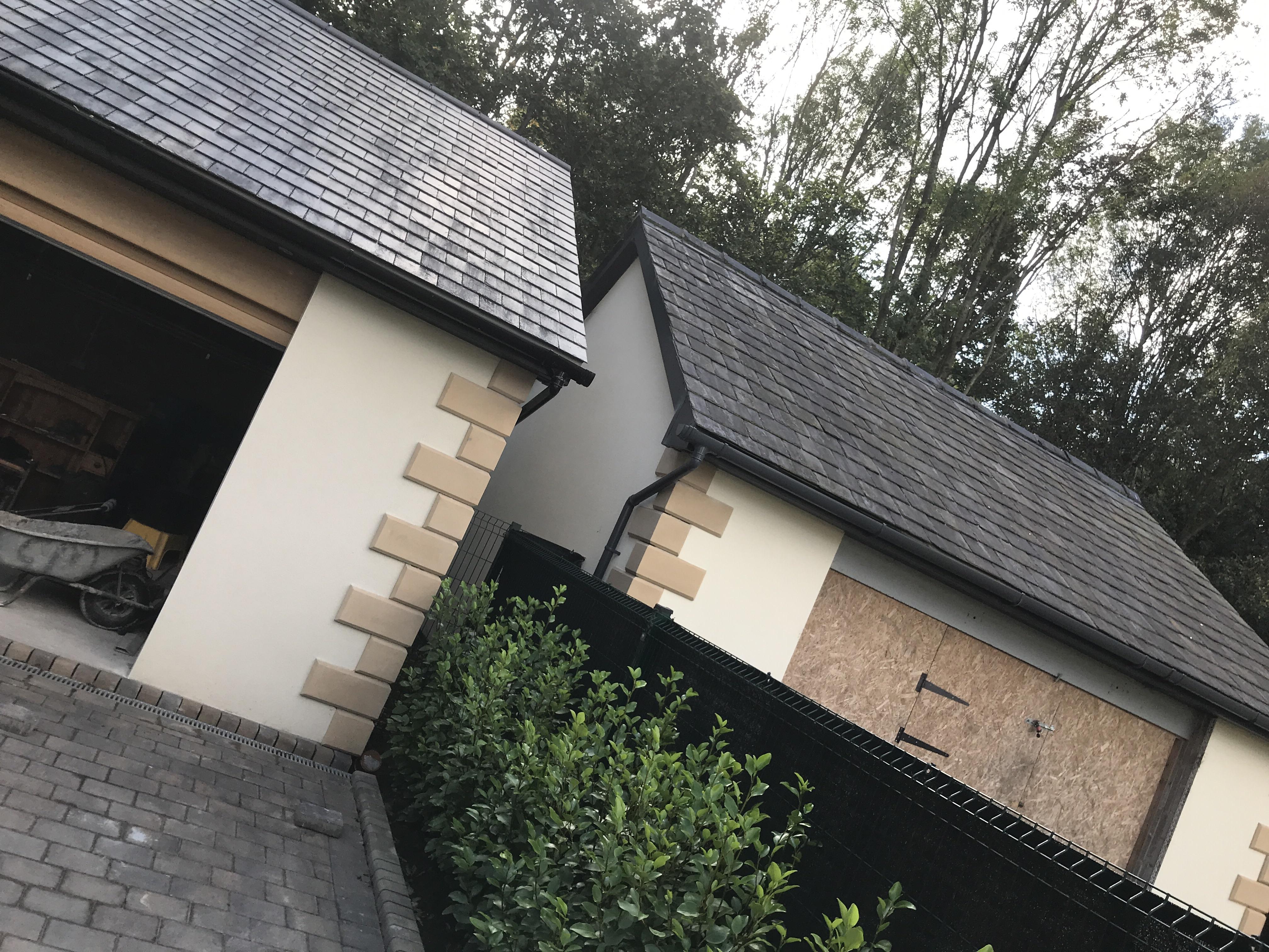

pictured is tge neighbours garage we built at the same time
They never got around to putting a door on
