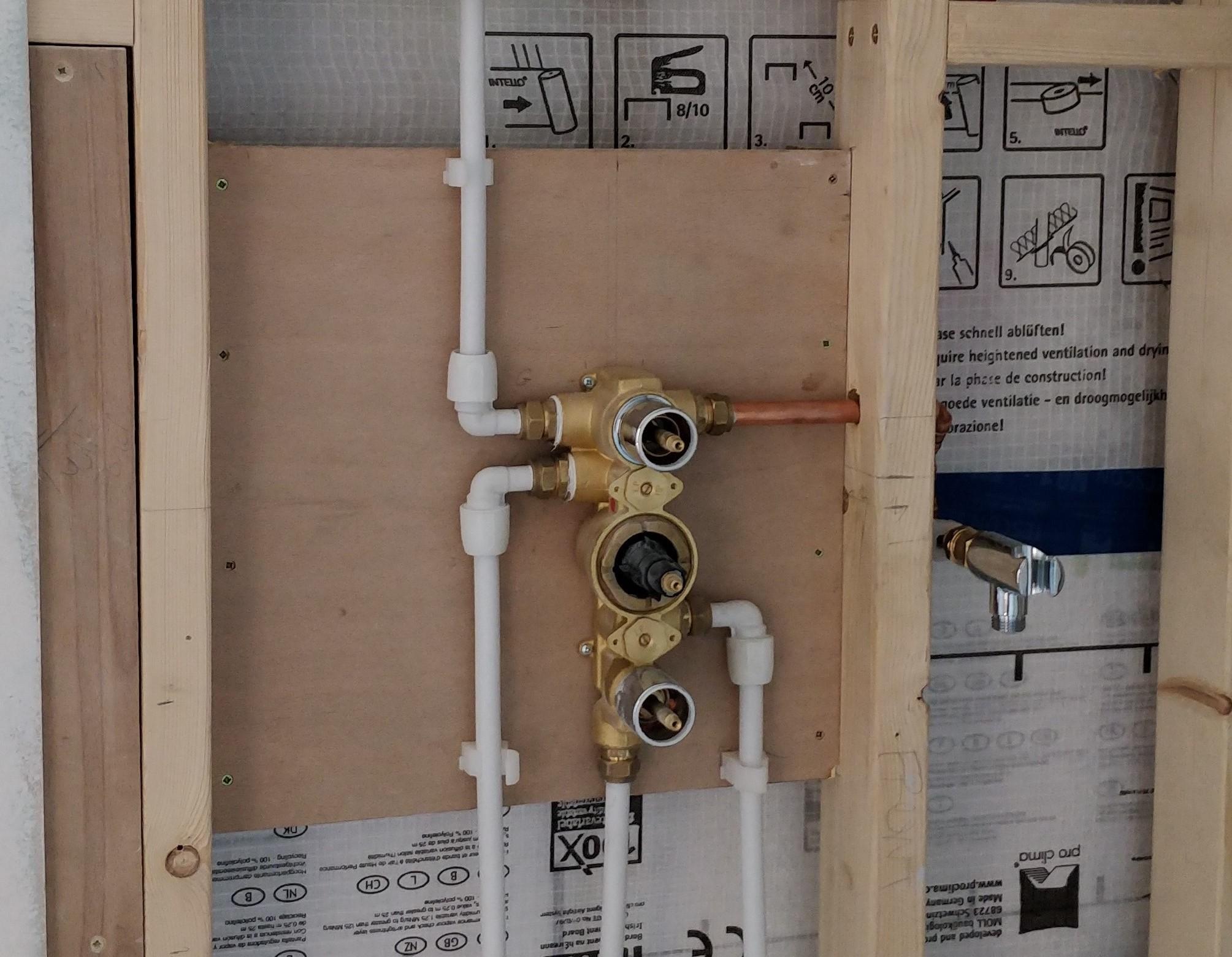

AdamSee Posted September 4, 2019 Posted September 4, 2019 I found this issue to when doing my shower valve. So i used 15mm to 3/4 male brass compression fittings which I attached to 15mm hep2o spigot elbows. Make sure you use copper olives when attaching to the spigots and a bit of ptfe tape as shown in the hep2o manual.
PeterW Posted September 4, 2019 Posted September 4, 2019 I’d do that slightly different and use a brass male/male 3/4 hex nipple then use the Hep2O female fitting. They are pennies to buy.
AdamSee Posted September 4, 2019 Posted September 4, 2019 On 04/09/2019 at 12:08, PeterW said: I’d do that slightly different and use a brass male/male 3/4 hex nipple then use the Hep2O female fitting. They are pennies to buy. Expand Looking back at it....that would have been a good alternative....But i liked the possible option of doing it all in copper pipe. I don't understand why they still use 3/4" fittings on the valves. Im pretty sure the plumbers rule of thumb is "never use a compression somewhere you cant access it" and here it is with 6 in the wall. Although I've seen that Aqulisa now do entire valves and shower connectors that accept 15mm plastic straight in. No brass wear at all.
PeterW Posted September 4, 2019 Posted September 4, 2019 3/4” is a throwback to the old rule about supplying showers with 22mm to make sure they have high flow.
