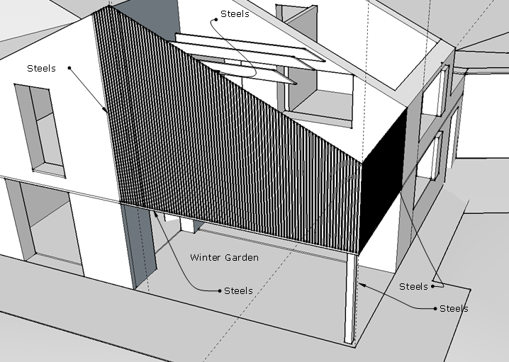

Our design shows  louvres that surround the Winter Garden.
The louvres are the dark area. The nearest face has about 46 louvres (spaced 75mm apart)

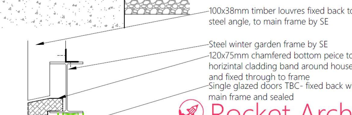

The current design shows  that they should be attached like this ;
... put differently - the architect is proposing to secure an (on average) 3 meter long piece of timber top and bottom by welding a bit of angle iron ontop of (and underneath) the top and bottom beams , and then a screw (or bolt) through that to the bit of 100 by 38. (Siberian Larch - see image above)
Naaaah. Not good enough. Das geht nicht! It gets  windy here.

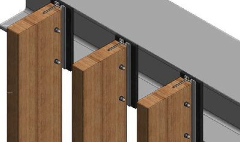

So, after hours of Tinternet roaming, I bumped into Australian Government advice on attaching vertical louvres.
Thats better methinks. Except the wood is only 38mm thick.

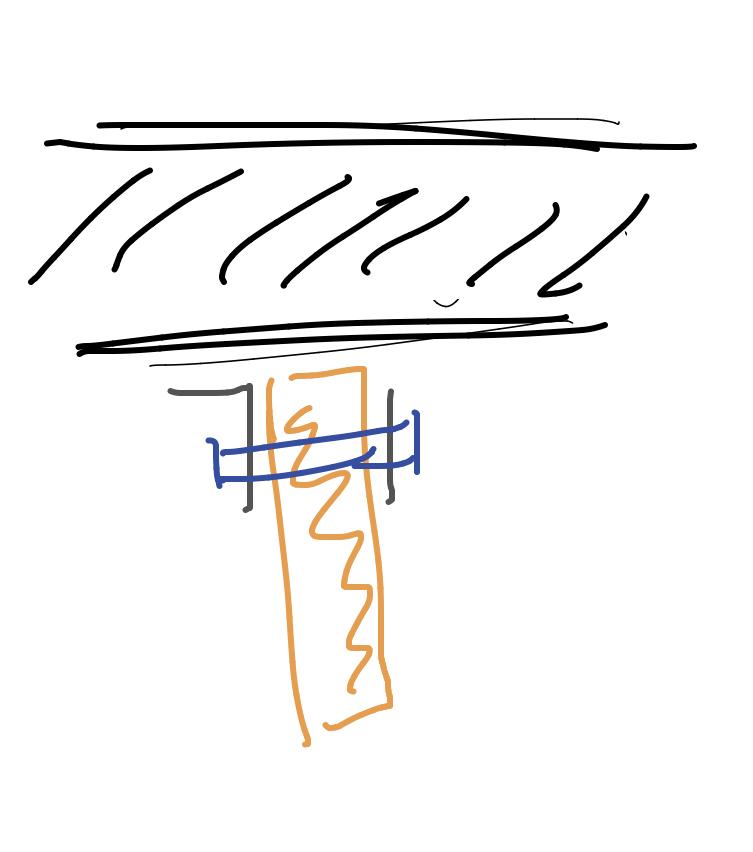

So how about fastening the wood top and bottom by inserting it in a bit of channel with an internal channel 39mm wide? (And welding that channel to the beam)
I will, of course, be reducing lateral movement in the verticals by attaching 2 meter lengths of 4 by 4  across the louvres - cross halving joints perhaps. I think it would be a good idea to stagger those cross members too.
Your thoughts would be welcome.
Posted (edited)
I’d be using “pairs” of 50mm angle welded to the beams and then bolted to the fins. Finding a decent U Channel of the right size and then drilling it etc sounds hard work - getting 80 or so “standard” brackets made that are 250 x 50 x 50 with a 10mm hole 75mm from each end on one flange just sounds soooo much easier...!!
Could even get away with an angle one side and a 50x250x3mm bar/plate the other side to make a sandwich that would allow for different timber thickness / tolerance ..??
