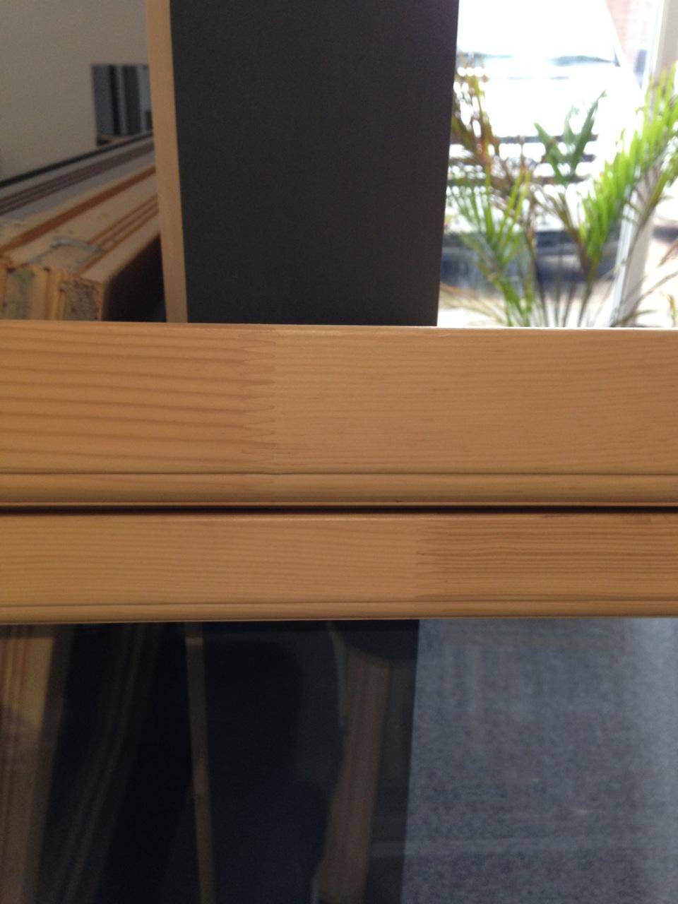

iSelfBuild Posted August 22, 2019 Share Posted August 22, 2019 Nothing wrong with using laminated timber for windows. It's what I supply as standard. They do not twist or warp the same and are much more stable. Just be aware the scantlings are made from very fine finger jointed timber. Some people find the finger jointing offensive so specify no visible finger joints if you don't like it. Photo attached. 1 Link to comment Share on other sites More sharing options...
