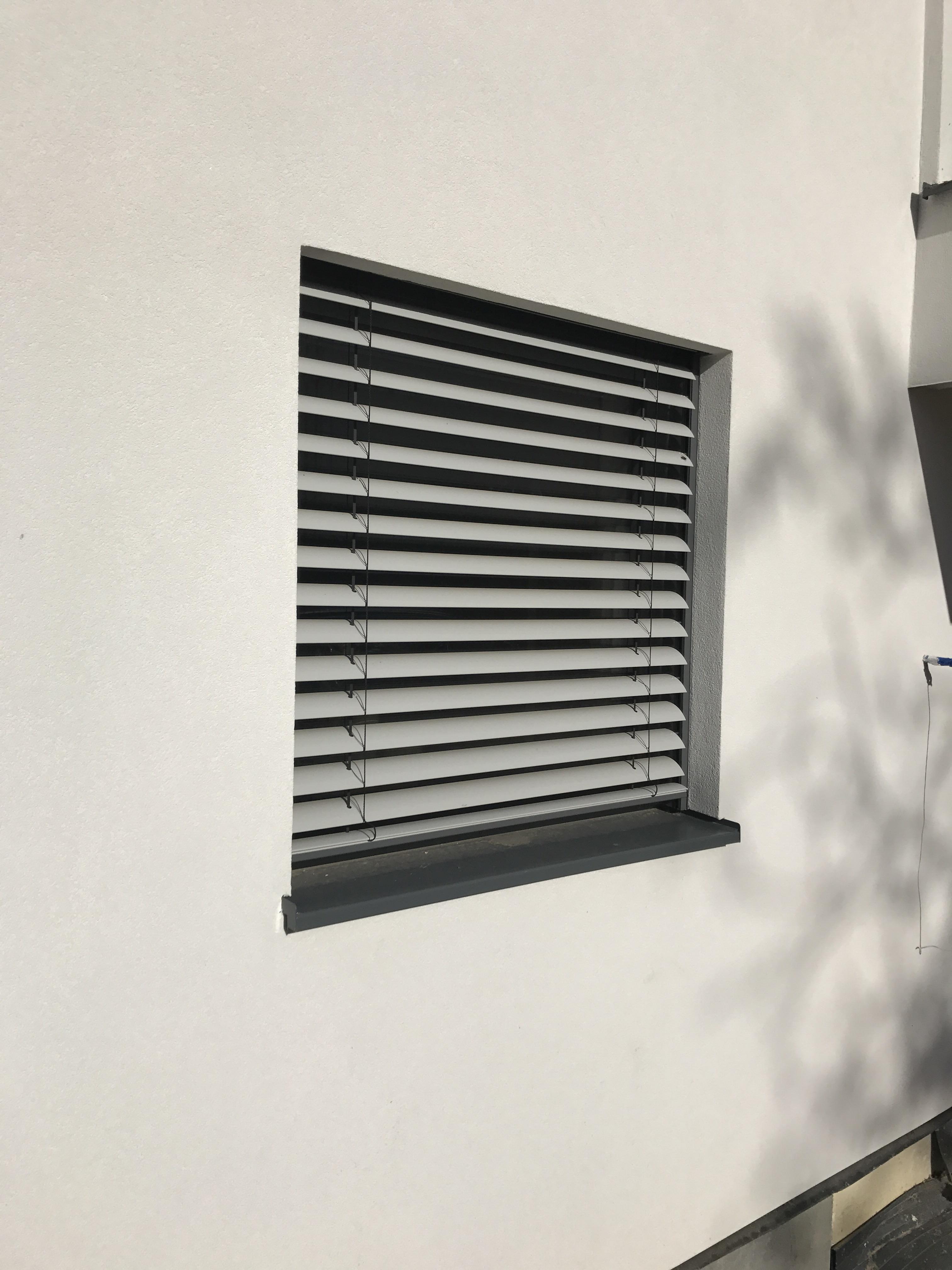

Bitpipe Posted September 29, 2016 Posted September 29, 2016 Internal or external? We have external blinds fitted to our windows and they were VAT exempt (supply and fit). It's worth asking your vendor to zero rate them and then you don't have worry. If you buy them then you'd have to take your chances in the VAT refund.

Frogeye Posted September 29, 2016 Posted September 29, 2016 Have you any pictures of your external blinds Bitpipe?
Bitpipe Posted September 30, 2016 Posted September 30, 2016 2 minutes ago, gravelld said: Why are external blinds VAT exempt??? They're part of the fabric of the house, can't be removed easily. This is the one of the basic principals as I understand it, which is why carpets are not exempt but wooden floors are, built in kitchen appliances are not exempt but built in extractors are etc... It's not always logical but there's a fairly comprehensive list in the self build VAT notes. In my case, the blinds were part of the window package (they were fixed to the windows in the factory) so were zero rated at source. 1
