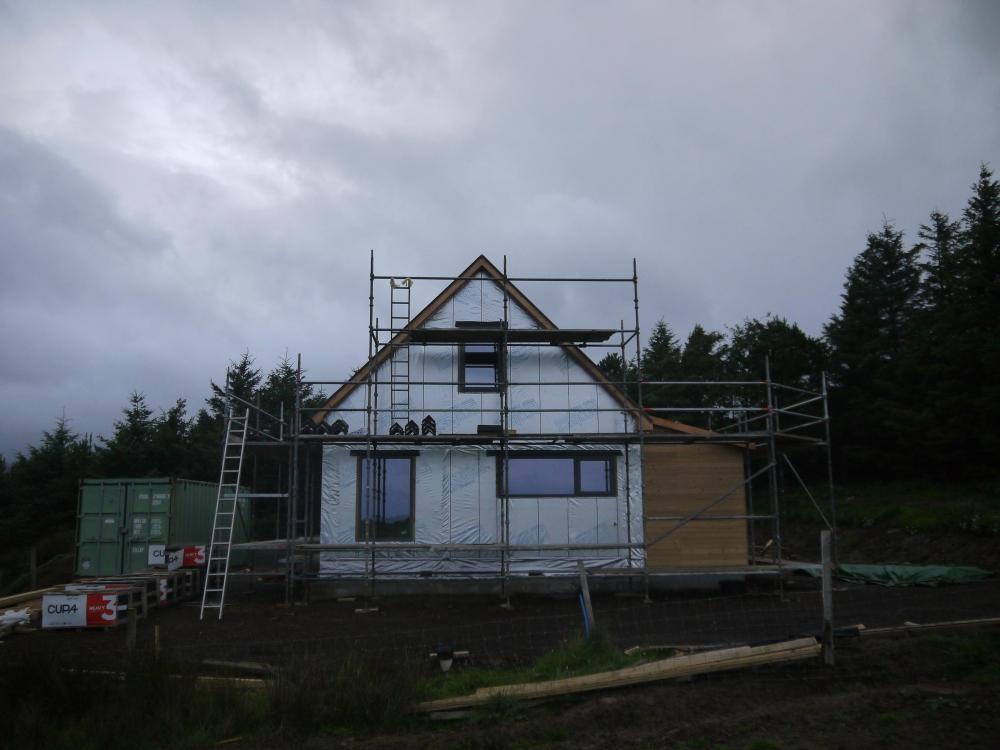

Thedreamer Posted July 31, 2019 Posted July 31, 2019 Pretty much the same circumstances as us in August 18. Although we attached the dry verge before the slating commenced and had also constructed the barge boards and soffits. I couldn't decide what to fit. From my research I came to conclusion that if you fit thick slates (we fitted cupa heavies) then it could distort the dry verge fitting. In the end we went for one that was designed for slates and battens and this gave us enough room to get the slates in. If I'm on the scaffolding I can see the bumps where slates overlap but this is not visible from the ground. Have a look at my roofing entry 1. Also I felt my barge boards and soffits were a bit boxy went fitted although we have block and render in places which have reduced this a lot. But from a practical point of view these overhangs are quite useful as they act as a umbrella around the house to keep the rain away from the walls. Although you will get a less rain then we get here on Skye.
