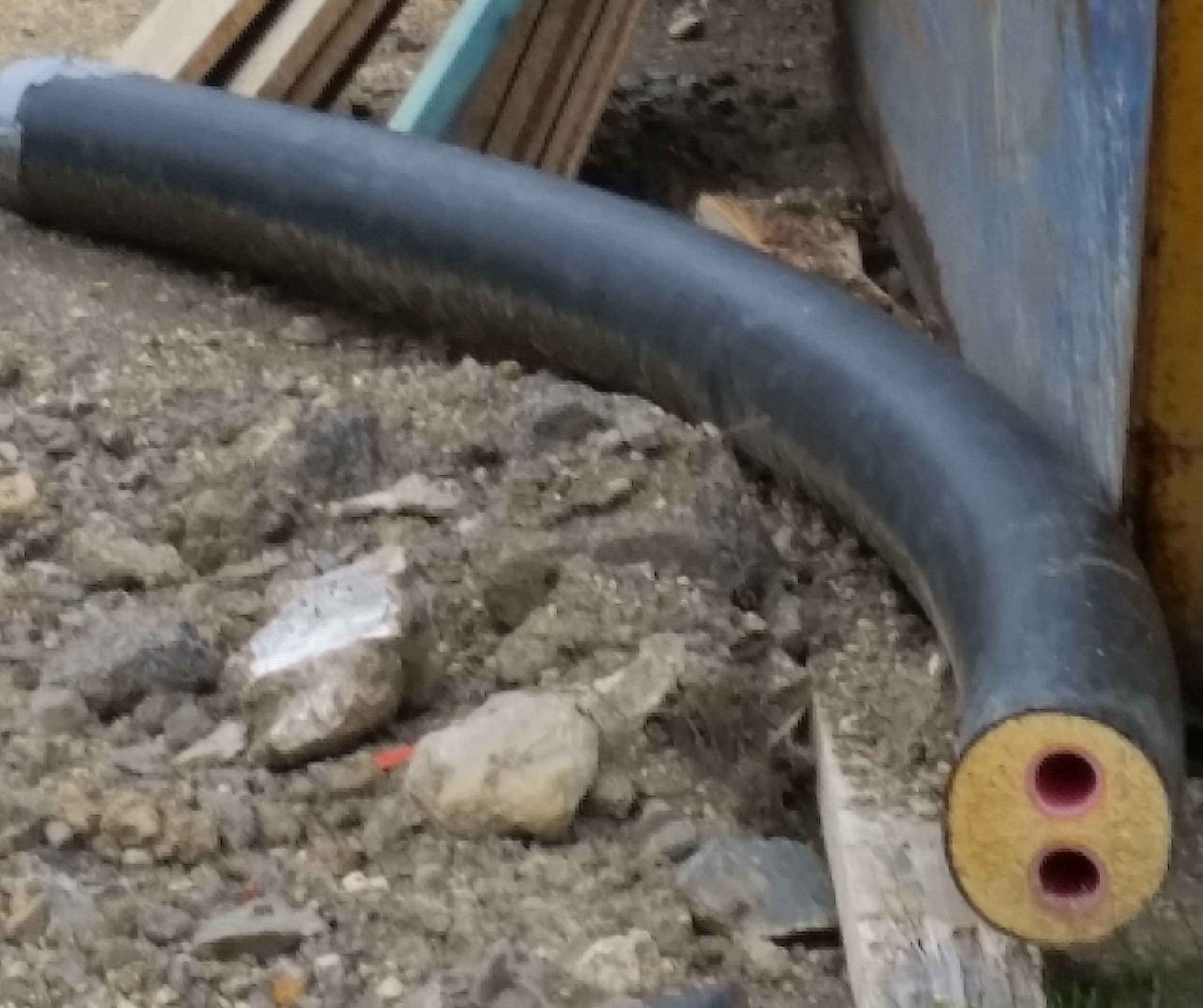

curlewhouse Posted September 21, 2016 Share Posted September 21, 2016 Just seen this on a building site - looks like some sort of really well pre insulated pipe but I've not seen it before. Any ideas? Link to comment Share on other sites More sharing options...
ADLIan Posted September 21, 2016 Share Posted September 21, 2016 District heating system pipework. Ian Link to comment Share on other sites More sharing options...
Kev106 Posted September 21, 2016 Share Posted September 21, 2016 It's something similar to the link below. I have an oil boiler located in my detached garage. This prevents me from heating my back yard http://www.treco.co.uk/products/boiler/Uponor-Pre-Insulated-Underground-Pipe Link to comment Share on other sites More sharing options...
curlewhouse Posted September 21, 2016 Author Share Posted September 21, 2016 (edited) Ah, now I've got it. The house they are building is just one property, but I noticed their ASHP is way across the garden from the house - so this pipe would make sense from what you've both said above. Cheers. Had my eye on that offcut (like you do ) but wouldn't really have a use for it . Edited September 21, 2016 by curlewhouse Link to comment Share on other sites More sharing options...
IanR Posted September 21, 2016 Share Posted September 21, 2016 I've got a similar twin core pre-insulated pipe running under my slab ready to connect the ASHP up. Link to comment Share on other sites More sharing options...
