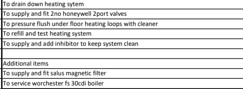

be96erj Posted July 13, 2019 Share Posted July 13, 2019 Hi, could anyone tell me what they would pay for the following work on their wet underfloor heating system? I've been quoted £600 and it and it seems very steep. Anyone got any idea what the going rate for this kind of work would be? thanks Link to comment Share on other sites More sharing options...
Jeremy Harris Posted July 13, 2019 Share Posted July 13, 2019 Welcome. Breaking that estimate down by item: Honeywell 2 port valves cost about £80 each and will take maybe an hour to change, at around £20 to £30 per hour, so about £180 to £190. A power flush takes a couple of hours or so and typically costs around £200 to £300, so that's another fair chunk. Refilling and testing the system shouldn't take more than an hour, so maybe £20 to £30 for labour. Inhibitor will be around £30 for 4 litres. A Salus magnetic filter is about £50 A boiler service is typically around £100 to £120 or so Adding that lot up comes to a bit over £600, so the price you've been quoted seems about right. 1 Link to comment Share on other sites More sharing options...
Bitpipe Posted July 13, 2019 Share Posted July 13, 2019 (edited) 22 minutes ago, be96erj said: Hi, could anyone tell me what they would pay for the following work on their wet underfloor heating system? I've been quoted £600 and it and it seems very steep. Anyone got any idea what the going rate for this kind of work would be? thanks Quick google shows the filter to be £50 as are the valves so that's £150 in parts. Add £50 for the inhibitor & cleaner and you're up to £200. So £400 for labour - all depends how many hours they expect to be on the job... Edit - as ever Jeremy has done a much more thorough job than me Edited July 13, 2019 by Bitpipe 1 Link to comment Share on other sites More sharing options...
newhome Posted July 13, 2019 Share Posted July 13, 2019 I didn’t do anything quite as thorough as the 2 posters above but as soon as you take into account the parts being supplied it looks about the right sort of money to me. Link to comment Share on other sites More sharing options...
Temp Posted July 13, 2019 Share Posted July 13, 2019 So its about right if you need all that doing. It is possible to flush UFH pipes yourself. Many manifolds have connection for hoses. Link to comment Share on other sites More sharing options...
