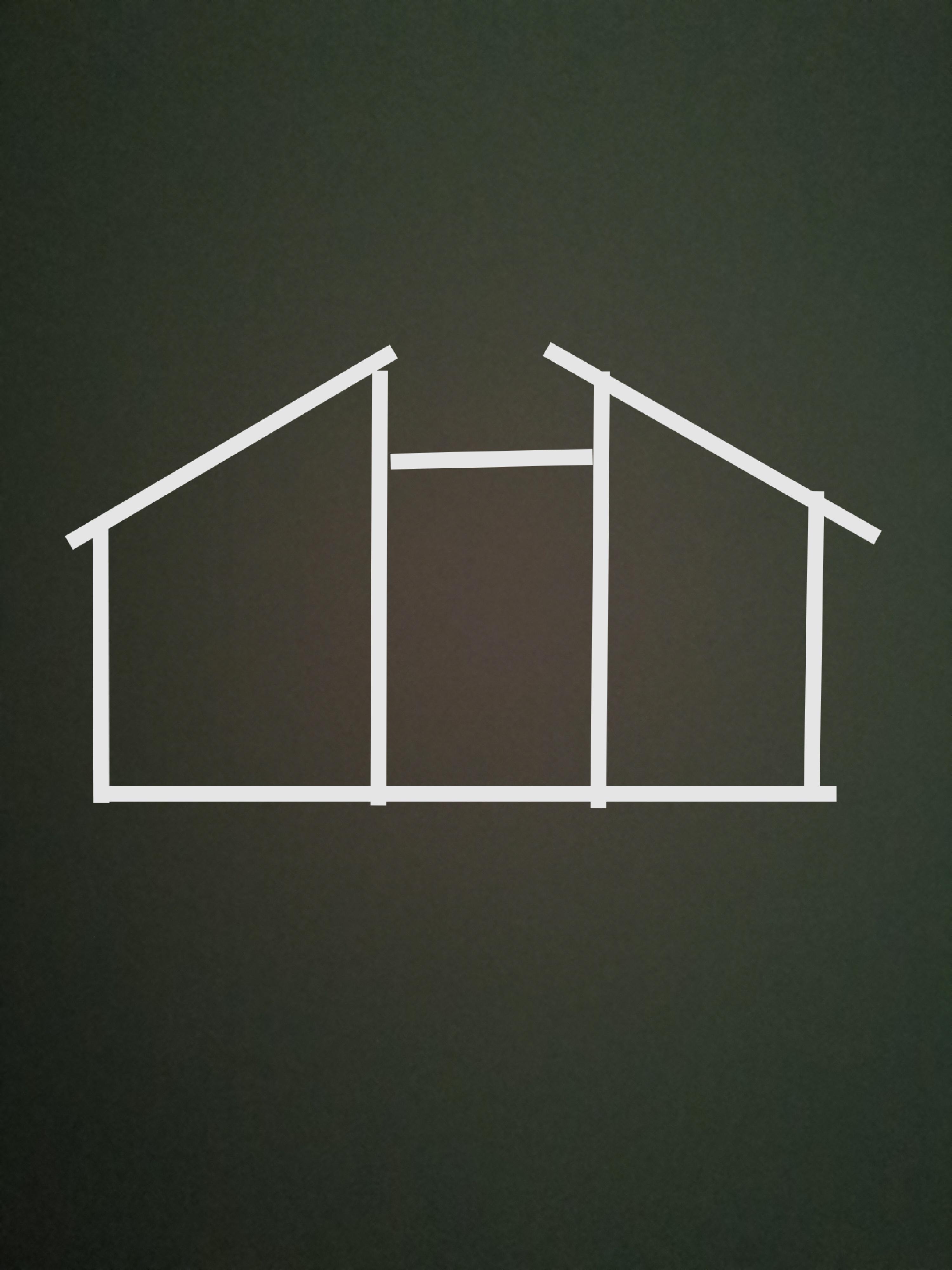

chr15athome Posted July 3, 2019 Author Share Posted July 3, 2019 Thank you for your comments guys sorry I was busy yesterday. It looks like I am best probably adding 10% to the total floor area to be safe. I couldn't find the images I was going to post but will if I can find again. I added a quick rough phone sketch of the rough roof type. Thanks for all your help guys so far. Link to comment Share on other sites More sharing options...
