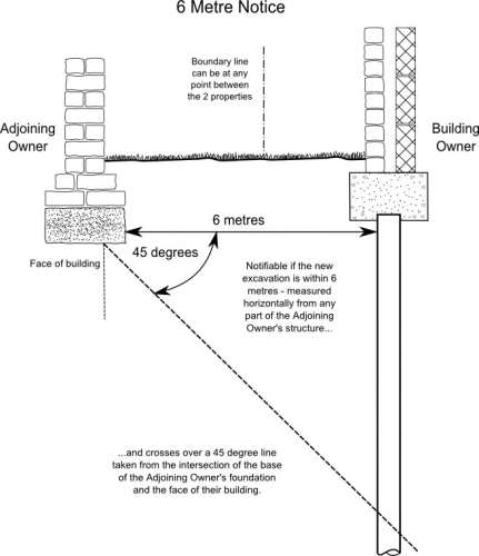

Do I need to concern myself with the Party Wall legislation?
My plot has back gardens on two sides. Parking spaces for flats on one other. But on one side I have a path behind houses claimed as being part of the property of the neighbour who’s house is on the other side of the path.
On that side, the wall of my new house will be the boundary with the path.
Is the Party Wall Act relevant for me?

What matters is the distance between your foundations and any neighbouring building (not the boundary). And the depth of your foundations.
Google "Guide to party wall act". It has diagrams that explain the depth Vs distance issue.
Thanks @Temp. I found it and read the guide, and bits of the law too for good measure.
It refers to excavations within 3 or 6 metres of a neighbouring building. I wondered if the placement of screw piles would count as excavation. One screw pile company says: "As the screwpile does not require any earth removed during installation the need of a party wall act can be eliminated, as you are not undermining your neighbour’s foundation", so I suspect not.

I am working with a Party wall surveyor at the moment for our build which hopefully start in September.
If you are placing screw piles within 6meter from your neighbors structure (I mean some structure which has a foundation, sheds or fence won't count) , and your screw piles are long as diagram below,  you will need to serve the notice. It depends how deep your screw piles are.
As I don't know your site plans, it is difficult to know if you need party wall notice or not.
It would be best approach some professional, I found Party wall surveyor through here:
https://www.localsurveyorsdirect.co.uk/partywall-surveys-consultancy
Edited by Tony C
Ok so my understanding is screw or helical piles are exempt and are designed not to disturb the ground. What however is happening is a lot of a##e covering from the insurance industry and PWA surveyors where this is just not needed.
I would ask a solicitor because the PWA is very clear on excavations and special foundations and screw piles are not mentioned.
