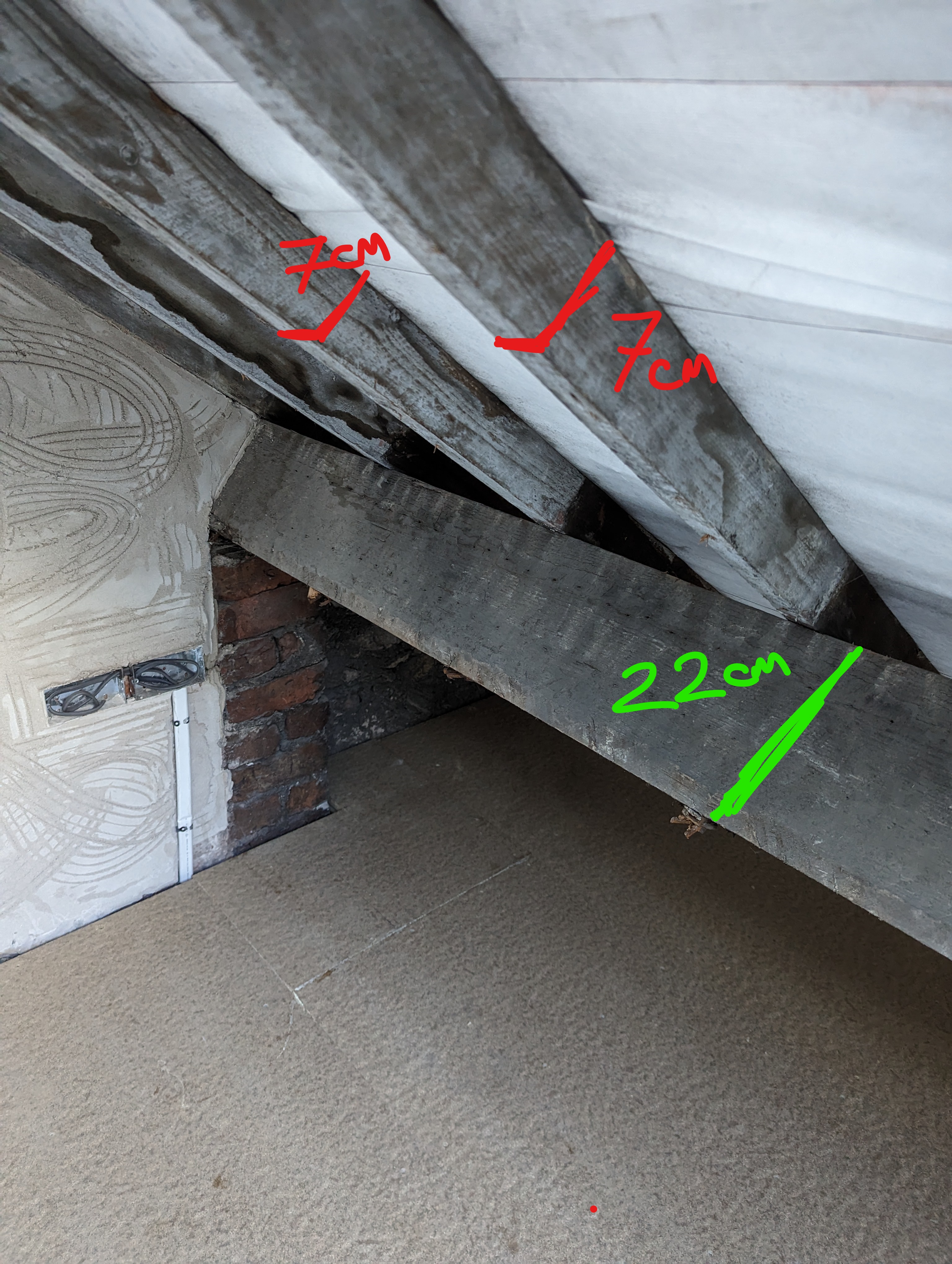

Hi everyone! Could I get some advise on our pitched roof, and how to effectively insulate it? The space under the roof will be an office that will have heating. My main concern is keeping the space as cool as it can in summer, while keeping the heat in, in Winter. It's a old Victorian house, that has currently has (listing from outside-in): slate, tile baton and then a Tyvek breather membrane that's nailed onto the rafters. The issue lies with the fact that my rafters are only 7cm deep, which then sit on the purlin, which is 22cm deep (see attached pic). What I'm thinking, is, from the Tyvek in; Tyvek breather membrane 50mm ventilating air gap Multifoil Insulation (SF19 or SF40) - stapled on to the INNER side of the rafters, going into the recess to let it expand, and installed in continuous layer Timber counter batten (air gap) 200mm PIR boards - installed as complete sheets, onto the counter battens Timber counter batten (air gap) Wood Wool board (25mm) (we're using lime for plastering so this is used throughout the house) Hemp lime render Does this sound ok? What I'm trying to deal with is the small rafters, and if I go about installing the multifoil in-between that space, then it leaves me free to install the PIR board as complete boards, and not having to cut anything down, which I imagine will help with insulating? The Multifoil I've read will help a lot with keeping the space cool in summer, as it will reflect the sun/heat from the slates, which sounds perfect to me. I'm no too bothered about keeping the purlin visible, is we desire 'that look' when we come to decorating, we could always put a fake plant-on or something to get that 'feel'. Does anyone have any advice on this? Many thanks!
