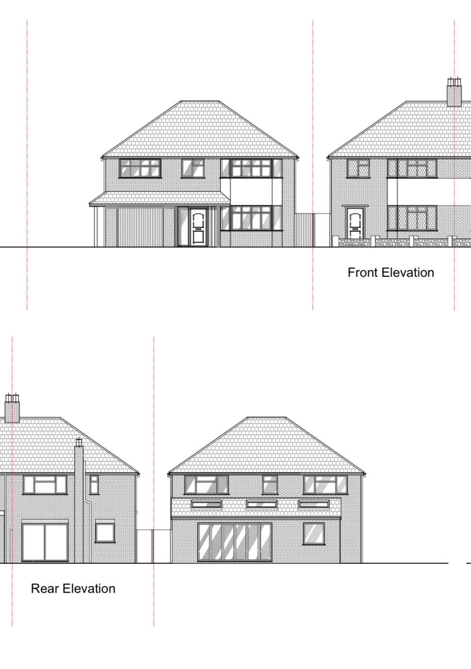

  7. Thanks all, I’ve spoken with the LPA and they stated that overall there’s a good chance of success in planning. She stated that we failed to submit any updates following consultee concerns. Mainly the tree/highways reports requested clarification on a few points. it’s annoying as I pointed this out to my agent and he emailed them asking if they needed it pre deadline but received no reply. They also wanted a water neutrality statement, pre deadline, but again there was nothing to suggest this is a pre planning requirement and we assumed could be added as a condition of planning. (I have even had the report on my desk ready to go for 6 weeks). Regarding cramped and overbearing I’ve accepted I maximised the house but it similar in size and look to surrounding properties but I concede is a bit tight on the plot. (Didn’t help that again my agent added the wrong rear boundary line/division of plots) I suggested to my agent that we lose the front left top corner (see below) to soften it a bit leaving the footprint the same. This will add a lot to build costs though as more complex roof. the full report is due tomorrow so, as stated, above will be like a pre-app and provide more guidance on resubmission. i have a planning guy who wants to charge me £3200+vat to redo it but I’m wondering if its worth it as im so close already?

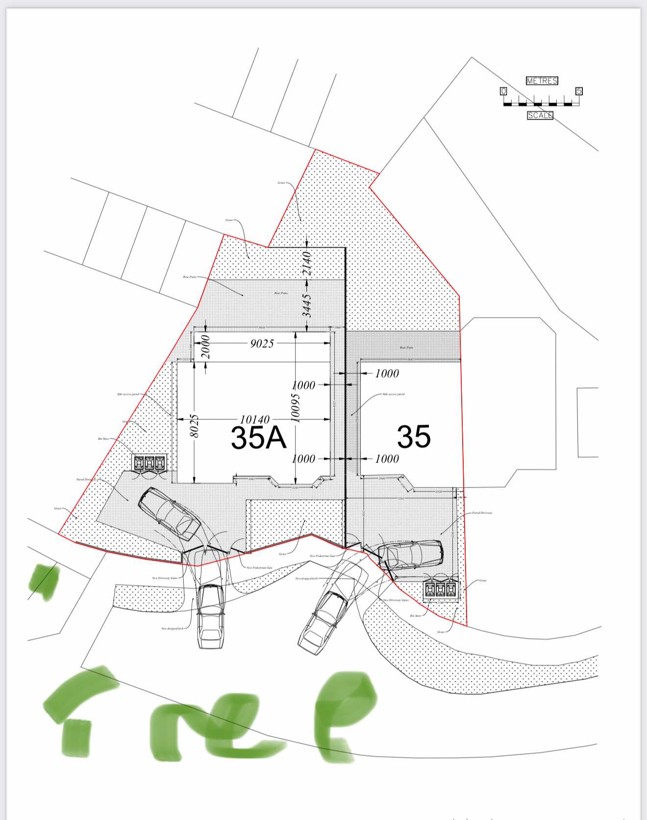

  12. I was thinking I could reverse the garage location from LHS TO RHS?

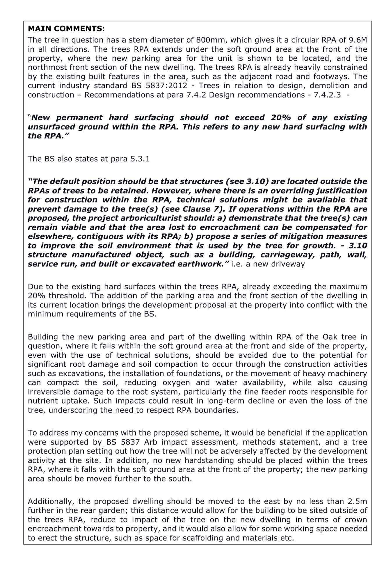

  13. Anyone got any views on the tree report below. the tree in question is on the corner of my plot with the corner of my proposed house being approx 10m from said tree. I was looking at parking space some 4m from said tree.

  20. Yes I mentioned that and he didn’t seem bothered and said that would get sorted at building regs stage. 🤷🏻‍♂️ he’s forgotten the door to the garage but it going to be in the utility. Ill go for a flat at the back and probably lose the roof light in the utility or maybe all three. whats the minimum size for the w? ive seen loads smaller only thing is a larger door which should fit in that wall. Ive played with the FF the designer says it wont work for the left hand bedrooms but I’ll get him to look again once we have planning.
  21. I’ve had some changes made to the original design. Ideally I am trying to get the en-suite to the front of the house to get better use of the hallway. My designer said he was unable to make it work with the left hand bedrooms. Also I have a super-king bed (2100mm wide) so the main bedroom is quite narrow and can’t fit tables in and have to go with a pocket door. I’m sure with some thought this can be sorted but we’ve parked it for now and decided to go for planning rather than get hung up on internals. I’m also a little concerned that having the boiler/plant so far from kitchen area may affect warm up times? Thanks for advice everyone.

  24. The site plan above was actually the first draft but takes a lot of the rear garden up. the reason for the front design was to fit in with the street scene. It’s all 3 bed 1950’s semi’s. A few people have added a side extension and that effectively what I’m doing but with a new detached house. it would seem to make more sense pushing the side boundary as it’s the end of the road next to a local park so I can go right up. The site plan above wastes a lot of outside space to the back left.
