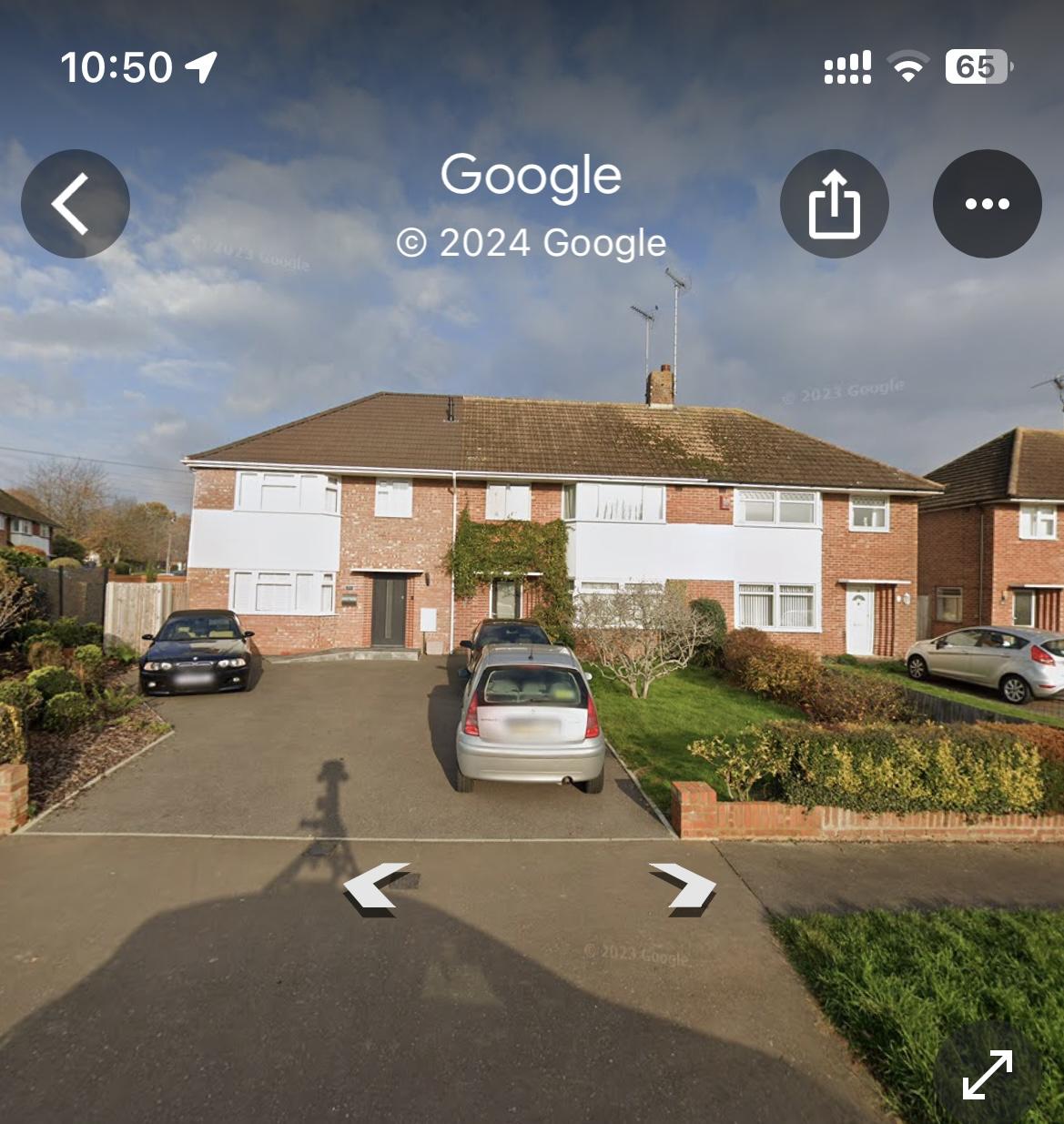

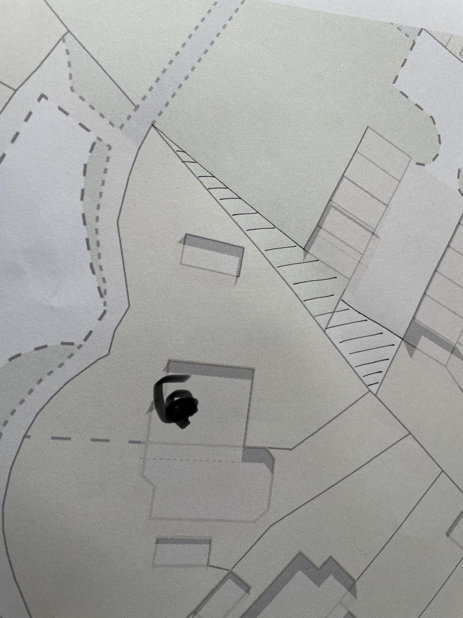

  3. Map view shows plot, includes land in dashed area. photo show’s house in next road which has done what I want to do. (main road) house I’m looking at is in a quiet corner.

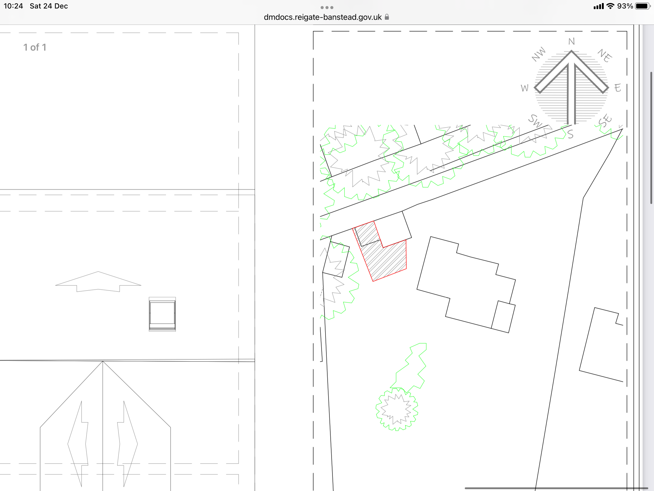

  7. I’m toying with the idea of using a different are of my plot. I’ve got permission to enlarge my garage and add a second storey. the thought was to apply for annex status then apply for separate dwelling in another application. Reasoning is they can’t refuse on flooding basis if I use the same footprint?

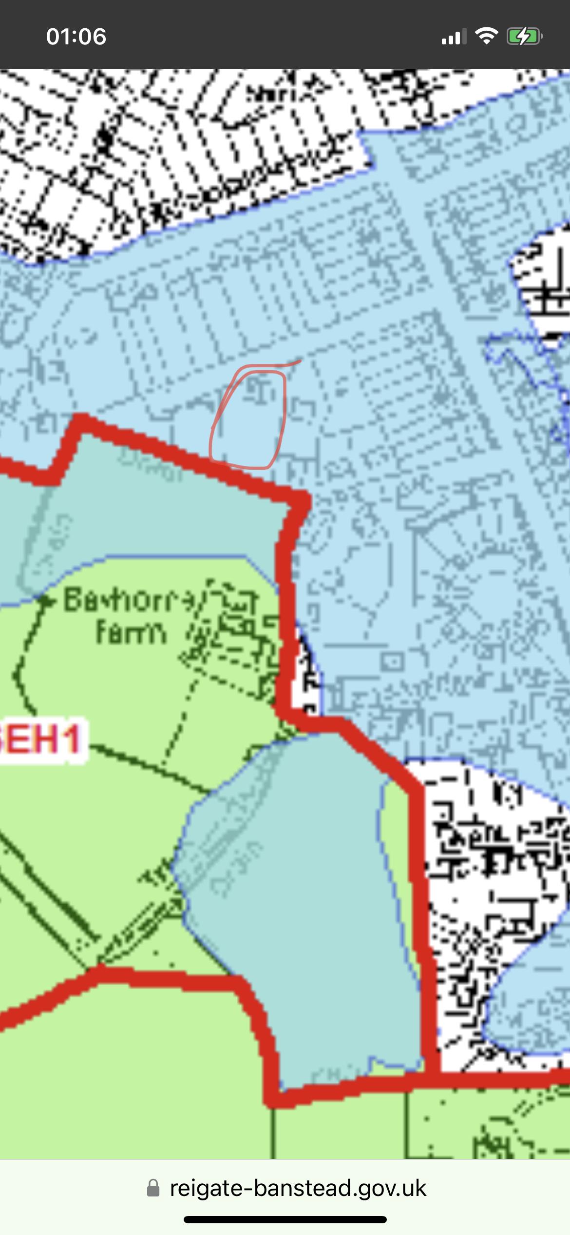

  8. Spoke to the planning department today and was basically told I had no chance of passing the sequential test as there would always be somewhere in flood zone one to build a single dwelling. only hope of achieving planning would be a remap of the zone which it unlikely in my lifetime. go figure 🤷🏻‍♂️

  12. Thanks for advice, im at RH6 just north of LGW. As you can see below the flood plain is quite extensive I’m the red circle. im not sure how effective an arguement it would be but I’m currently 1 mile north of the airport where I walk to work. And overlook fields. Could I argue that I need a plot walkable to LGW? 🤔 sounds like a stretch but using the paddock agreement above might hold some weight?

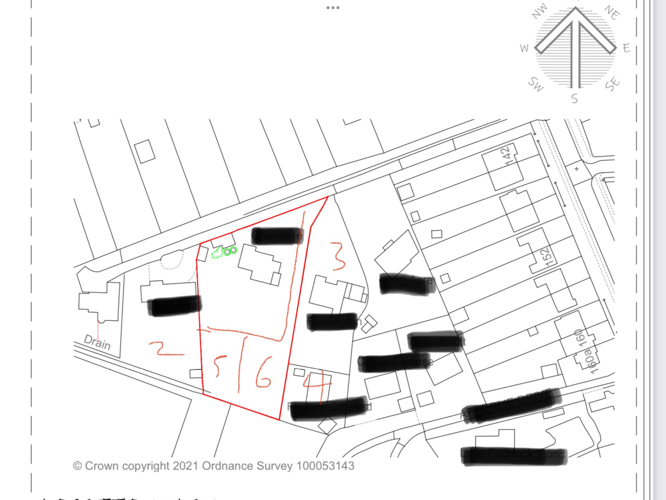

  13. Planning for my rear houses has gone to pot due to sequential test. (See my other post) I’m now revisiting this option what would be the best way to proceed? I assume some sort of change of use to make the Annex a self-contained dwelling? If that is approved then a following application to demolish and complete rebuild to something more suitable. Is that a straightforward application or a whole load of hoops?

  15. I’m looking at planning for a single dwelling in flood zone two. The government strategy states that I am exempt sequential testing under minor development status. see here: https://www.gov.uk/guidance/flood-risk-assessment-the-sequential-test-for-applicants However, Reigate and Banstead Council say they will still apply the sequential test for all applications in floodplain 2. also that the are they use is the entire borough some 130sqkm and so I’ve got no chance in passing it. Do I have any right to appeal that they are going against government guidelines? thanks

  17. Yes I moved in in 2013, houses 1/2 were done in late 80’s, 3 was done around 1980, 4 around 1995. I’ve an option agreement for 5/6 for another 18 months to a developer.

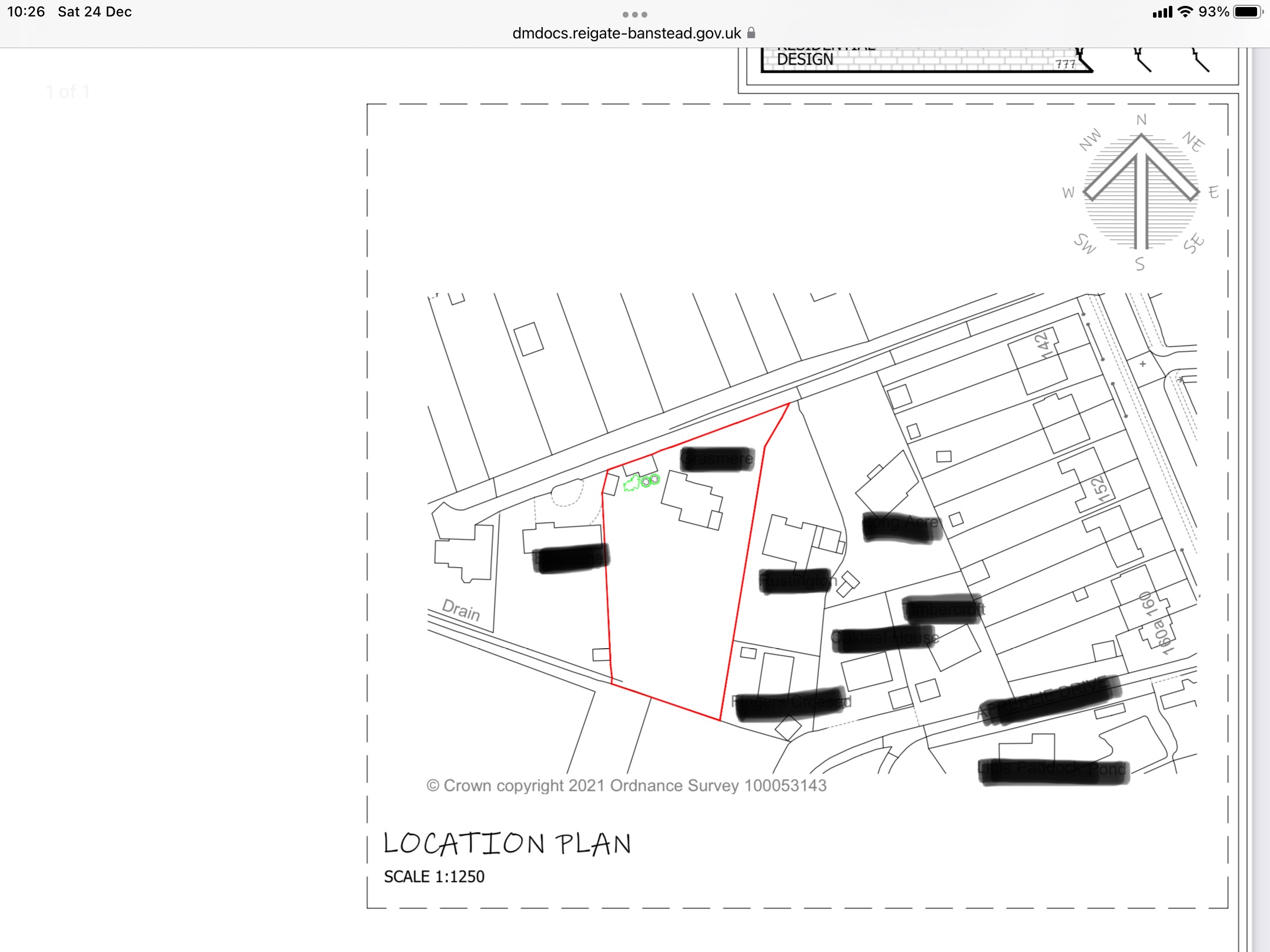

  18. Thanks, the more I look at it the more I’m thinking I’ll try for full planning and a new dwelling. Not sure how difficult that would be but I’m hoping the principal of a large development has been established/approved. I’ve attached a location plan. I would probably need to replace the lost garage for the existing house but plenty of room on the other side for that.
  19. I recently got PP to convert my garage to two storey (room above) with a large side extension, ( garden room). As it happens it turns out the foundation are not acceptable to my BCO, Who for some reason wants 2m trench fill so I’ll have to demolish and start again. anyway I was wondering if it would be to possible convert the PP to a new separate dwelling . My neighbour recently got denied on the fact the development was in flood plain 2 but if I’m not building anything bigger than what’s already approved then surely that argument should be moot? Thoughts? Garage plans.pdf
