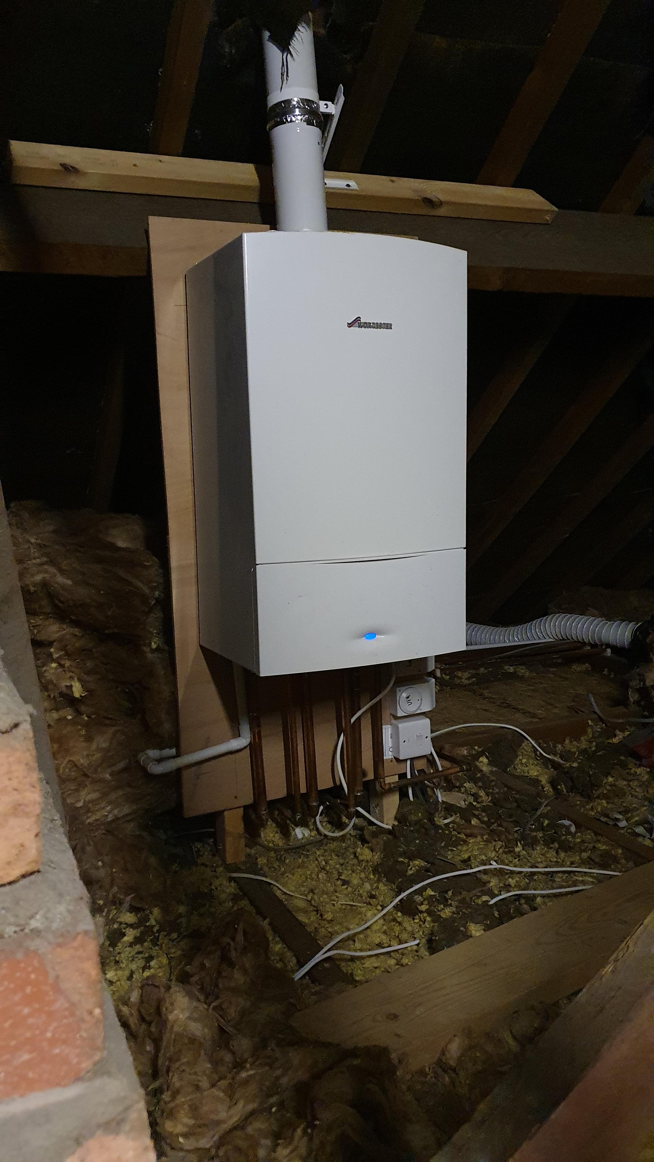

  3. Did the render bend without cracking?

  5. Wow that's impressive. My initial thought was that it's pushed the render bead away from the frame rather than distort the frame itself. But then I would expect the render to crack?

  10. Thanks for the info. The boiler is a Greenstar 34CDi. I know I've been overcharged for the work. It's a shame that some tradesmen only see pound signs in these situations. But if he's going to overcharge at least he could do a proper job. My main concern is that the installation itself is regs compliant. There is a loft ladder which was already in place prior to the work and an attic light already in place as well. There's just no boarding and I didn't know if this was against strict regulations or whether it just invalidated the warranty on the boiler.
  11. Yea you'd think so! It's been moved pretty much directly up from the kitchen to the attic.
  12. Thanks everyone for your replies. Thanks Mark. The boiler is still within the warranty period so I'll be reminding the builder of that. I agree that the lack of lagging is poor and I'll certainly be getting them sorted prior to winter. I believe the builder has taken a liberty with the price of the job (£2070 plus VAT), given that he knew we had to have it done if we wanted the extension work to continue.
  13. Thanks for your response Tony. Yes exactly. I'll have a look for the boiler installation manual.
  14. Hi everyone, I'm currently having an extension built onto my house and due to the works ongoing and the fact that we are living in the house for the duration, the boiler had to be moved from the kitchen. There weren't any other realistic options other than to put it into the loft. I've read that there are regulations surrounding boilers installed in lofts - adequate loft access and boarding to allow for servicing etc but I was wondering if someone could tell me if these regulations are required prior to sign off or just a guidance. The builder has used his own gas safe plumbers to do the work and tells me that he'll be able to sign off the work. He said that only a 'fussy' plumber would refuse to service it as it is. If it's a case that boarding is a non negotiable requirement then I'll insist on it. He's certainly charged me enough for the work - approx £2.5k which seems extremely high to me. Please see the attached photo. Any advice on the regulations would be great. Thanks, Dave
