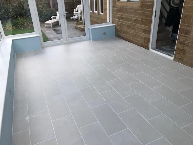

All done now (except for skirting); thanks for your input. And here's what it looks like. In the end I started in the middle of the floor, so it was centered on the double doors and almost centered on the single door (to the right in picture); If I had centered on the door, then I would have had about 5cm cuts at the end of rows. As you can see, there is less than half a tile width by the house-wall and more than half by the outside wall so not symmetrical, but far less noticeable (and permanently annoying to my wife) than a center-line offset by about 20mm from the center of the main double-doors.
All done now. I used Durabase matting and a 10mm half-round trowel (and a tile-leveling system).

Except for the 3 doorways, but that is my plan. My wife thinks we might not need skirting, by I know that I am not that good. I managed to do that on a wall in a property I let when trying to be clever, so I have learned my lesson.
Thank you. I plan on making a "tiling stick" to get the layout right (I have done a theoretical layout using the nominal tile and spacer dimensions, but they may not fit together in practice as they do in theory"). I was hoping some experienced tilers might say "I tile a floor like this".
Thank you for replying. I have done a scale drawing on the computer and determined that the centre line needs to be through the centre of a row of tiles. I will also have to do a bit of jiggling because that is showing a 5cm "prong" going into one of the doorways and I am a bit worried that it might snap off. But getting rid of that gives a 24cm cut on one edge and a 14cm cut on the opposite edge (and I do like symmetry) That is what I was taught for walls. My worry is that the space left will make it difficult to spread he adhesive and I won't get full coverage, or it will be too deep and fill the grout lines. Some of the "edges" (end of rows of 60x30 tiles) will be almost full tiles (because of the brick pattern) and getting those in properly (adhesive coverage and level tiles) after the whole ties have set seems like quite a challenge. It wouldn't be such a problem if I were laying with four tiles meeting at corners.
Thank you.. I suppose the idea is that you get all the cutting done and then just blatt through the fixing. The second batten doesn't work for a "brick-work" pattern. I think I will go with a straight edge held down with boxes of tiles to guide the first row. It is because of the brick-work pattern that I was thinking of doing the "end" cuts and laying a couple of rows at a time. Definitely going to back-butter. Definitely not using rapid set as I am not fast enough for it. But rapid set has been recommended for fixing the decoupling mat, and I think I should be OK with that, as long as I mix just enough for one length of matting at a time.
When I did my (2 week) tiling course, we were taught to: dry-lay the entire floor with spacers and all the cut edge tiles (working toward the door). remove some tiles to provide access to the other side. Remove a row or two of tiles, then apply adhesive and lay them, using the dry-laid tiles for alignment. Work backwards towards the door. I have found when using this approach that the tiles don't seem to go down with adhesive exactly where they were dry-laid, meaning that some cut tile no longer fit. For my conservatory (600x300mm porcelain tiles, staggered pattern) I'm thinking of cutting edge tiles for a couple of rows, laying those rows, then moving on to the next couple of rows (5.8m rows). With this approach, I could start along one long wall (lay a full row to get the alignment then the cut row), then work my way across the floor, Or I could lay a couple of rows across the middle of the room and work out from either side toward the two long walls. How do you experienced guys approach laying a floor?
