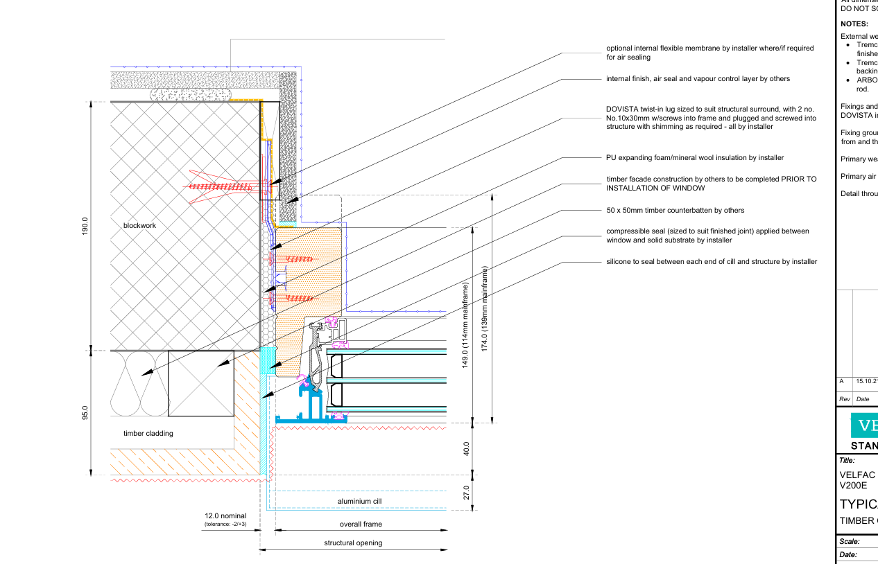

Recent Profile Visitors
flanagaj's Achievements
Advanced Member
Advanced Member (5/5)
