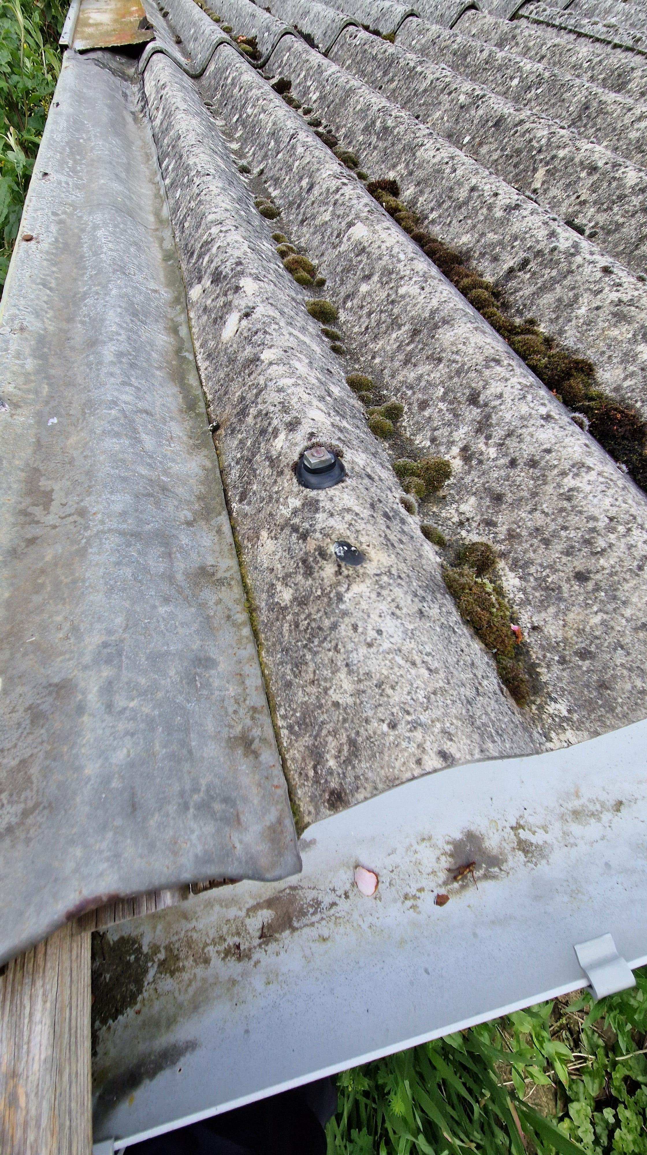

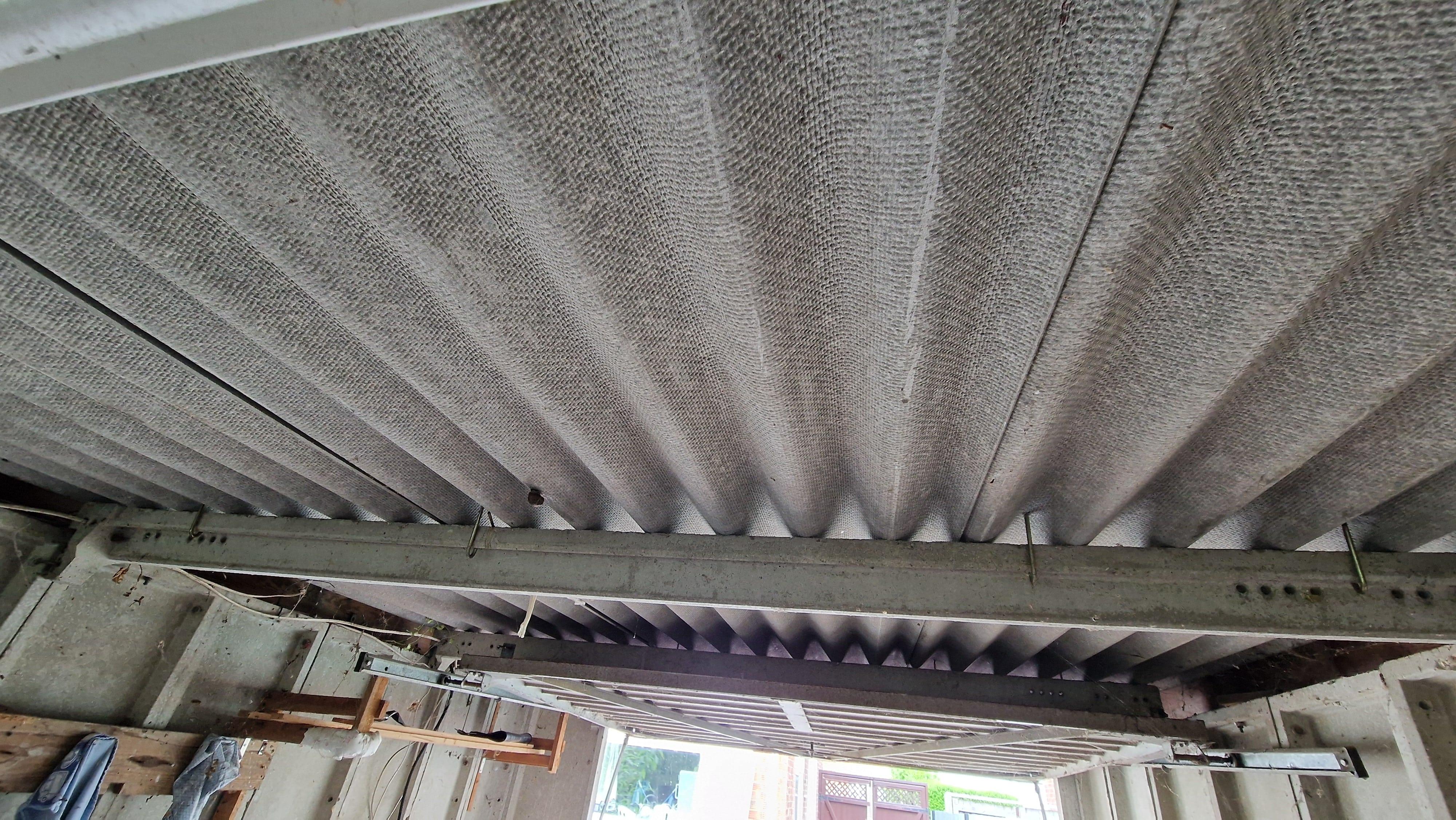

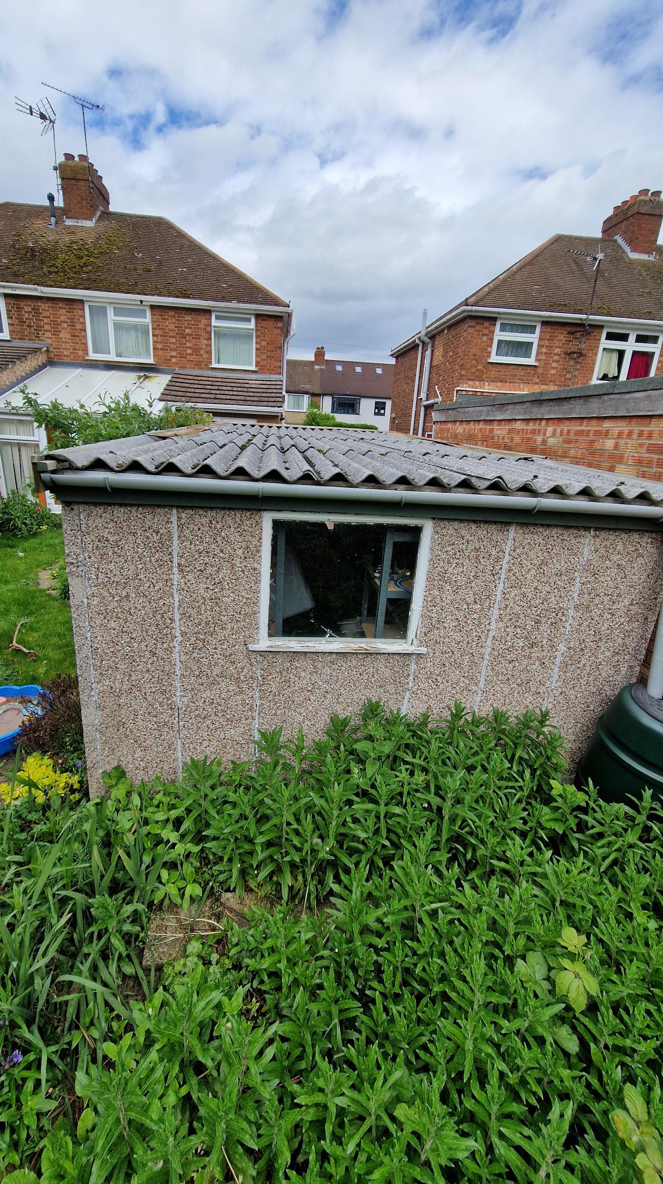

Thanks all for your replies on this. I think the DIY route is most likely for me. For info, the two quotes I've had back so far are £695 - it seems steep given the simplicity of the work, but then again I don't know what commercial rates they pay for disposal. I've also sent of a sample of the roof for analysis just do double check that it's definitely asbestos - a friend round the corner recently did the same job on his garage, but the roof looked a lot older than on mine, so a glimmer of optimism remains. However, given my general luck so far on this project, it's safe to assume that it will come back as a positive 😃

@FarmerN I think the comments above say it's very likely to contain asbestos because of the age, just that it's a relatively low risk type of asbestos.
Thanks a lot for the tips everyone 🙂 I am considering doing it myself as you recommend, I guess I've just been ultra paranoid about anything where asbestos is mentioned. Under all of our carpets we also have vinyl tiles containing asbestos which need to go at some point as we're redoing our floors. I've just been looking into my council and they also do Biffa collection at £90ish for 50kg. Do you remember how many sheets made up that 22kg, and how big they were @FuerteStu?
Hi all, We have a concrete garage with an asbestos roof which needs to be taken down before building our extension. My plan is to have the roof removed by an asbestos removal company, then stick the concrete part on eBay for someone to come and take away. The roof is 6 metres x 3 metres, 9 panels - photos attached. I've contacted a company to ask for a quote - just wondering if someone here could guide me on what a reasonable price for removal and disposal of this size of asbestos roof would be? Thanks!
