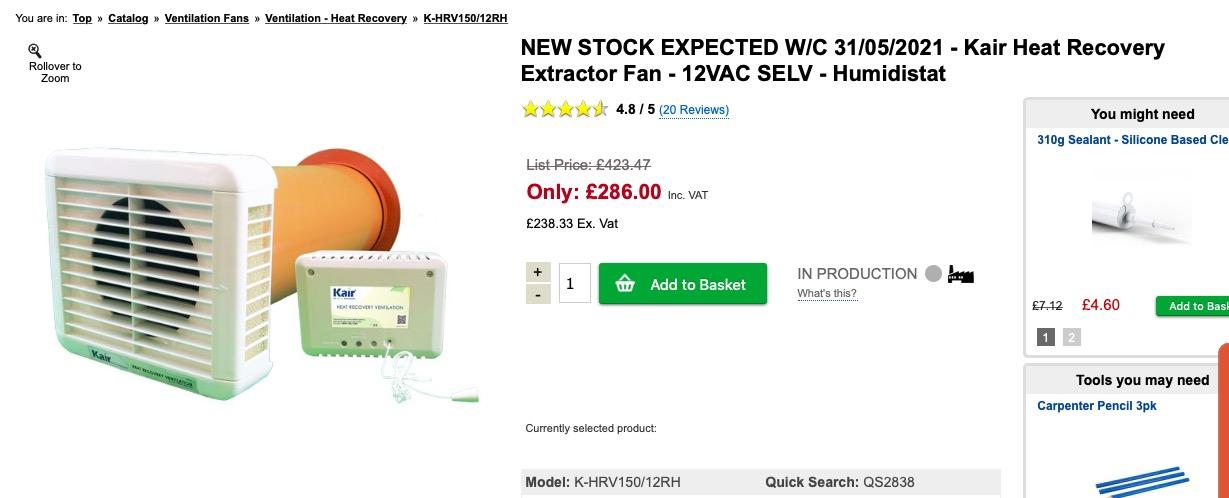

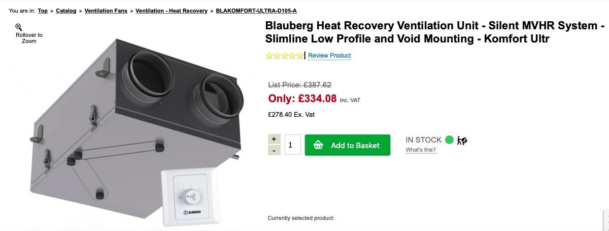

  4. There's 300mm of loft insulation directly above the bathrooms. It's the lack of ventilation and the love of long, hot showers. As a minimum it needs an extractor. If a MVHR brings additional benefits, then I'll get one of those fitted with ducting going to the 2 bathrooms. If it's marginal, then it'll be 2 x standard in-line extractors venting via the soffits.

  7. Yes - just for the 1st floor bathrooms. Loft is directly above. No more holes than 2 x single-room units, but more ducting. Is it a good idea to mix different humidity intakes? i.e 2 bathrooms and a landing?
  8. Yes, it'll be just for the 1st floor bathrooms, they're about 8m apart, all accessible via the loft. I've got plastic soffits etc.

  11. Yes, then I saw a multi room isn't much more. Originally I was going to get two extractors fitted, which are a lot cheaper, but I was wondering if it was worth getting something that'll recover some of the heat and provide ventilation as the bathroom ceilings have gone mouldy.
