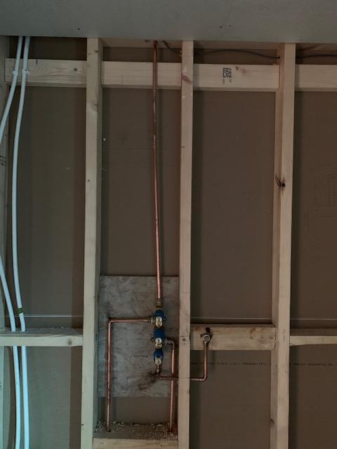

Thanks both for replying, was hoping general opinion would be that it is okay, system has been filled so no leaks, was just concerned could be a weak point over time but sounds like will be fine to leave as is, I think there is a very slight bend in the pipe but could have probably benefitted from a bit more, Many thanks, Lawrence
Here is picture of pipe coming out of top, there is a little bend but where exits valve is at a bit of an angle....
Hi, Plumber was doing bathroom today and was plumbing in thermostatic valve for shower in copper, all looks good other than the pipe that comes out of the top and runs up into attic for rainfall shower head. As there was something in way pipe is running at an angle - probably about 5 degrees, hot and cold filled and no leak but could this cause a weak point further down the line or doesn't it matter ? Will be a tiled wall ultimately so a pain if ever leaked in future. Just looks weird as every other pipe goes straight into its housing other than this one and can't help feeling it should be straight. Guess only solution would be a couple of right angle bends close together - not sure of that would reduce flow at all as want max flow to the shower head or tp bend the pipe but bit late for that now as all hooked up. Any thoughts greatly appreciated. Many thanks, Lawrence

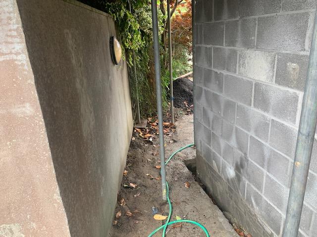

Hi, Need to re-route gas as part of renovation and best solution is to run tracpipe from meter to new boiler in garage, it would mean running pipe in ground (following recommendations/regs on depth/covering) through the gap pictured below which is 950 at narrowest point : Are there any regs falling foul of with that ? Found this in tracpipe document: On first paragraph guess okay given gap is 950 although do have to squeeze drainage pipe for surface water through there as well - guess not acceptable to go over top but could come off wall 250 for tracpipe, have another 250 and then lay the drainage pipe and then still have 250+ to wall although probably not foundation - not sure what regs are on the drainage pipe distances from foundations. The second paragraph worries me although another option is to move the meter into garage which is expensive and not ideal place in the garage and the gas company were going to run down side of house at similar sort of distance looking at with proposed run and surely that must happen a lot. Presume in this case the 'under' hopefully literally means underneath. Nothing else on the run other than further on run needs to go past manhole over sewer line (sewer line 1m down) but again should be able to keep 250 away from manhole. What do poeple think ? Should I be looking for another route although this gap would be the easiest run from meter to boiler (nothing else in house will be gas). Any thoughts greatly appreciated , Lawrence
