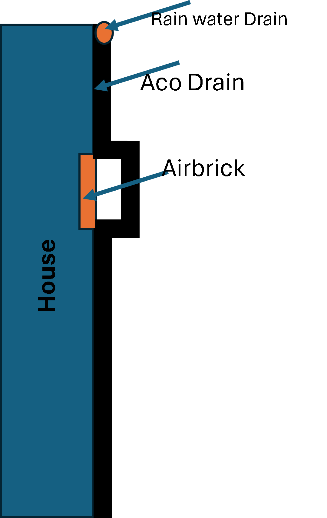

Thanks. I am pretty sure its ducted but will give the rod a go. We had wasps in that airbrick last summer. What if i did something like the this pic with an Aco corner unit (or similar) running round the airbrick - would this be an option ? Thanks -

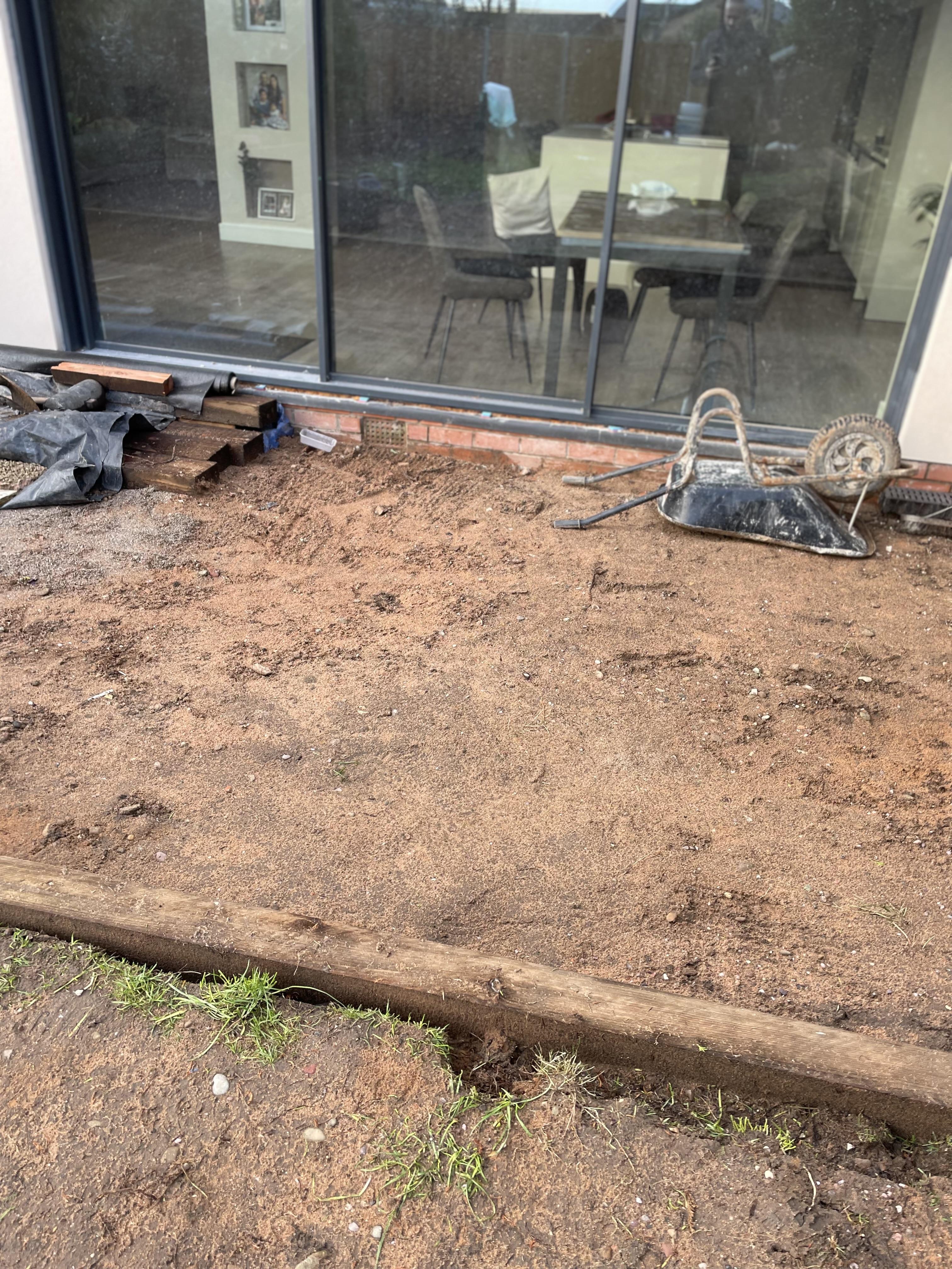

the building you see in the pic is an extension. Built before we moved in. It has a concrete floor which I am sure of the older part of the building is suspended timber flooring so I assume there is some ducting from the air bricks into the older part of the house -

And not put an aco in ? the dpc is fine - 150mm above the patio floor -

2 air bricks are affected -
Hi I’m just in process of digging up for a new patio. Ive started levelling out to 2 bricks under the dpc but trying to work out what best to do with these air bricks at the back. if I fit my aco drain it will come roughly half way up the air brick. Will this cause any issues in air circulation or given the fact there is some air flowing through it should be ok? Pic attached

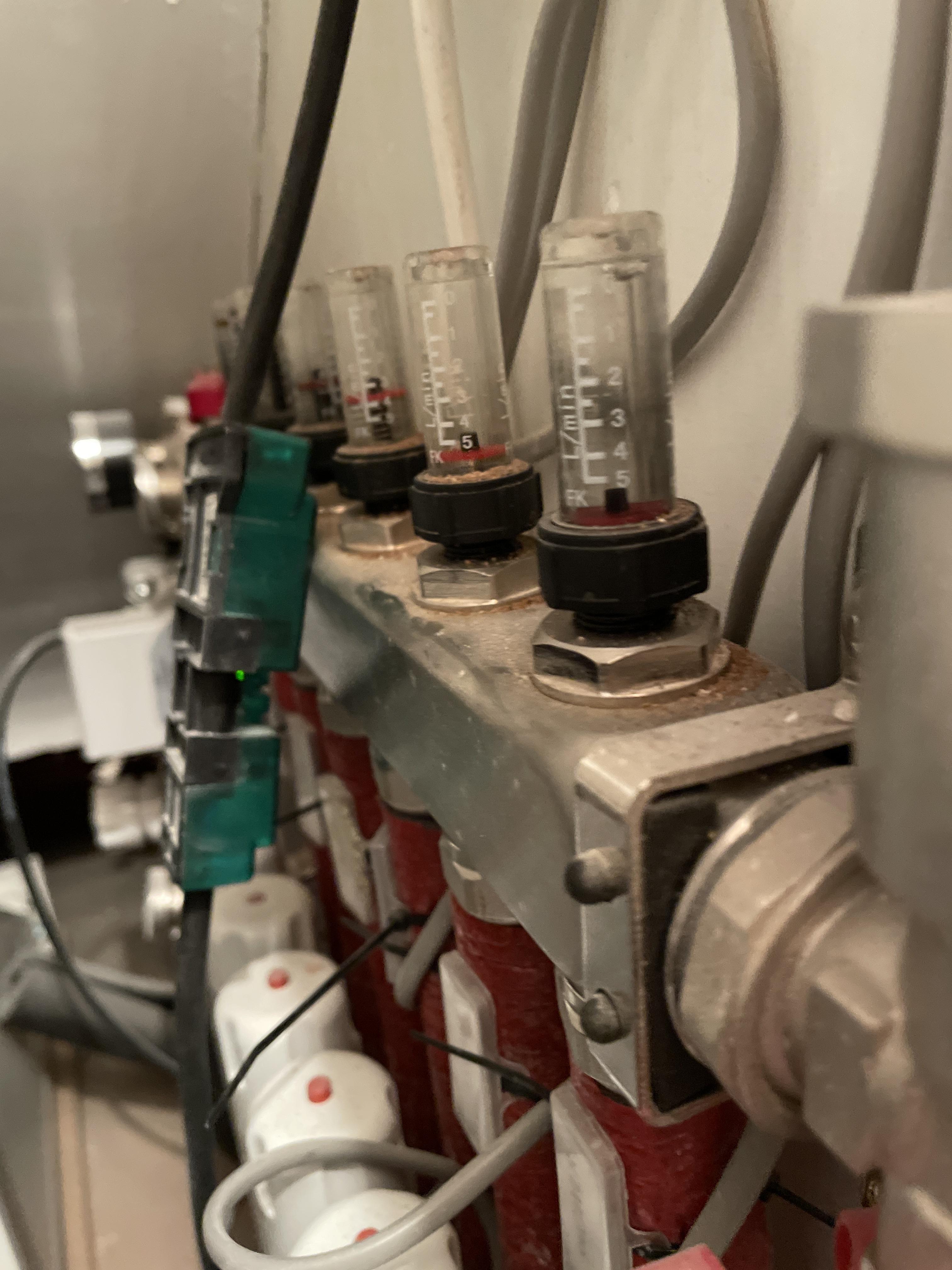

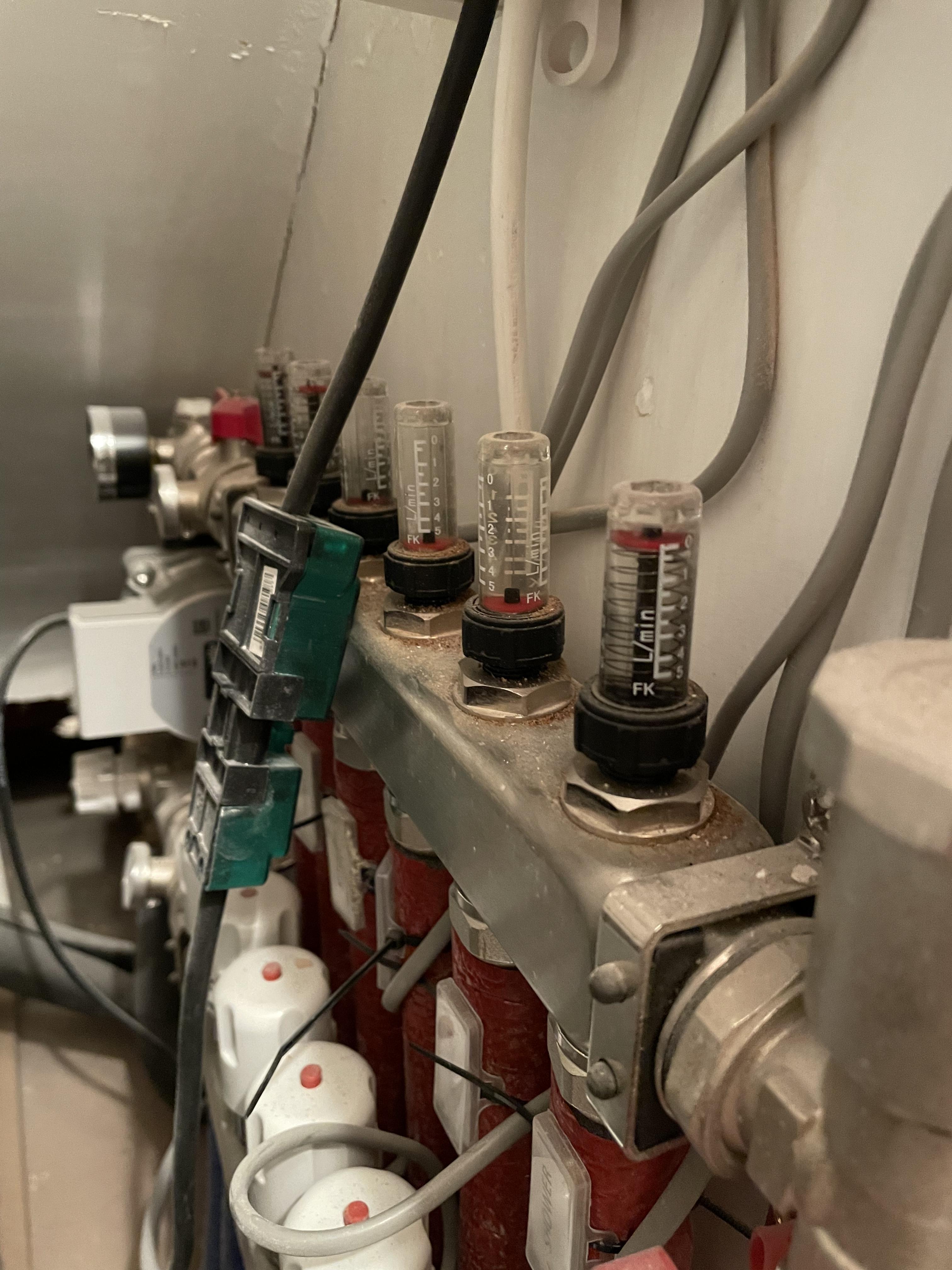

Yes I’ve got all the measures but when I twist the flow gauge there is no change on the flow rate. Just to confirm I turn it clockwise to decrease the flow right? -

I don’t really know how these things work but I opened another zone and the flow for that went straight to 5 and the other 3 loops which were open went down to 3 automatically - is that normal? -

hi - yes I can confirm they all go back to zero when I switch off the ufh. does anyone know the make of the manifold? Can’t see a manufacturer name on it unfortunately -
Hi Been trying to figure out how to change the flows on my manifold for a while now and whatever I do they don’t budge. Concerning the pic attached I got 3 loops for one zone. Each loop is around 90m. I thought rule of thumb is flow rate is run size divided by 40 so flow should be around 2.5ish ive turned the flow gauge clockwise a couple of times but not moving at all. Any other suggestions? The rooms heat up fine but take a while like with any ufh system.
