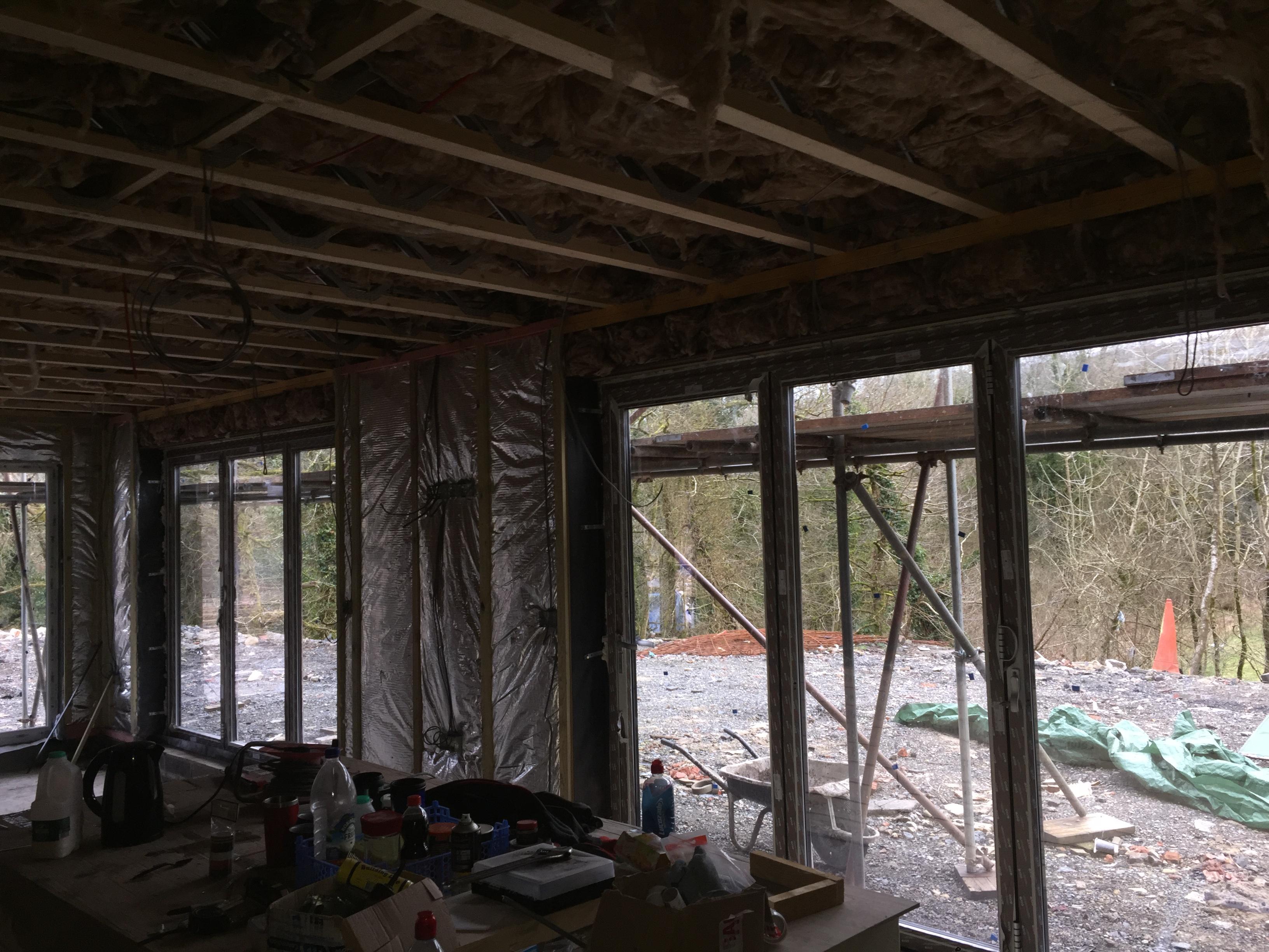

I'm probably a bit late, I am in the middle of a self build and am looking for advice. I have 240 m2 of floor space and have opted for UFH for the ground floor which I have purchased from NuHeat with Neostats. Upstairs I have aluminium Rads with a neostat on the landing and a 300 UV cylinder again with a Neostat all of which are hard wired. I have natural gas and am looking at a modulating Worcester 34kw system boiler. I have a 4kw pv system (SW facing and hopefully will fit an immersun) with single panel optimisers and a Beam c130 MVHR system. I have installed the first fix myself and am looking for any suggestions/advice on things I may have missed. I think I am down to about 0.17 on the external walls with 140mm batts and superfoil, osb before plaster board and also used the foil breather membrane on the external timber frame. A Scan 58 log burner has also been purchased as I am looking at cutting down on bills the closer to retirement I get ? . Dare I venture into the AV/networking!! I am dreaming cables at the moment!!! Thanks in advance C
