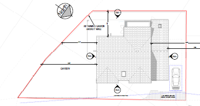

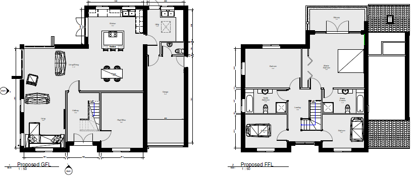

Garage is more so for storage. In our currebt house we turned our garage in to a sun rooma and utility, with 1m x 3m storage space, which isnt enough.
Good points, thanks. Orientation as per below. Gabion baskets will be around 1.5m at the rear, sloping down alongside the side garden space.
Afternoon, Does anyone have any thoughts/ recommendations for betterment of the attached layout designs? Any usability/ construction issues anyone could foresee? I know they aren't the most ground-breaking plans, but we aren't after some futuristic Grand Design as it's our first self build in a small village. Any comments would be greatly appreciated. Thanks.
A garage does not constitute a parking bay. Our drawings also show space for two parking bays in addition to the garage. The land either side of our plot does not have a footpath to the front. They are saying we need one, even though it is not going to connect anything to either side. There is a path on the opposite side of the road.

It's Durham City Council. We have a pre app and this wasn't specified. The land has had permission granted in the past, however his has expired, and there were no coal risk assessments within the online documents for either if those approvals. I've submitted a report from Groundsure which the architect has said should suffice. I've hit a new stumbling block now though with highways. 'In regards to these proposals the garage does not constitute as means of parking many are used as storage or converted and are not classed as in curtilage parking requirement for new housing. You will need to provide two parking spaces at the dwelling in front of the garage. In regards to the access and the 1.8m footway this needs to run along the site to the neighbour’s driveway (the existing verge is public highway). A 1.8m highway standard footway should be provided for access for future residents, servicing and post deliveries.'
