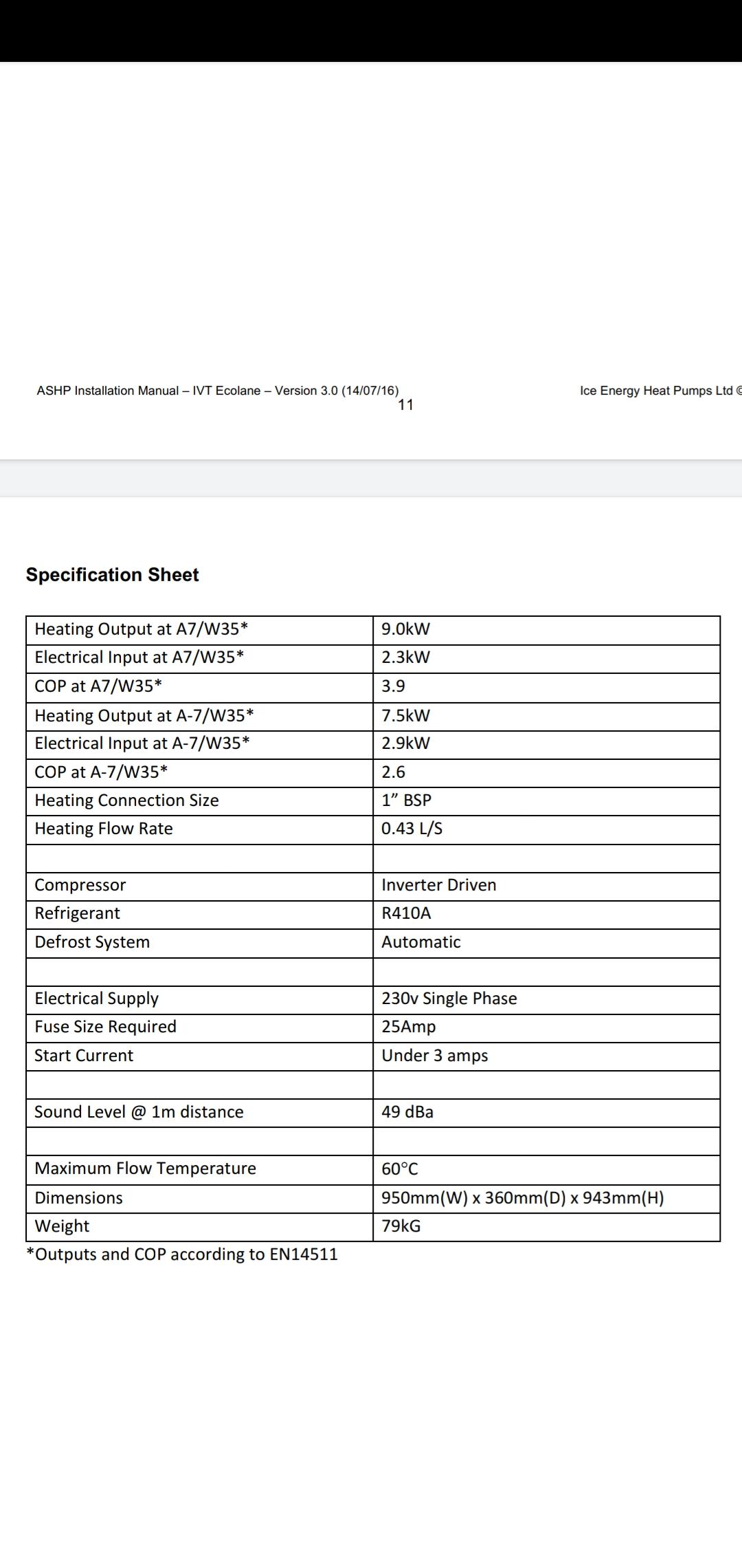

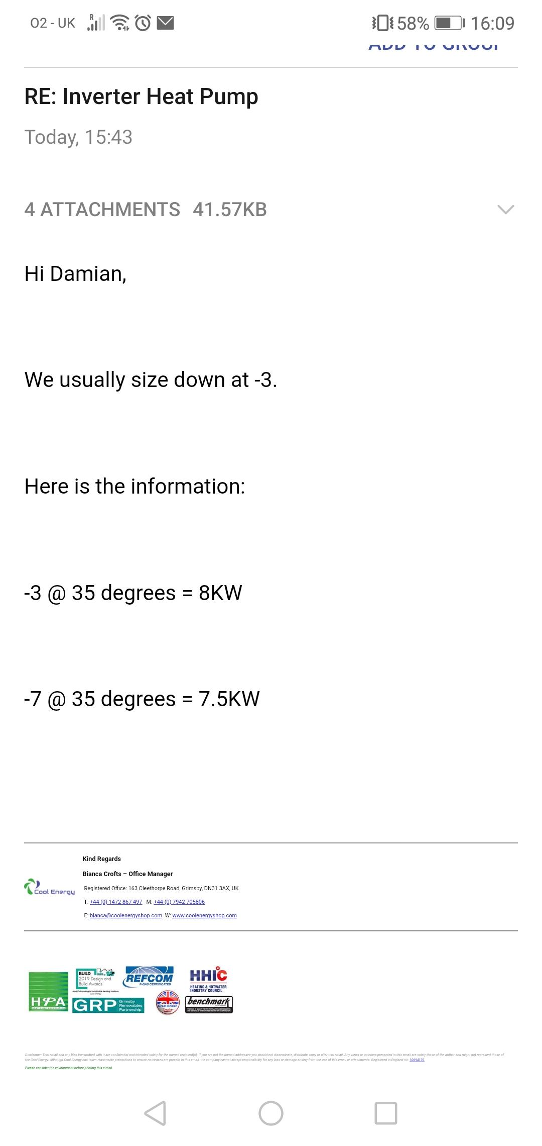

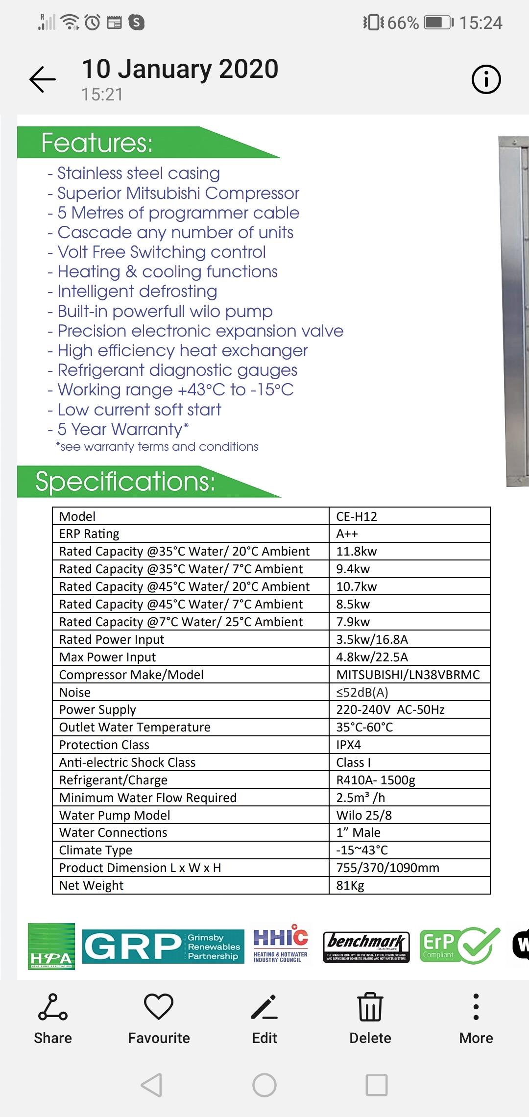

  10. It seems there is something to it but wildly overstated by the guy. The 11.8 is slightly more powerful that the IVT 9kw. I haven't paid much attention to this type or rating before. It's more like COP ratings in other heat pump documents.
  11. Just had a chat with the cool energy agent for Ireland. He said that the 9kw ivt heat pump would be equivalent to their 17kw because if how they perform their power rating. Is this sales BS or a real consideration?
