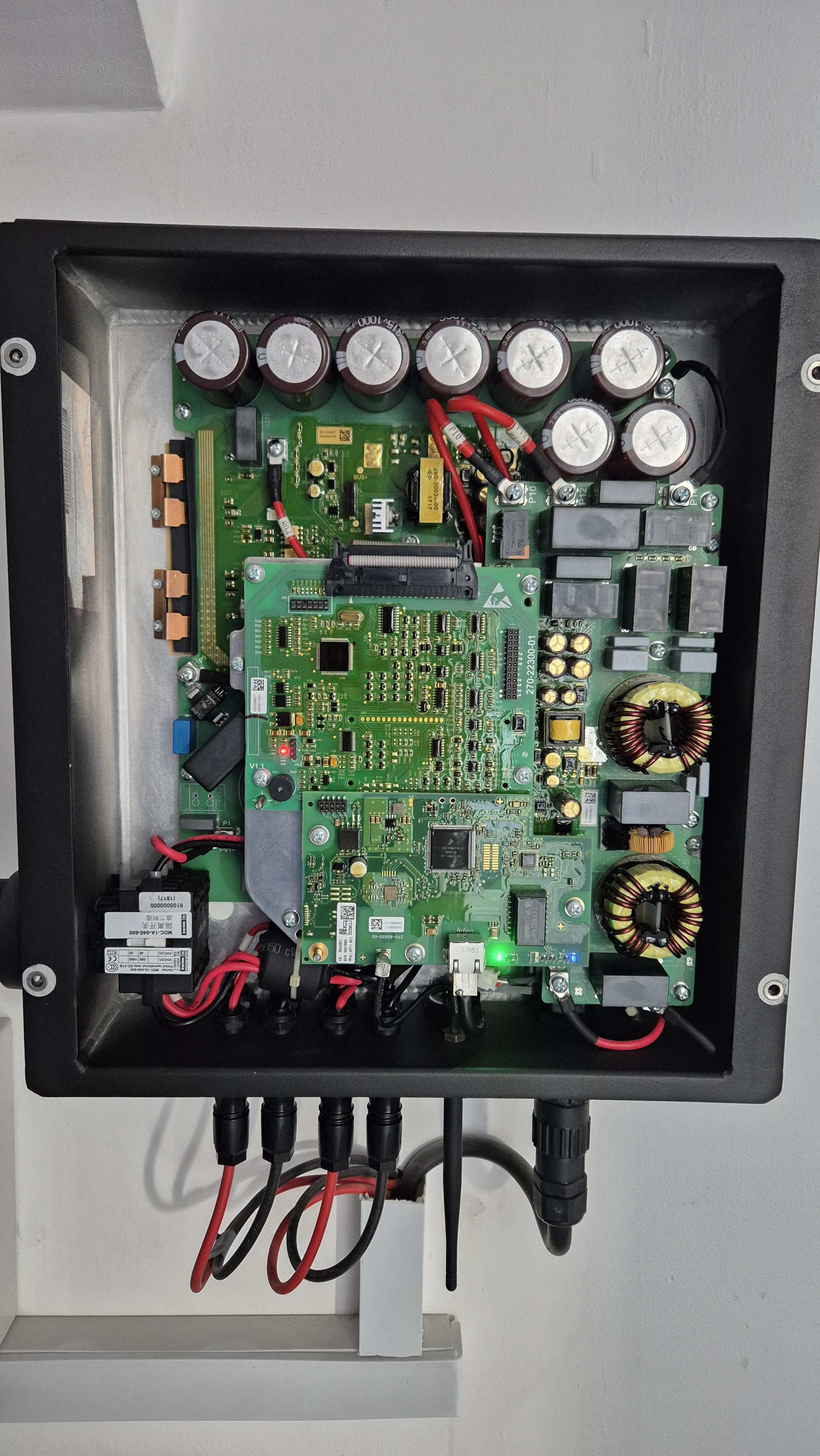

A bit of further info for the discussion. The PV system is mounted on steel frames on top of the flat roof which also has the steel framed solar hot water system, duly earthed as it also contains an immersion system. So the steel frames are also earthed and panels directly screwed to them. The panels are 14 years old, probably had 3 to 4 times the sun that UK panels have over this period. Rated at 30v, the 'good' ones showed around 26v on the day they were measured but the 'bad' ones were indicating 37v. So all a bit odd. Ground earth is flaky out there due to the rocky subsoil and immensely dry conditions. Eg, hasn't rained since April in any amount that did more than lay the dust for 30 minutes. The power grid is also flakey, giving frequent power cuts and brown outs, overvoltage spikes etc. I protect sensitive kit with regulators. As for risks earthing stuff on the roof re lightning, well the normal steel reinforced concrete frame means that the whole building will be effectively at earth potential and although thunderstorms are quite frequent, it is very rare to hear of any damage or fires being caused by strikes. -

End solution. Well I managed to borrow a 2nd hand SMA inverter and plumb it in which proved that the issue was in the arrays. They appear to be leaking to earth. After metering each individual panel, 7 were clearly end of life and even getting an array of 10 that seemed OK, you could measure neutral to earth and see the voltage climb to more than 20v just before the inverter tripped out. So plan now is to renew the array and put in another earth rod. A job for the spring time. -

Hi everyone. I have a Sunny Boy SB3.0-1AV-40 inverter, about 7 years old now, having churned out just over 35Mw in its life. It has 2 strings of 10 x 150w panels each, all due south and no shading. (Location in sunny Cyprus, hence the power generation). I'm now trying to fault find an issue where it is constantly restarting, relay clicking in and out, sometimes a few times a minute. It's not consistent which is also a head scratcher but always occurs from around 9am to 11:30 ish but can also happen at other times too. So far I've found the strings are iffy, panels now some 12yr+ old as previously powered a battery support system. One string is 265v and the other 365v. Plan to sort that out this weekend having sourced some equivalent replacements from a similar system that has been dismantled. £0 so a good find. But, not withstanding the above, further experimentation of running on just one string, it still exhibits the same problem. I've only got basic voltmeter and current clamp and the inside of the inverter is one of layered circuit boards, so very unfriendly. Nothing obvious fried or smelly though. Curiously, the 8 large capacitors at the top of the unit are 4 at 178v and 4 at 0v. That seems odd. Measured simply from capacitor top to ground. Unable to find a circuit diagram, so at a loss as to what else to measure, but beginning to think the inverter is the issue. Oh, no great problems reported on the monitor either. Used to get grid over voltage shutdown but not now, it being typically 240 to 245v. Any ideas?

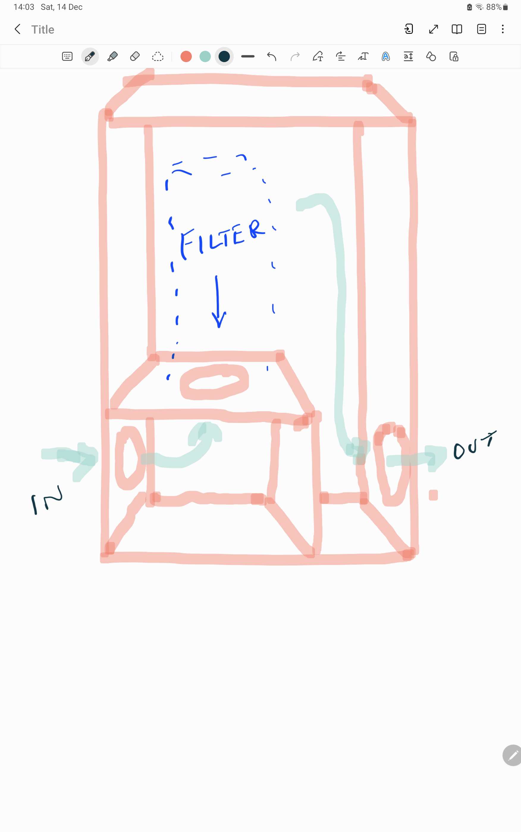

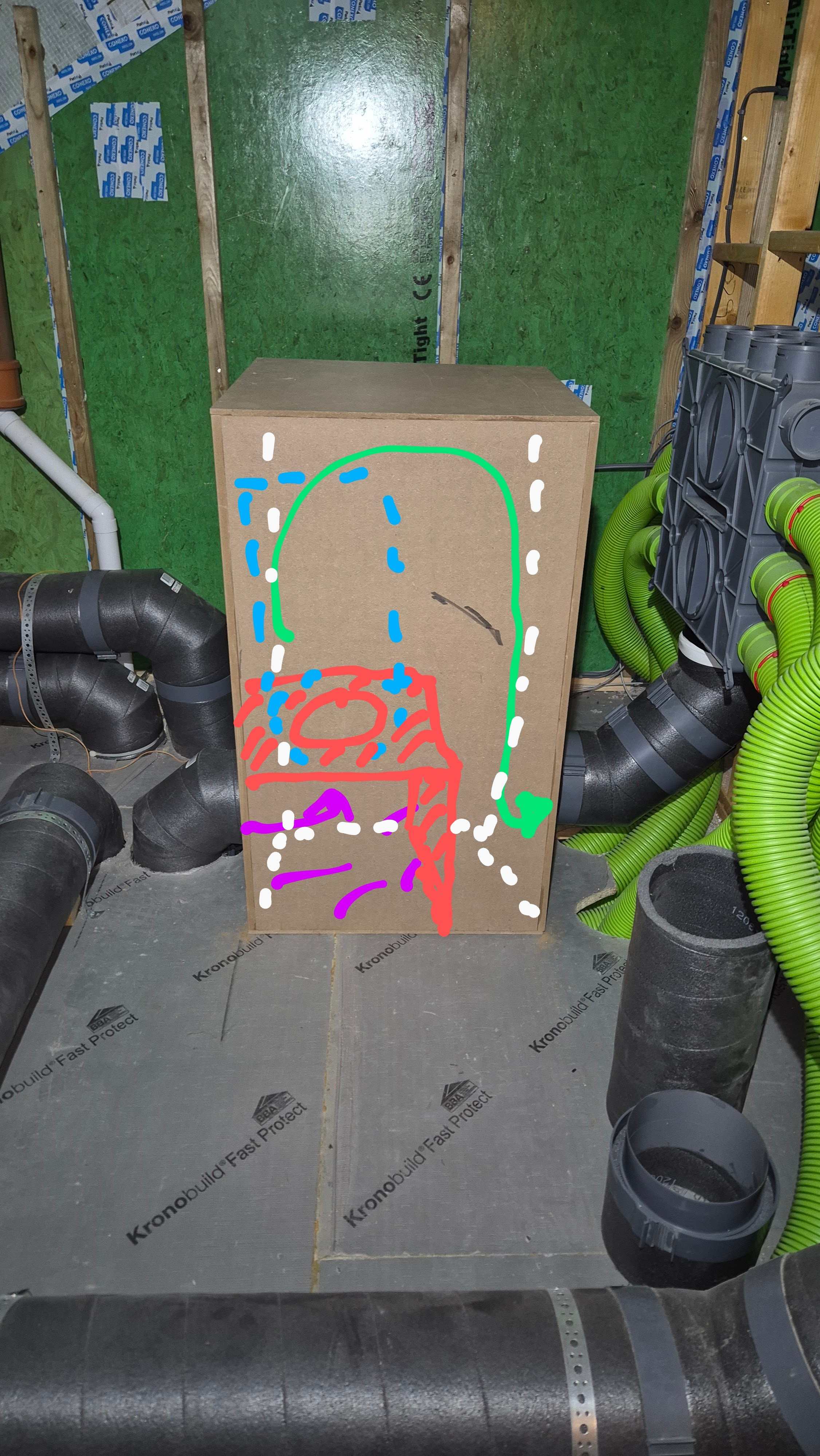

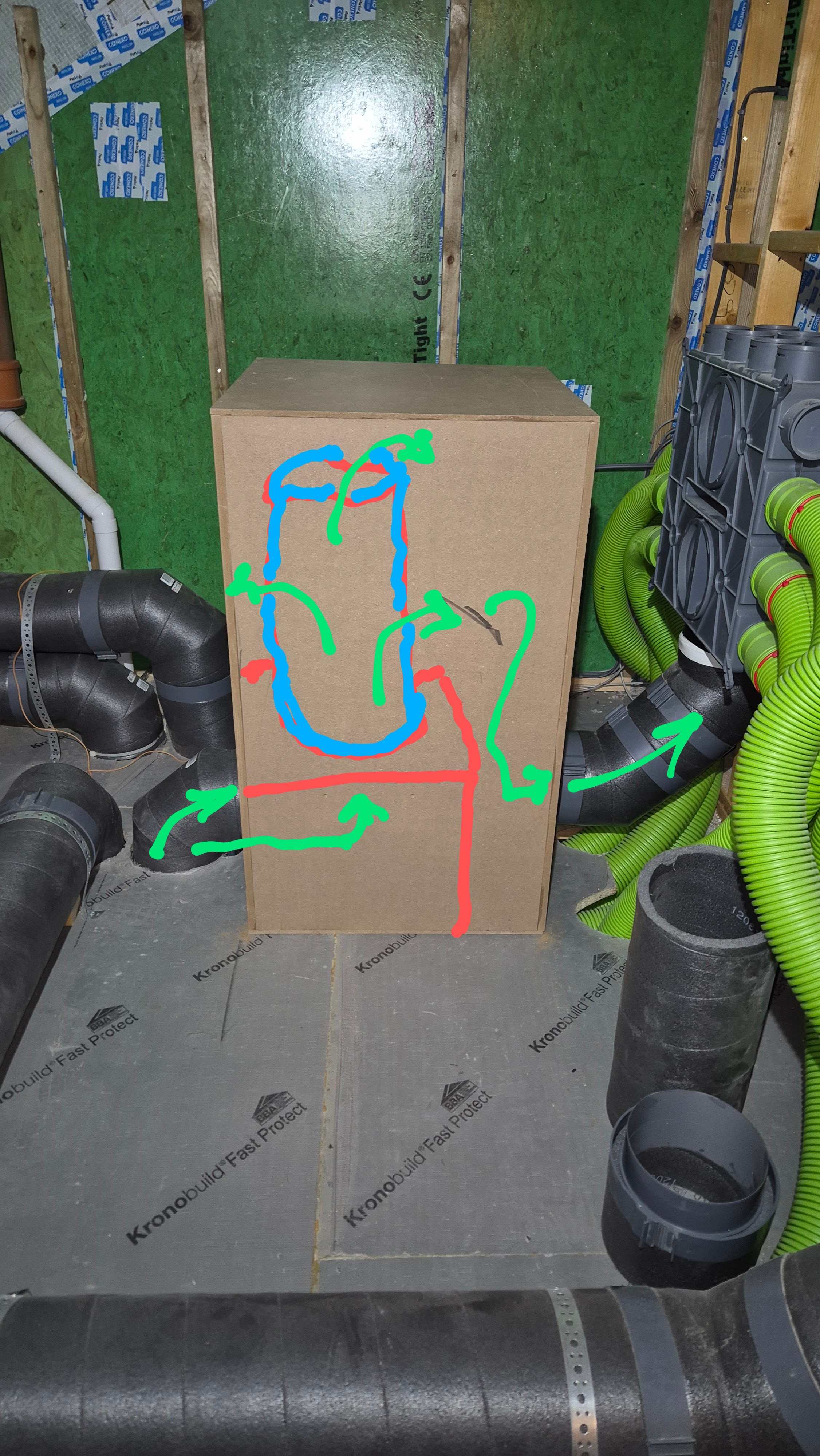

MVHR Active Carbon Filter
Ultima357 replied to Ultima357's topic in Mechanical Ventilation with Heat Recovery (MVHR)
The baffle supports the filter which is mounted vertically, inlet at bottom and gives the airflow route. See picture. The red line is the baffle inside the box, the blue/red the filter and green represents the airflow. Basically the baffle divides the box internally to give separation of air so it has to flow through the filter. It's an L shape. The box is 600mm sq by 1000mm high. Second one shows the baffle inside in red, the dirty incoming in purple and green filtered air. Blue dashes the filter. The white dots the inside edges of the box. -
Hi. My system pumps from the unit into the bottom of the box containing the filter. The filter sits above this on a baffle board, so the air pumps into the centre inlet of the filter and out the exterior of it. Then flows around the box back out to the manifold of the mvhr for house distribution. My neighbours love bonfires and this copes fine with them. Ditto the occasional smell of the countryside from muck spreading etc. So effectively I have a large box with a smaller box/baffle inside at the bottom which acts as a duct for the incoming air into the filter. If it doesn't make sense, let me know and I'll try and draw it up and post it on here. -
