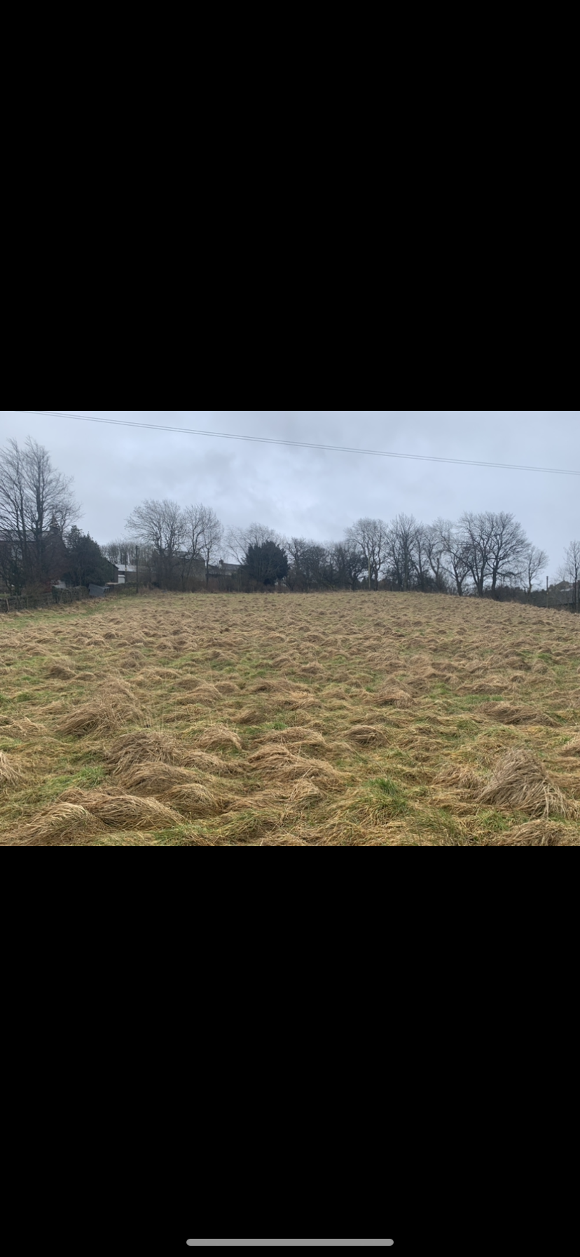

Using google earth, height difference between top and bottom of site it’s actually 7* if that makes a significant difference.
thanks for your patience, new at this and just working stuff out. I’ve crudely measured our site at around 5* or 10%. So for every 10m it reduces by 1m. is this within bounds for passive raft insulated foundation of about 75m2 (10x7.5m) Obviously with excavation and sub base layer and formation of some sort of retaining wall. If ground conditions ok, would this in theory support block inner and stone outer leaf? 2 storey pitched roof thanks
