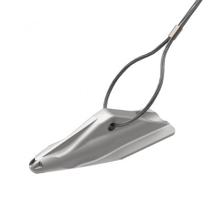

was thinking of ground screws as a foundation but then thought of sitting the mobile home on peers and using anchoring points
I was looking at ground screws but the ground is glacial till under the top soil so that seems liek a no no. have you used them before?
Ohhh thats a really good idea. love chatting on this forum. thanks for the info
Thanks i am thinkig of just laying a slab, but i have come across these as its a high wind area such as the gripple anchor?

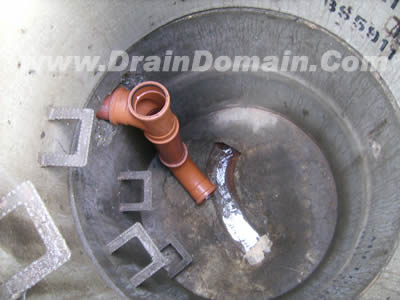

Oh thanks for that, i think as stated earlier i will negate the 160mm pipe connection and get an approved contractor to connect to the man hole. It is a steep learning experience!
Ah thats a shame, well i shall stick to doing teh excvations and connnecting all the pipe work, thanks for the info
Yes its in the ground. i thought mayeb something like this would reduce the amount of excavation needed. Its a pretty straight forward connection. 600mm trench. 1 in60 drop straight to the manhole
Thanks, what would be the easiest way to compete the task? is an internal drop still viable?
Hi all, what would you recommend as to the most effcient and easiest way to connect to a 160mm pvc maiin with a 110mm soil pipe that complies with water board inspection critera? a link to a product would be great as (a long time aago for me) i think we used saddle connectors but i assume tech has changed but then old is gold! Thanks all Regards fiaraz
Good morning all. I am laying a new soil pipe system and i would like to know what you guys would prefer to connect to and why. I have the choice of 160mm PVC pipe or a manhole? Thanks in advance. Regards fiaraz
