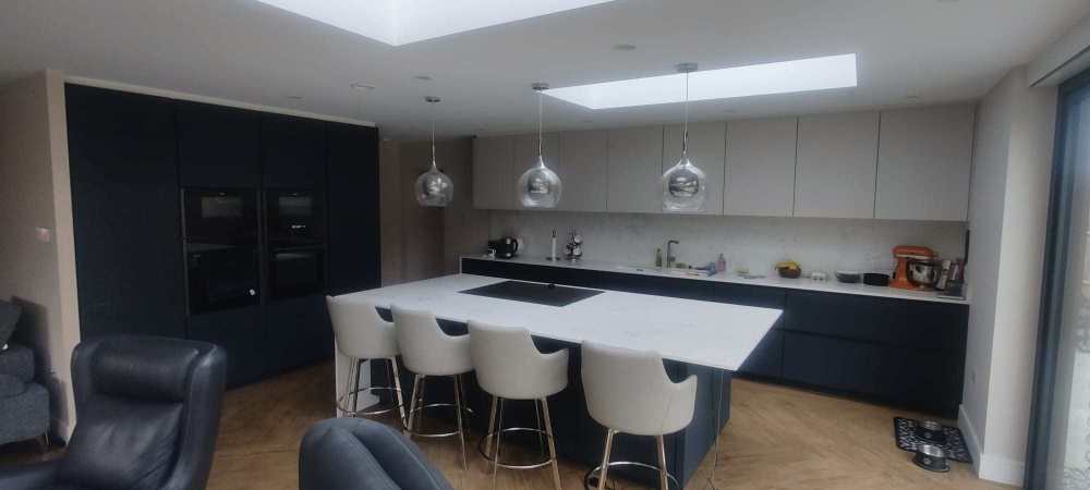

A modern glass induction hob is less than 5mm thick. I admit that a flush fit may look a tiny bit better but I'm sitting here looking edge-on to my island hob and it isn't exactly unsightly (unlike that glass gas monstrosity above) I would suggest that the astonishingly marginal benefit of easier cleaning is vastly outweighed by the cost and complexity of the install, plus the risk of a replacement not fitting correctly Regards Tet

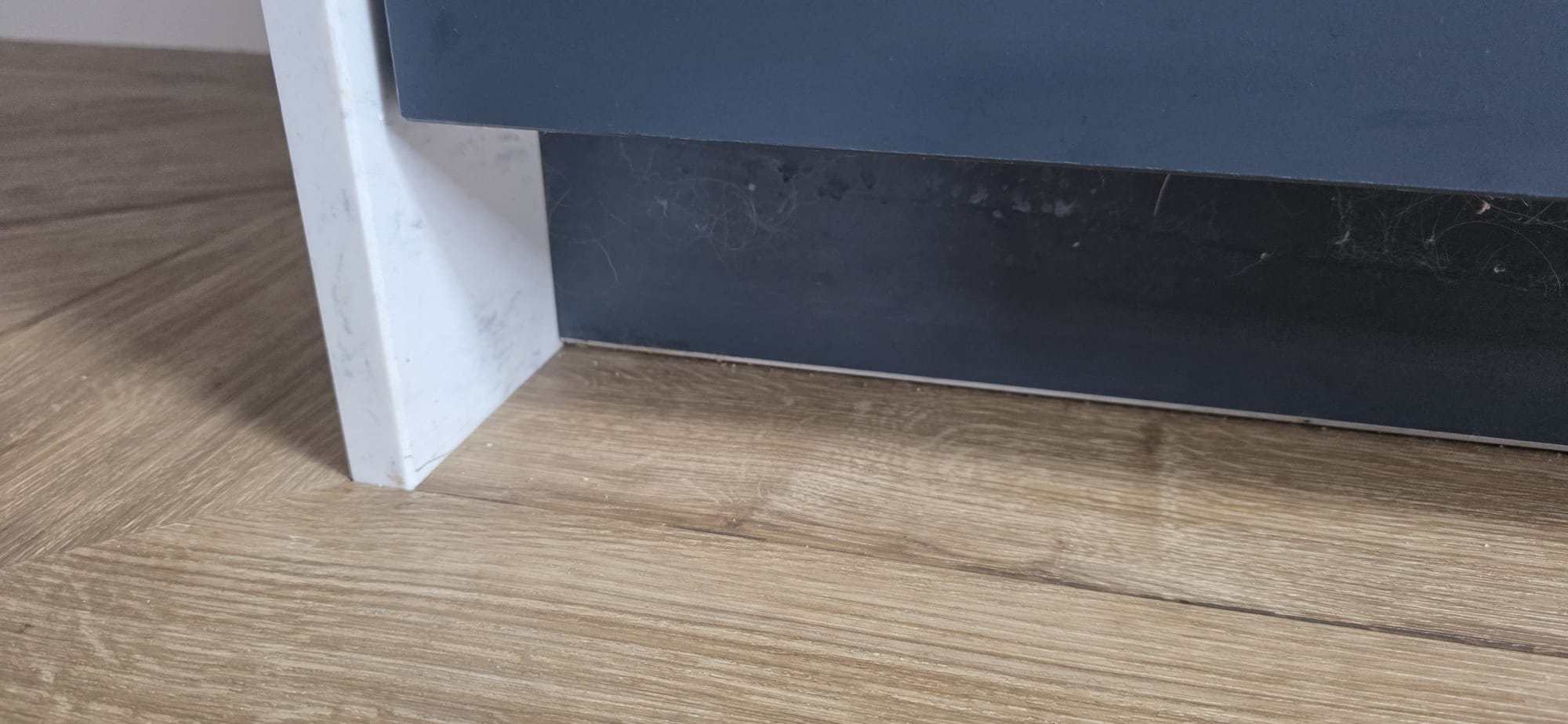

This finish is very common on high-end kitchens. it is a full floor-seal and makes a very tight and effective seal to the floor. Ours has been in nearly 2 years and is absolutely fine. Even with a major spillage (dropped bottle of red wine) it didn't let any spillage through and was easy to clean afterwards I much prefer the aesthetic of a recessed compression seal than a plastic stick-on channel that you often get in B&Q etc. From a practical point of view the alternative is an exposed mdf edge that will soak up any liquid, whether spills or when being cleaned Ours is below Regards Tet

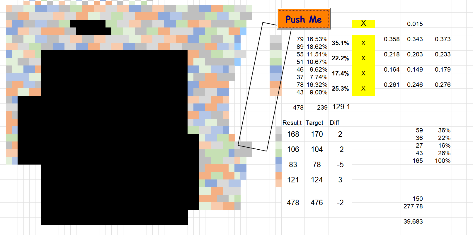

I built a randomiser spreadsheet using the RAND function to cycle through weighted combinations until I found one I liked for a mosiac tiling project. The way you do this is use numerical values for each cell and then ascribe a different conditional format to colour each cell. Every time you calculate you get a different pattern. I just cycled through until I got a weighting that closely matched the number of tiles I had. After each run they were all random, but some just looked "wrong" so I just ran it again until I had one I liked I resurrected it for my porcelain tiles. I had only four different designs, thus eight different tiles if you include orientation. I then labelled each pile of tiles A-G and gave my tiler the pattern, then it's an instruction, not a guide Regards Tet
