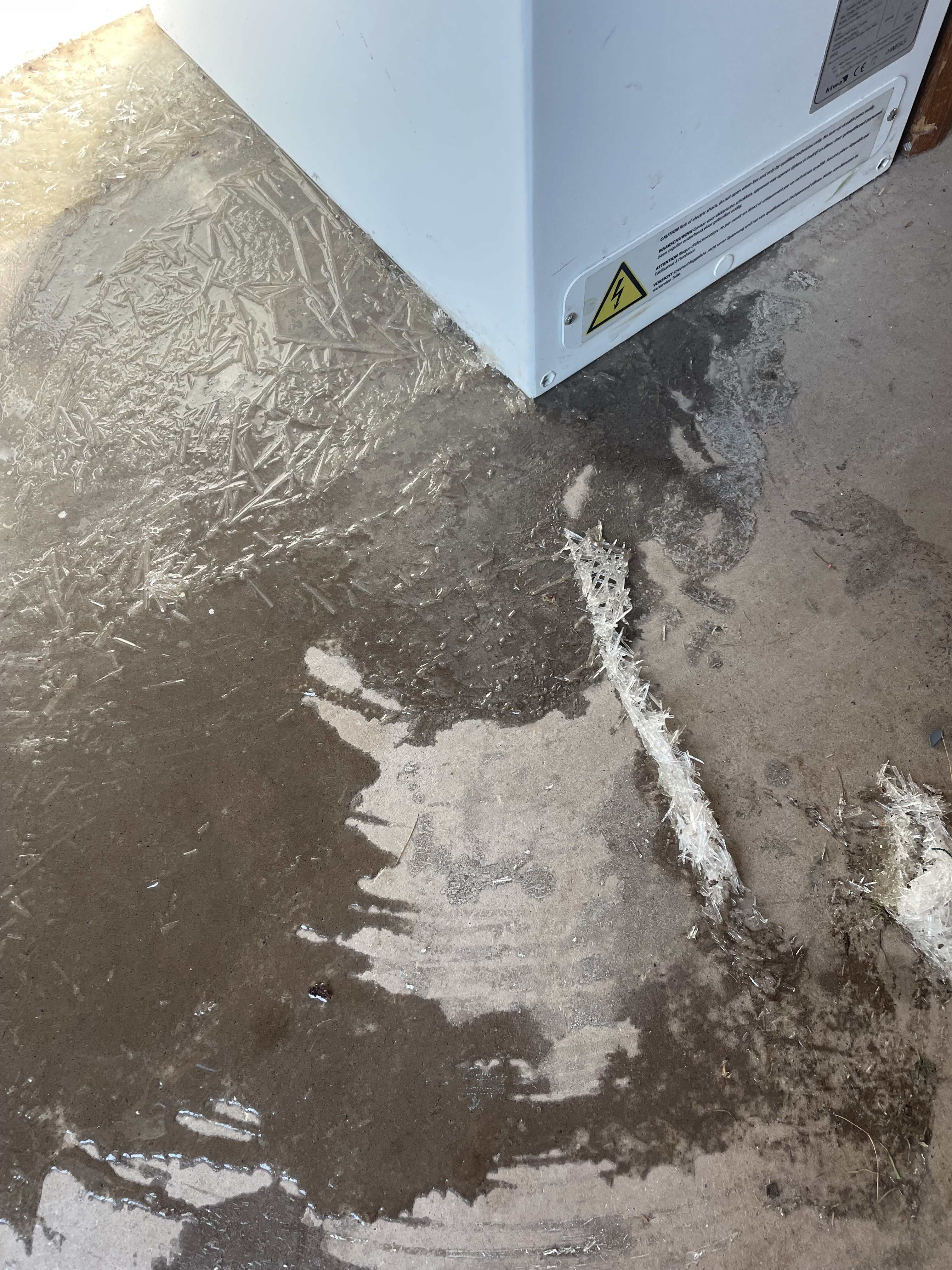

  3. This 9kwh Sunamp has just leaked onto the floor leaving salty residues. Happened last 3 nights It was installed in 2019. Working fine since then, charge overnight and via solar panels. We still have hot water but presumably if it loses more of the salt this will end Sunamp, have asked us to fill in a form and we're waiting for them to get back to us. How urgent is this? Don't want to be hot waterless. Is there any hazard from having this stuff leaking onto the floor (luckily it's downstairs onto a concrete floor)

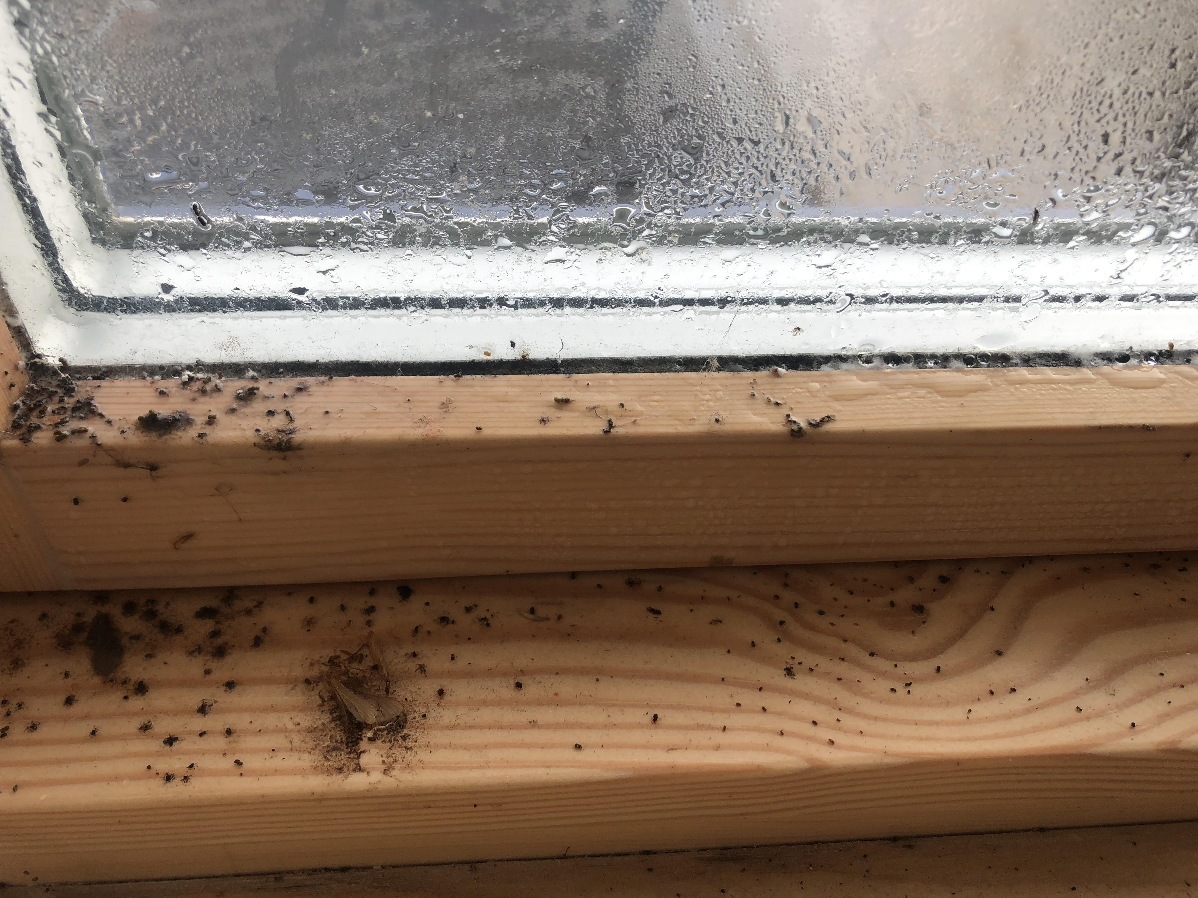

  4. One of my triple glazed Aura plus windows appears to have failed. Condensation and water pooling within one of the spaces The distributer I bought them through 7 years ago appears not to exist anymore. Rationel have agreed to replace and supply an engineer but want me to pay for scaffolding etc Where do I stand here legally. Natural justice suggests they should pay all the costs of making it right if fit fails within warranty or a reasonably short length of time (for an expensive window!) What do people think?

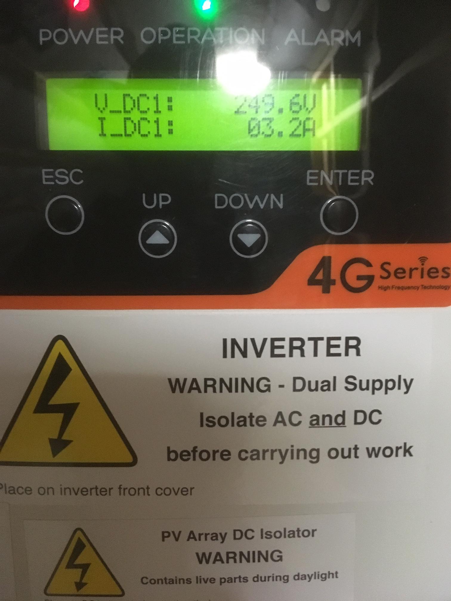

  6. Hi Steamy Tea, It's a; PV-I-SGL-6.0-SP Solis 6.0 Single Phase with DC ( 110AD0183150020 )
  7. There is not any tree shade on the panels except earring in the morning when the Sun is low. Sorry the info provided is inadequate. To be fair my original post was to try and find for an expert who could do a site visit. It's a complicated problem with a few issues and I wasn't expecting folk here to fix it easily.
  8. They might be and I laboriously noted the numbers on the back of each one in anticipation of registering them on an app. They have "tigo optimisers" which were supplosed to correct probs with performance due to shading etc. You can moniter this if you've registered/set it up, though I wasn't led to believe not doing this would adversly affect generation. There was a complication in that they needed some kind of gismo in the loft which needed another electicity supply to run so I elected not to bother with any of that (I tend to avoid unnecessary complication/tech) and I was told it wouldn't make any differnce to performance.

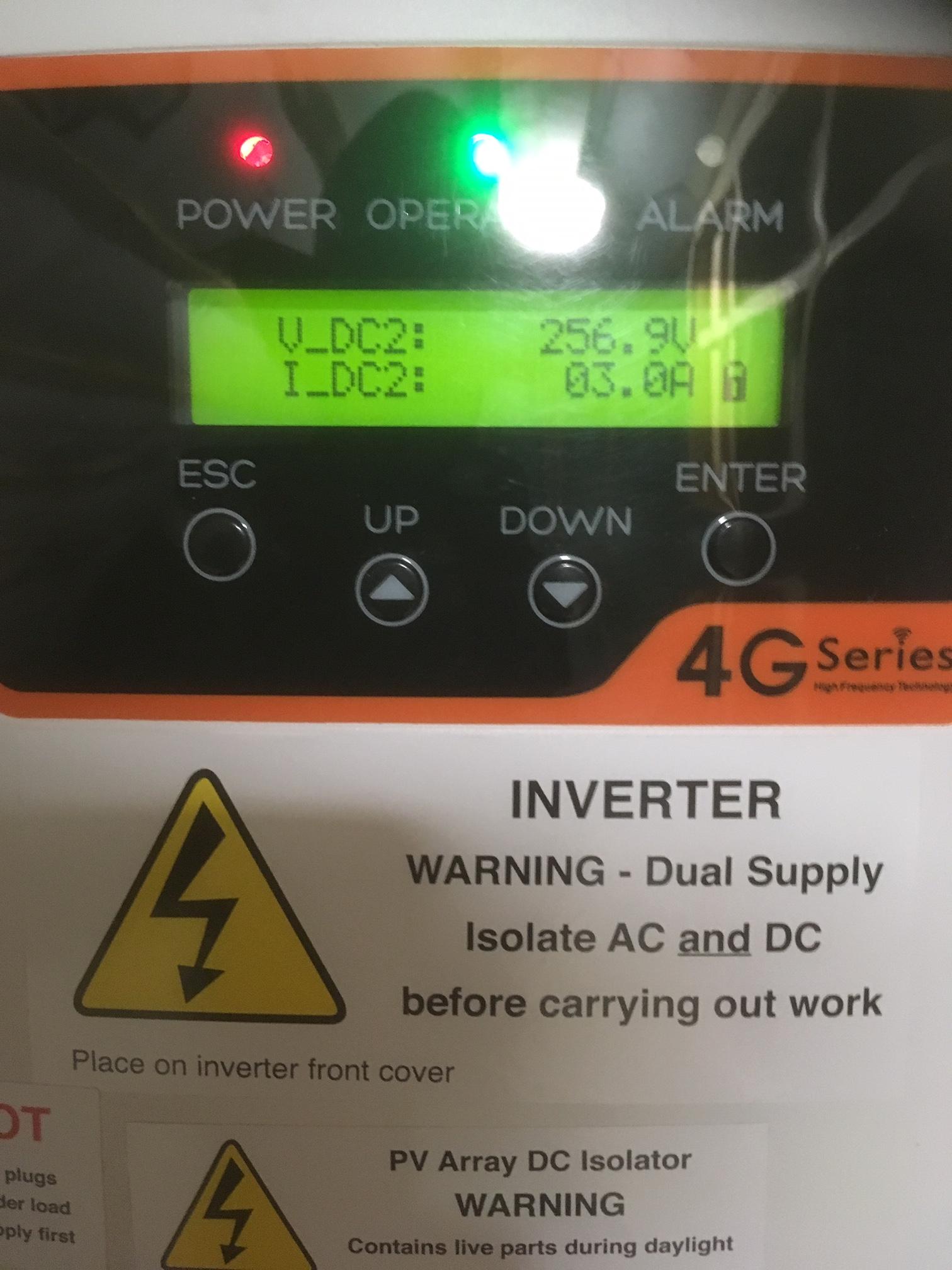

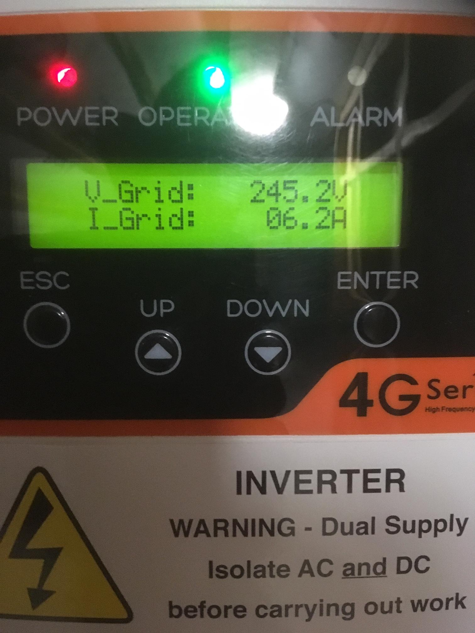

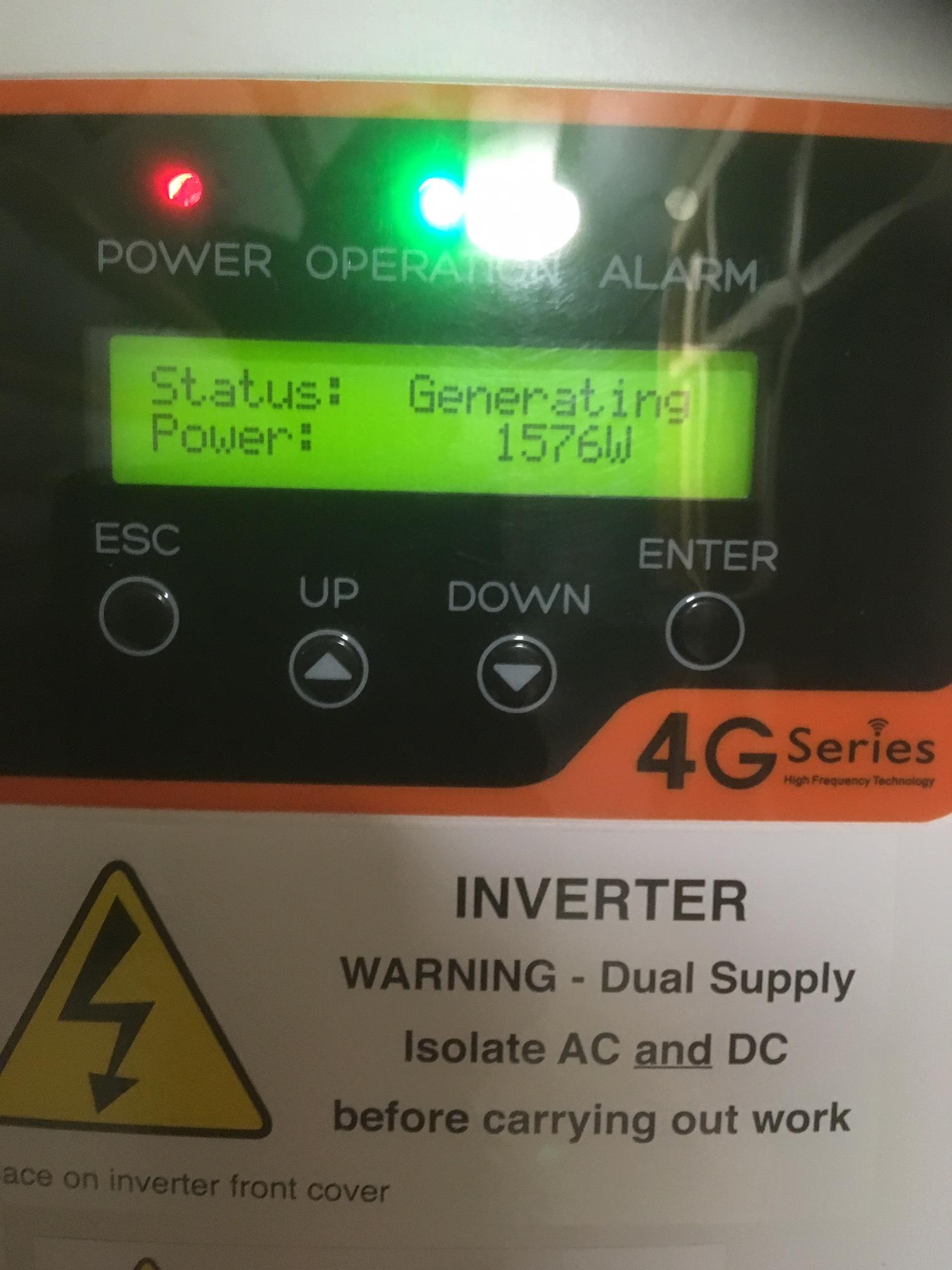

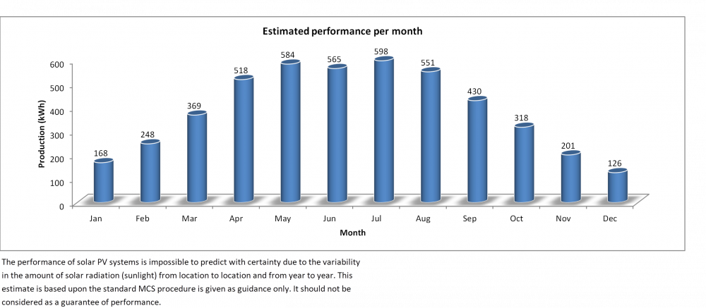

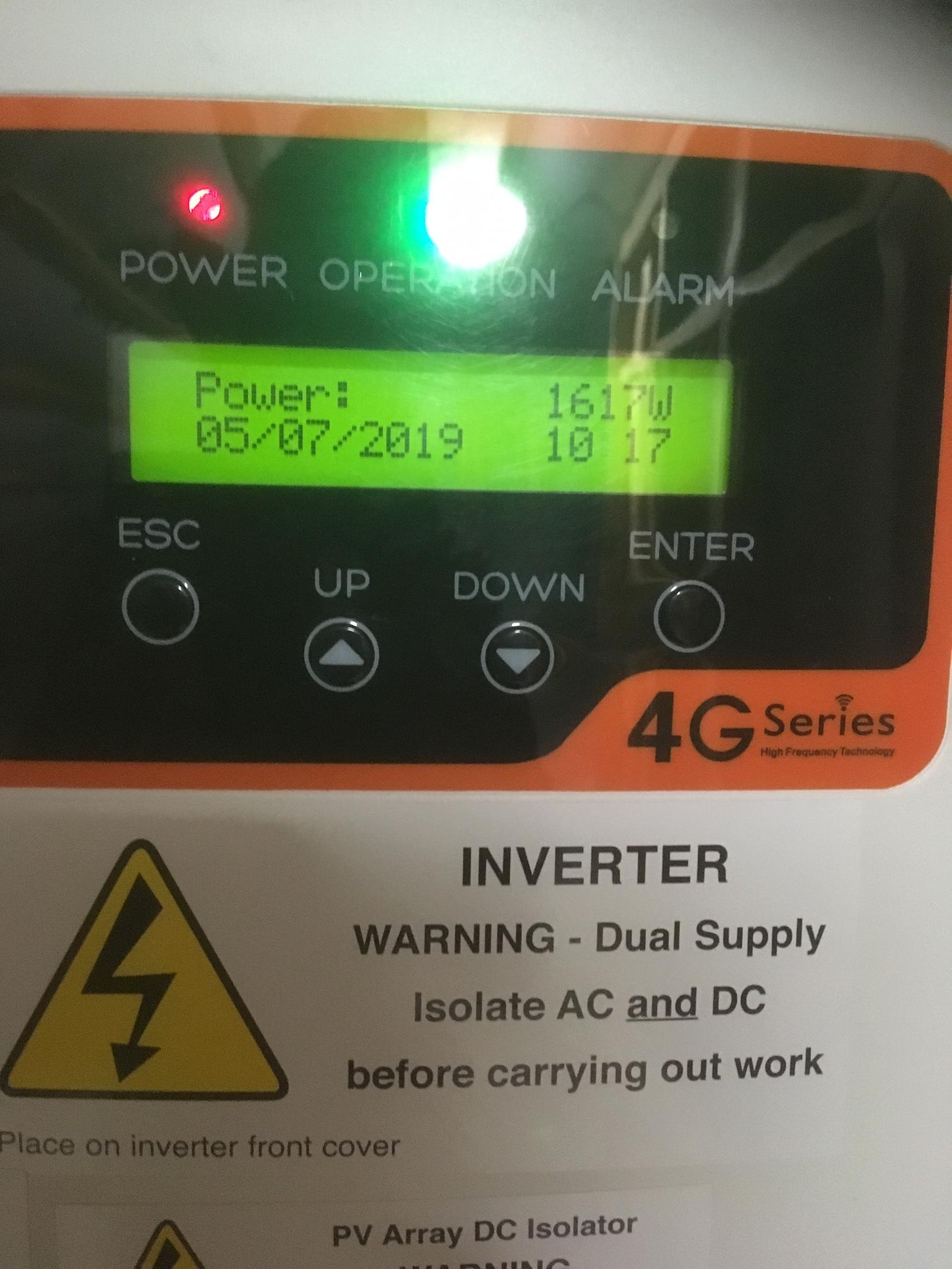

  9. I mechanically installed the panels, (Jinko Tigo 260W Smart Module with Gateway) 2 sets of 12 in series and connected up all the wires and ducted them through the roof. The folk who installed the inverter tested them and said they were fine, both sets generating. This was 2.5 years ago. They should potentially generate capacity of about 6KwH shouldn't they? but in full sun have only ever produced 2.8 (confromed on the inverter, the eddi/harvi/zappi thingy readout) Excess goes into a 9kw sunamp and electric car. It never fuses when the circuit with the solar panels/inverter on it is switched off. I agree it sounds like a water ingress issue which is a bit dispiriting as I was very careful to avoid this when I installed it. I'm not an electrician or a solar installer and I think I need someone experience to get up and "have a look under the bonnett" The original installer did come back and did some calcs and sent me this graph which I think confirmed the output but didn't explain it (it may be my expectations/understandi are wrong). either way the fusing problem persists so I could still do with someone to have a gander.. Hi Dan, Following my site visit, I have now run my measurements through the standard MCS matrix to calculate your overall power generation. Having measured the shading and applied the additional coefficient due to the proximity of the tree to the South East, the following graphic show a realistic generation that can be expected from your system under the current conditions. You should be able to compare the monthly projection against the accumulative figure on the Solar Generation Meter to reassure yourself that the system is working correctly. Kind regards

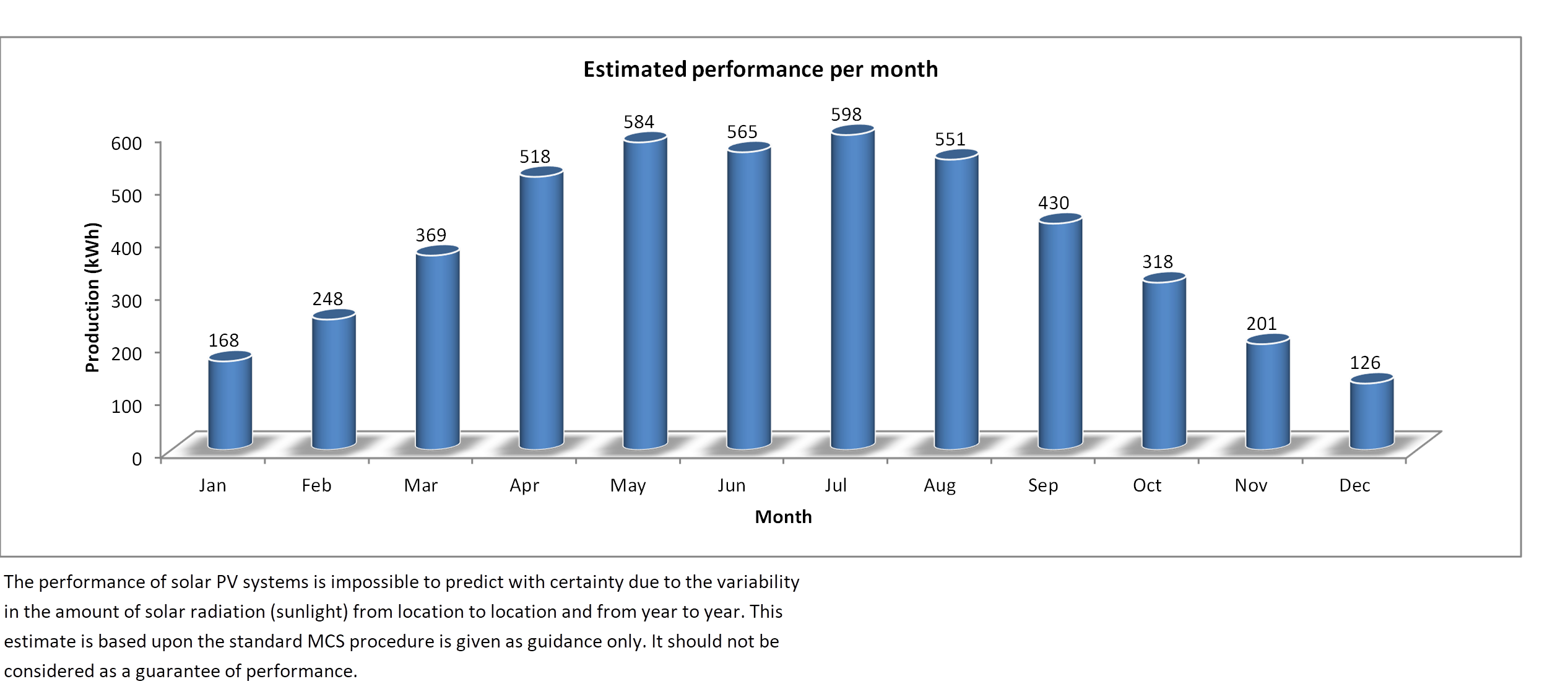

  10. Can anyone recommend someone in the South West (Bristol) who could review and test my solar PV system and advise on installing storage batteries. 1)I have an allegedly 6Kwh which has never generated more that 2.8Kw/h despite being well situated, shade free etc. Installers couldn’t really explain this and did some tests ultimately fobbing me off, this was over 2 years ago. I may just have unrealistic expectations. 2)There is also an issue that the fuse trips in windy/rainy conditions when the solar circuit is switched on. Never when it’s off so something’s amiss there. I installed the panels but not the inverter etc. 3). I’ve got room to install another 12 panels all if this would be worthwhile, though wouldn’t bother if the existing ones could work at closer to predicted 4) would like advice on battery storage to be coordinated with the Sunamp, electric car Eddi/Harvi thing which should hoover up surplus PV in summer and also be charged up by the cheap Octopus plus 4 hours and then used to supply house the other 20 hours. Hope that make sense? I’ve had a couple of leads but struggling to get anyone to visit!

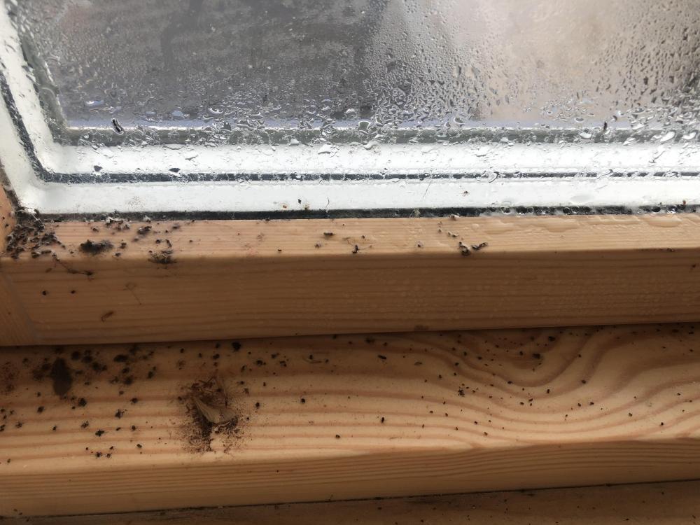

  12. We are currently in our second winter in the house. MBC passive house with MVHR Two of the triple glazed casement windows appear to have significant condensation problems. One is in a bathroom (with good air extraction) and the other in a home office. I've just written to Rationel aftersales support but after previous problem with a faulty door locking mechanism, I'm expecting an initial brushoff. Do folks feel this suggests a particular failing in the window?

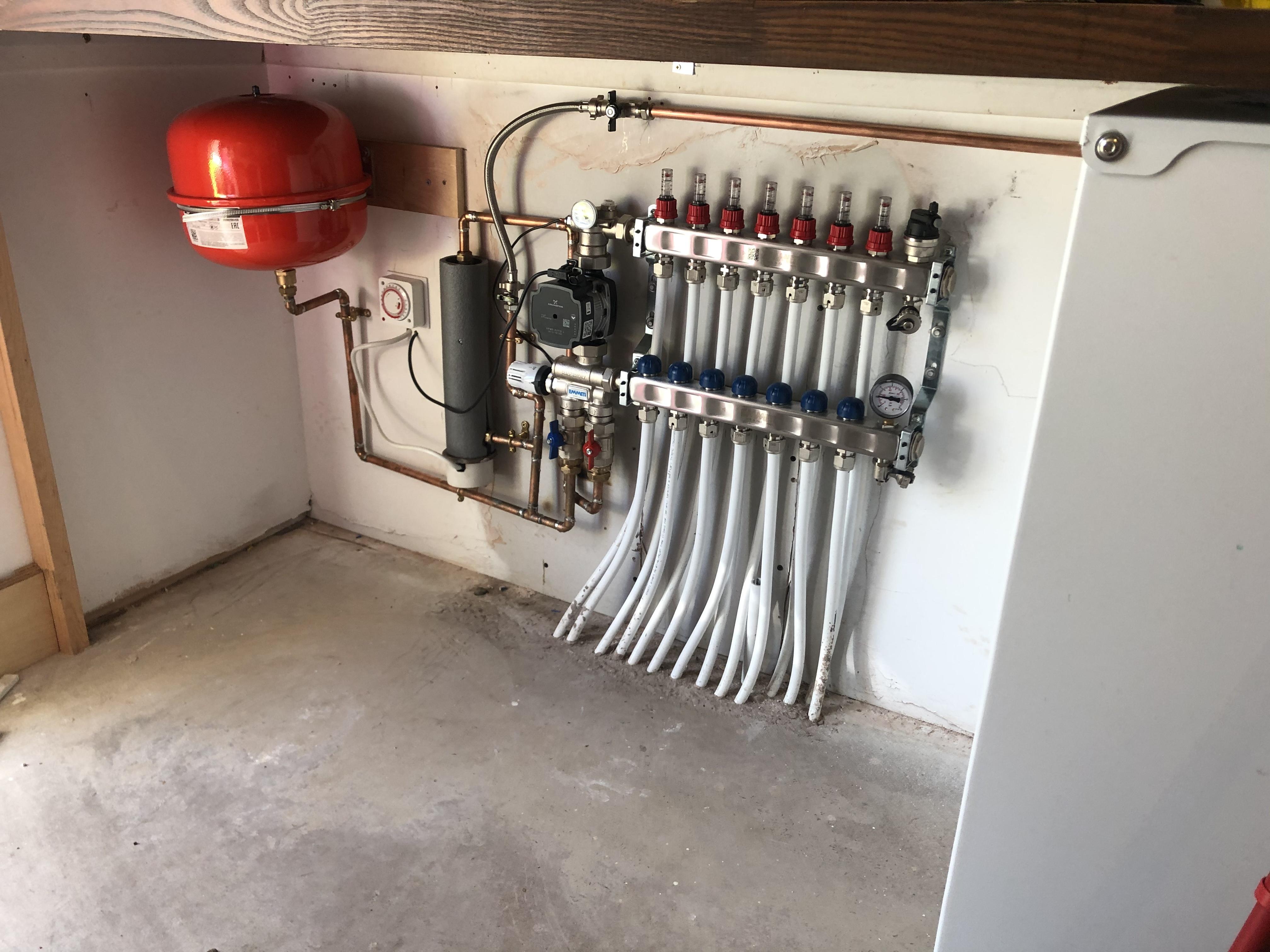

  15. Thanks for input everyone. I’ve got it up and running with a Willis heater off amazon (labelled “Tesla” rather unexpectedly) and a cheap mechanical timer. The manifold + pump was the main outlay around £400. It took about 3 days continuous running the get the slab up from 18 to 25deg. Now I’m running it only from 12.30 at night till 7.30am when I get cheapo electric. The floor doesn’t feel “warm” but it no longer sucks the heat from your body when you walk on it and everyone’s stopped moaning. The house feels remarkable warmer! Temp is hanging around 20deg. Here’s a pic. All the gubbins is under the counter in the utility room next to the Sunamp

  17. I recently posted about running my UFH using a Willis heater. Plumber on board with this in theory but hasn't encountered before. We were wondering if it'll need an small expansion vessel? Shopping list so far is; Manifold Grunfos Pump Willis Heater Timer.

  24. We're in our second winter in an MBC timber frame house. 5 bed, 4 kids. 240m2 approx It has UFH pipes installed but I experimentally haven't connected them up. I think it's OK (with thermal longjohns etc ), but some of the less robust members of my house feel we need "proper" heating. It was 15 degrees inside this am (-2 outside overnight). We do have a plug-in panel heater which will warm a single room quickly. We have a 9kW Sunamp unit which supplies hot water. This is mainly charged by solar PV. Question; Should we connect UFH to the Sunamp? Obv this will greatly increase drain on it and it'll need more topping up from the grid. Is it worth getting an ASHP? I have left penetrations through the wall for one. If so would this heat the Sunamp more efficiently than grid, or can it directly connect to the UFH? Or would it be most expedient just to get a couple of extra panel heaters on smart timers? I'm reluctant to spend many Ks and get my head round yet more technology for the sake of a few degrees or saving a few quid. Is another big mental and financial outlay worthwhile (sorry for a rather subjective question) Dan
