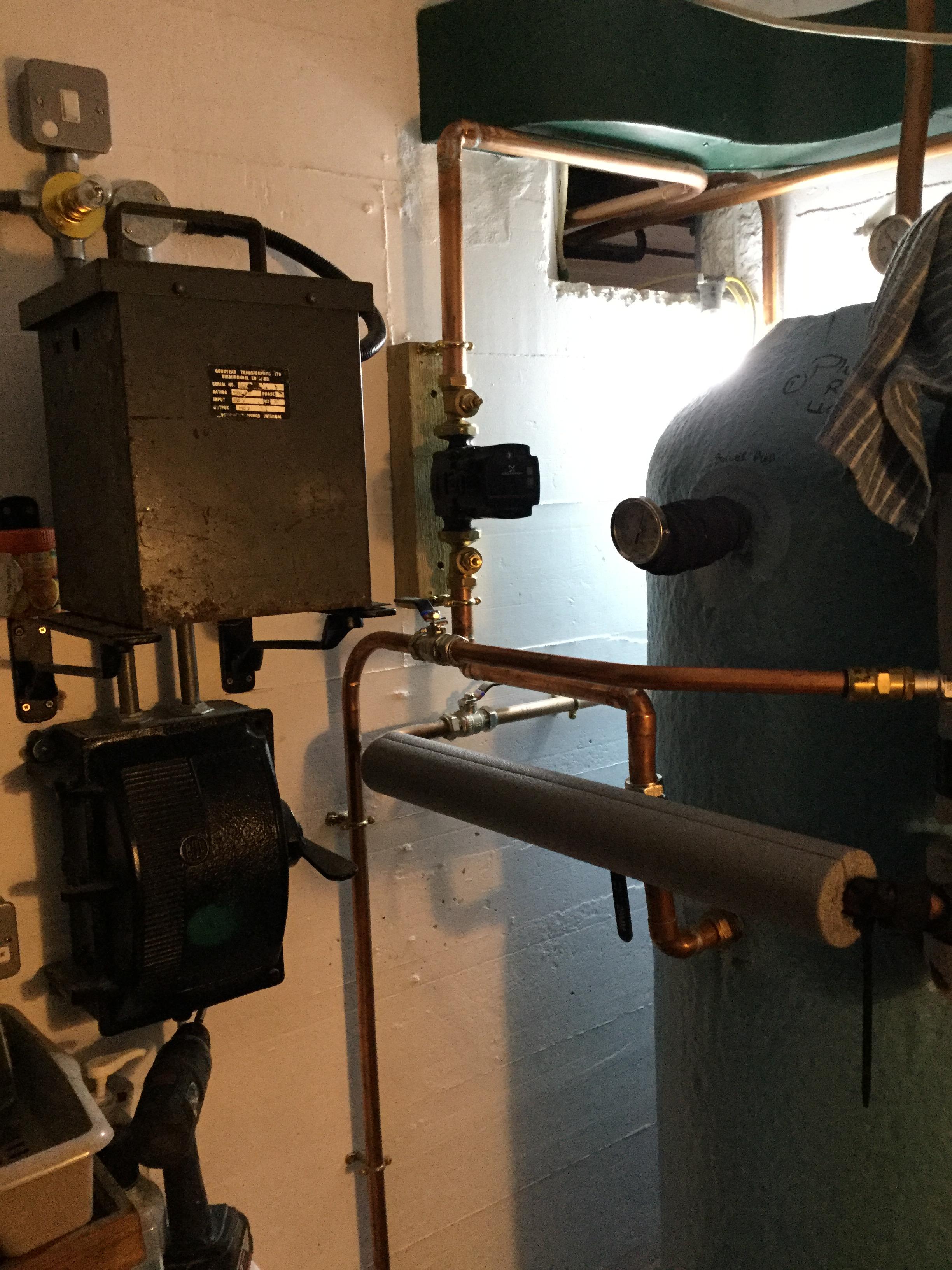

The TS has an expansion tank via the loop from the Rayburn (it has a bleeder just for the top of the TS as well), after a bit of experimentation and advice from a couple of aged plumbers the gravity loop system came about. The problem was that the TS and Rayburn were on the same level so how to make a gravity feed work? But the solution works fine but I had to mount the expansion/header tank a lot higher than the system, which it is. I’m just in the process of building a control panel to run the central heating and include the fail safes but the gravity feed system takes care of itself rather well. I’ve done the unvented system course and work on heating and ventilation systems in supermarkets etc so am aware of the dangers of unvented hence I went down the vented TS route, plus it works well with the off grid nature of the place. -

Ah, the thermal mass is the concrete (18” thick walls and roof and 4‘-5’ thick in the floors) the whole place is then clad in 1”-2” thick bitumen cement and buried so the earth/aggregate thickness is between 6’-20’ thick. I have blown air heaters feeding through the original cable ducting about 3’ under the floor which keeps things ticking over at 18 dec C (a system used by the MOS when building underground factories) but I would like a second option to heat hence the radiators. The original system (now out of commission) was a 9kw blown air system at ceiling height and the original radar equipment in the place would have produced a lot of heat (it had a HV substation to feed it all due to power distribution distances). The walls and floor hold a steady temperature. I can’t line out the building as it will destroy the original features but it was designed to hold sensitive equipment so it is very dry (bit too dry tbh). I was thinking along the lines of a flow and return pipe and tap off to the rads so I maybe going the right way. On the plan the Rayburn is by the dotted square in the filtration room and the thermal store is in the room below, I’ll get my measuring stick out but the big receiver room is 7 mtr by 5.8 mtr to give you an idea of scale. -
After a bit of advice here regarding best radiator feed system to install on my system. Let me explain (sitting comfortably then I’ll begin), my system is completely off grid but I don’t like being cold and I have a reasonable size property to heat (about the size of a 3 bed bungalow with very good thermal mass and insulation). I have original cast iron radiators around the place of which there will be about 9 maybe 10 in total, the system doesn’t have to react quickly due to the thermal mass but it does have to disperse the heat from the Rayburn (solid fuel) as it has a high capacity boiler and can heat the thermal store (300ltr) rather quickly. The Rayburn is feeding the thermal store via a gravity feed system (all on a single floor but it works well). I’ve installed a flow and return from the thermal store (pumped) but have only just got out into the main property so I was wondering what system of pipe work to install ? The place is rather solidly built and I’d rather not drill holes I don’t have to. The main pipe work is 28mm copper surface mounted with brass mountings (not that that makes a lot of difference) so I was also wondering at what length do you start to think about expansion loops or the modern equivalent? Cheers.

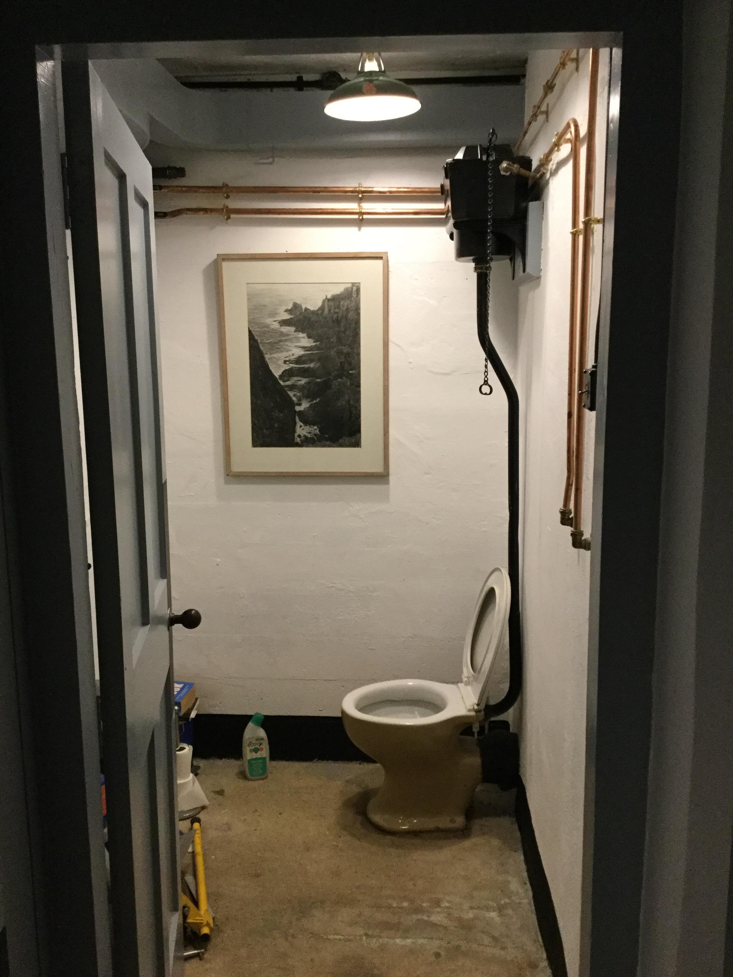

I bloody hope not, I refixed that after having it powder coated and I rebuilt the mechanism. Bomb proof and it’ll flush anything. I do need to fit the wooden seat.

The original sewers are still fine but the tank system was getting a bit tired (it collapsed when the farmer dumped a few hundred tons of rubble on it) so I’ve installed a bacterial bubbling sewage treatment thing and used the original soak away which was for the separate latrine block for the workers outside. Still got the original toilet. The bunker and latrine originally had 3 soakaways so decided not to fix something that has worked fine since 1942.

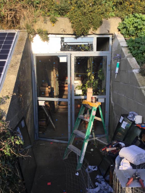

I suppose it is, I will say the place is very well built 18” thick walls and roof and 5’ thick floor of reinforced concrete made with blue elvin aggregate so drilling holes is fun. It’s built into the side of a slight slope and filled over to a depth of about 3 metres. I have no damp issues (before anyone asks) and it is nice and warm with minimal heat input, I have supplemented the original gas seal doors with custom made full glazed double doors on the entrance tunnels. It’s about the size of a 3 bed bungalow but I have it set up as 2 bed with kitchen diner (only me and the dog). I’m slowly restoring as many of the original systems as possible and subtly building in suitable systems to make it comfortable living (all very much work in progress). Externally I have a Nissen hut which is my workshop and some rather nice original features like paths and anchor points for masts etc. I am a bit of a tech idiot so have no idea how to post pictures on here.
