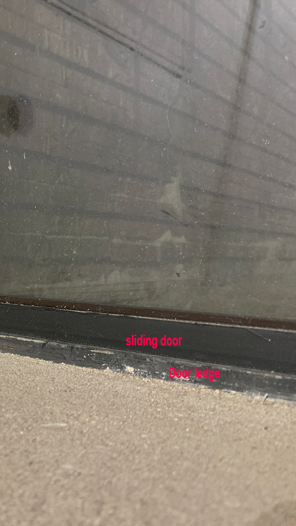

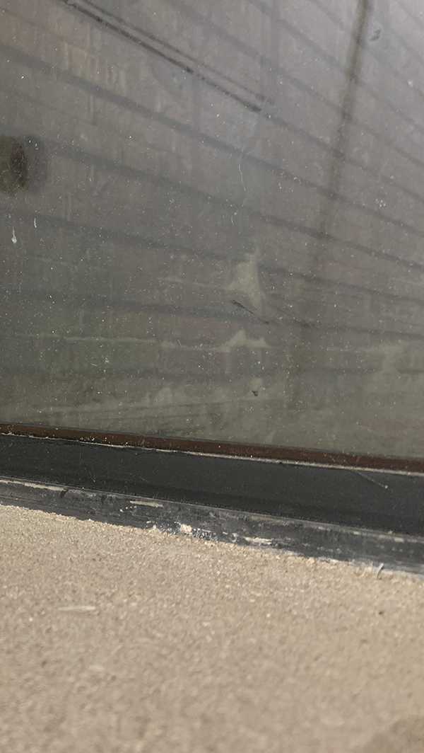

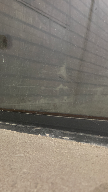

Aha yea, i was planning on that too. So..... any advice on what 12mm, 10mm etc would bed to - that would be welcome. I know I shouldn't but I might have no choice but to go for shallower bed..... it is tight. Below is a pic of the floor and the door ledge. thanks, Neil -
Hi all, I have some 10mm tiles (1m x 1m) - so they are large. I believe i should use a 12mm adhesive base. Things are a bit tight - as the door level is about 20mm...... In any case, what would you expect a 12mm adhesive bed to go down to once the tile is placed? 8mm? (meaning my total circa 18mm). I'm using a large format adhesive, lightweight I believe, COBA 140 (not sure if this brand in UK - I'm in Amsterdam). Hope to hear, thanks. Neil

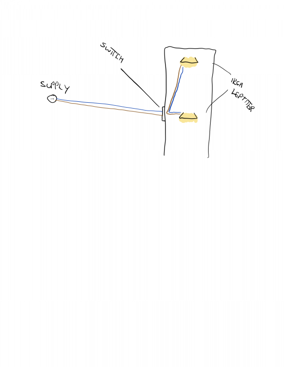

hahahah - thanks Nick; tested it out yesterday following Tony's post -(daisy chained - as the lights hat fittings for that) and worked great. Still alive ? Electrician will finalise it though.

Thanks Tony - very helpful.

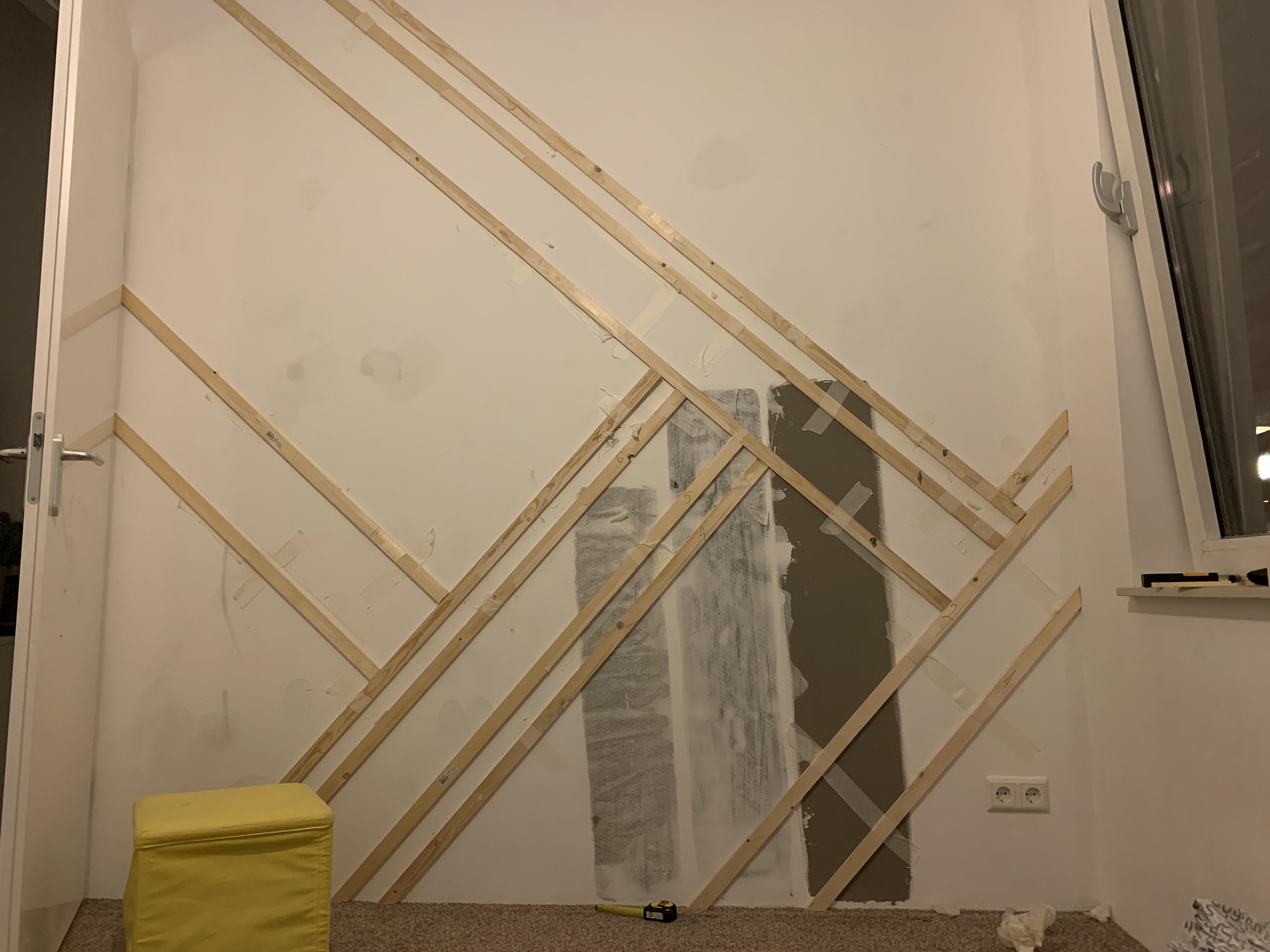

Hi All, We've made a small design from some wood slats - and want to attach to wall. See image below - just temporarily stuck with tape. The wood is quite thin (circa 2cm thick) - and I want to avoid splitting it. The wall is not plasterboard and not solid concrete - its a combination of these sort of light /white style bricks inside (sorry, don't know name - they aren't load bearing bricks) - and then a layer of plaster. I don't have a nail gun (would be my preferred method). I think next best thing might be to pre-drill extremely thin hole through wood and wall, then counter sink some flat headed screws (i'm ultimately just trying to avoid splitting the wood). However- curious to hear if there are any better methods you advise? Bonding to wall is another - 'no more nails' type approach -but could get quite messy. Hope to hear, Neil

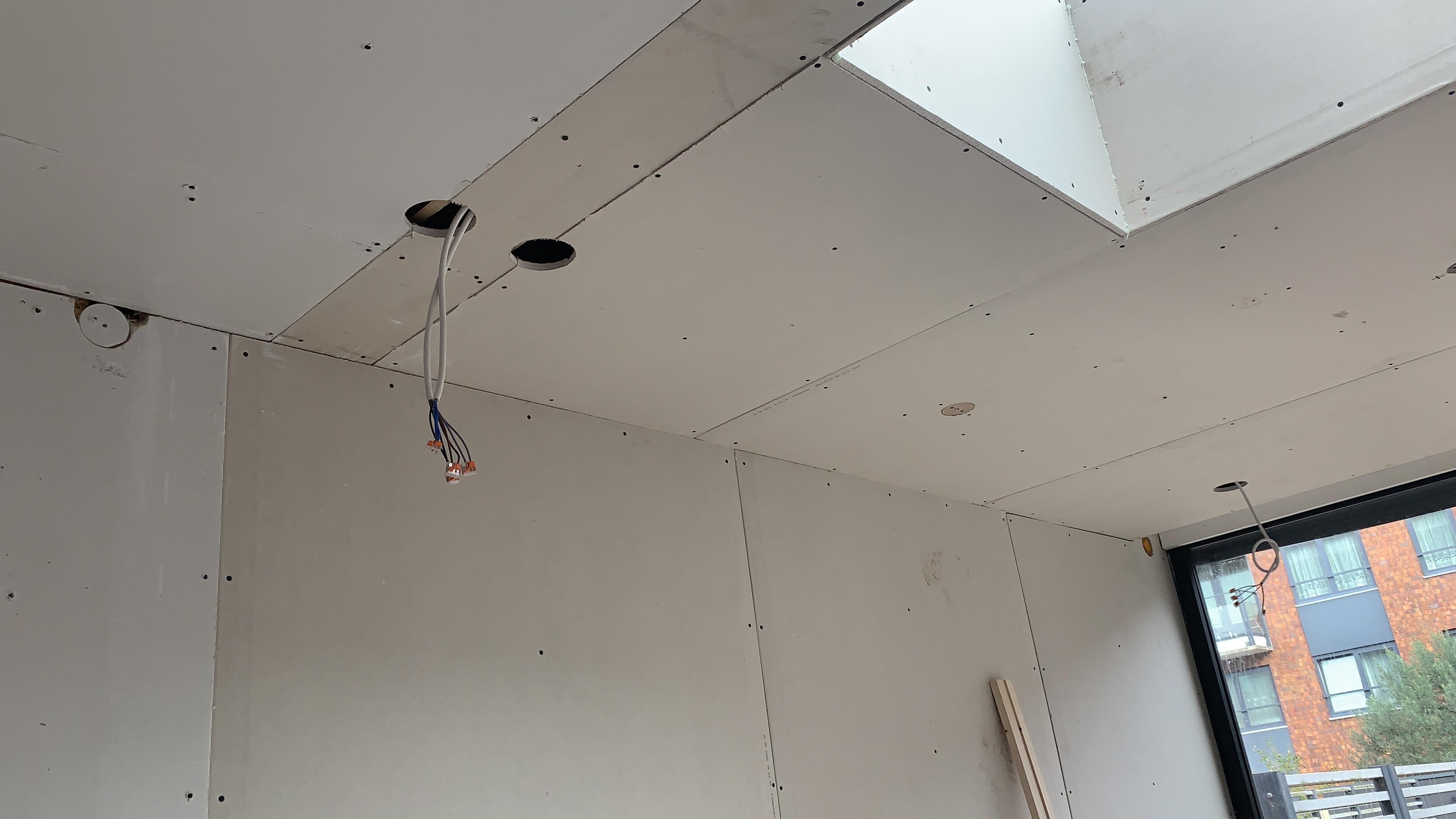

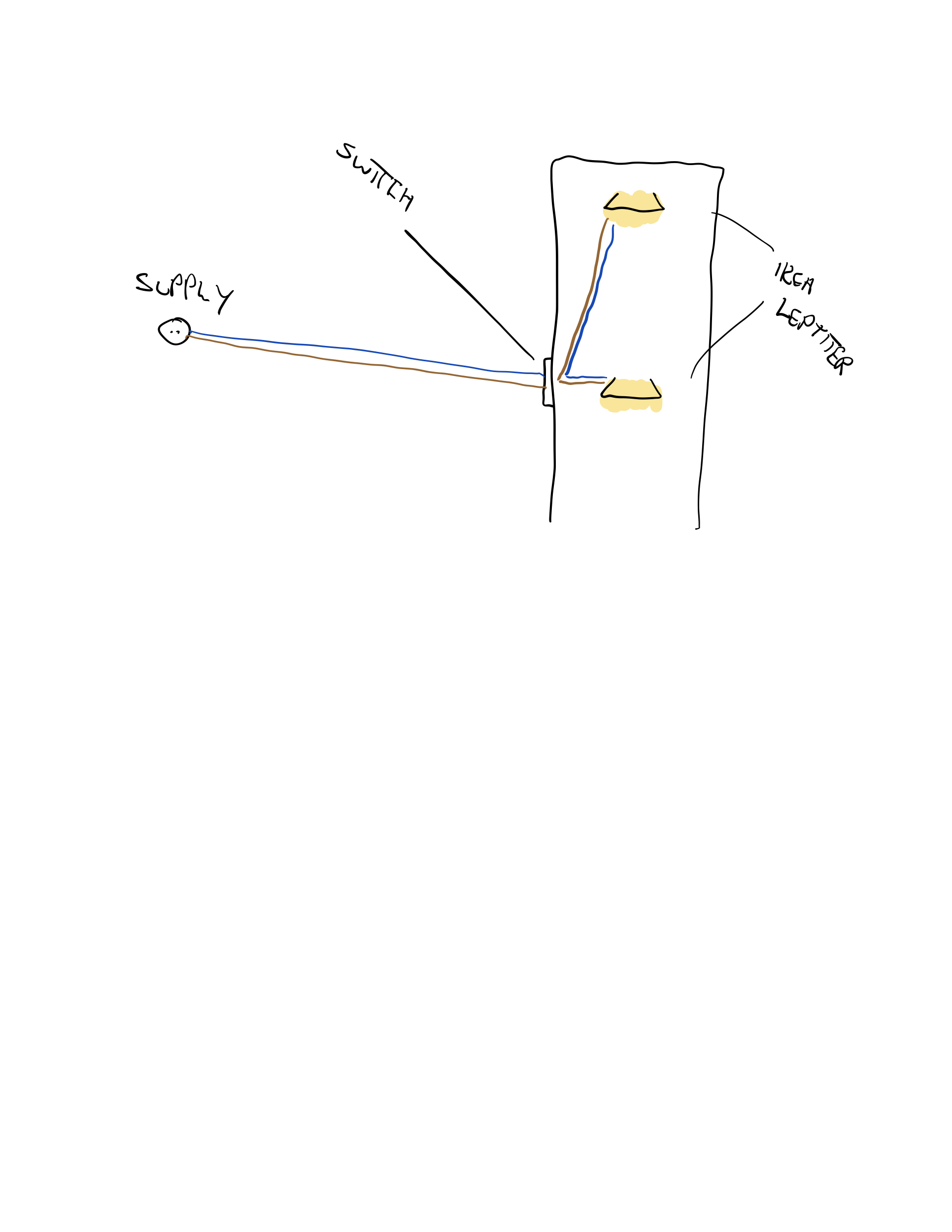

Hello, Ive built a small cove /wall - and I’d like to place the wiring for my lights before the electrician comes and wires things up. And! Primarily to allow me to get on with my plasterboard work. Below is my wiring diagram, and I just wanted to check if this was ok and ask a few questions. it’s some simple ikea lights (Leptiter) that take a mains supply. The supply will come from an electrical socket nearby (electrician told me this was how he would do it). Then a switch to isolate it is built into the unit /wall. Can I simply buy some lighting flex and wire to each of my lights, then take this to the switch outlet (switch isn’t installed yet! Just the hole drilled). Then, when sparky comes, he will terminate /join everything at the switch? Also, what cable should I buy? I notice he extended a light fitting we have elsewhere with a more flexible, 1.8mm cable (with an earth). but I think all the mains supplied lights in The house use a more rigid, 2.5mm cable..... Any help greatly appreciated. We are in he Netherlands, so things are slightly different in that they tend to use /run separate cables for N, L etc..... thanks, Neil
Thanks Steamy....

Not so keen on using an adhesive if possible! much prefer screws..... i'm not in a hurry, so I coudl always predrill etc. thanks!!

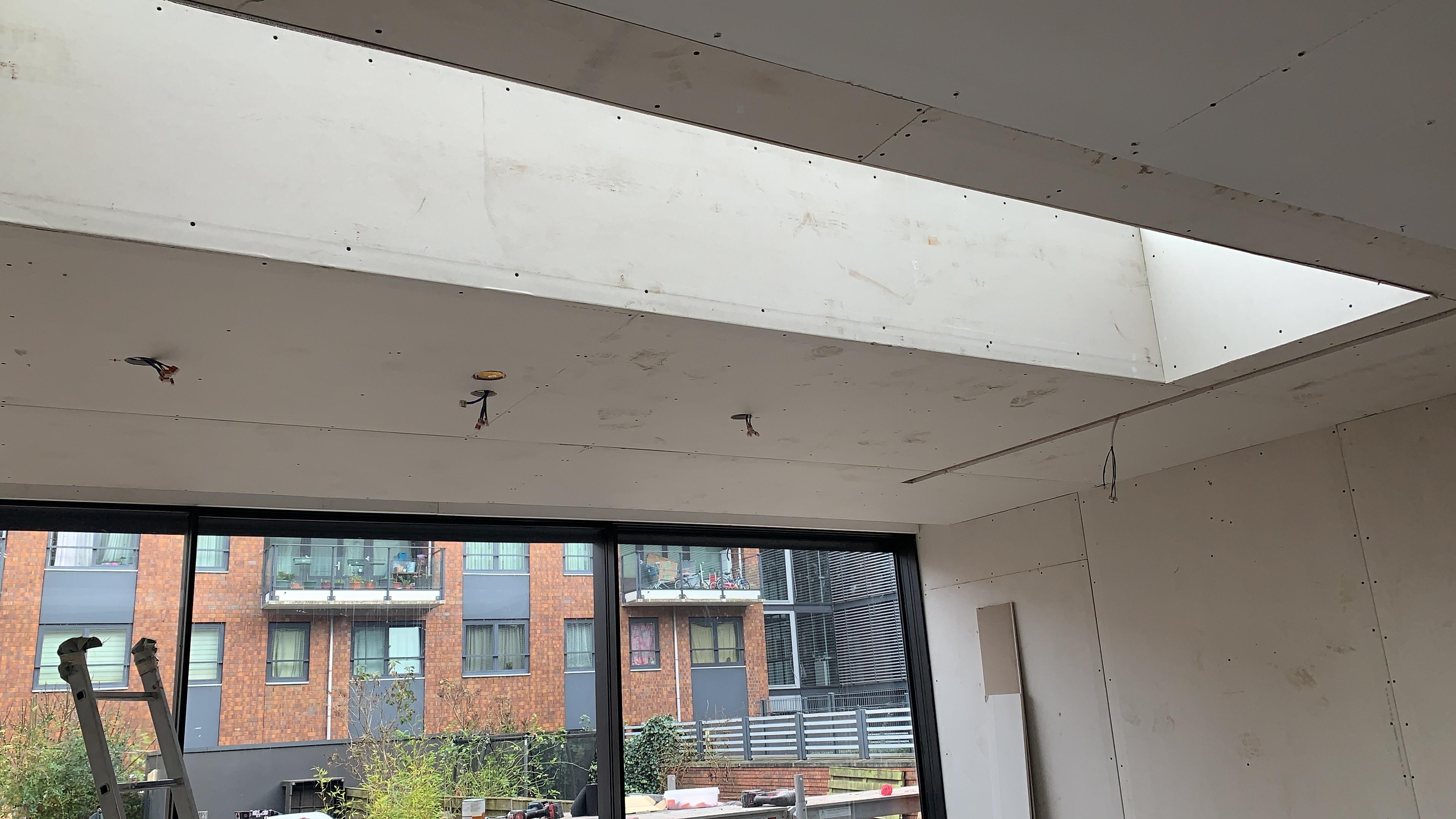

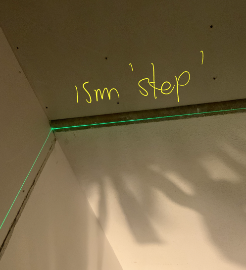

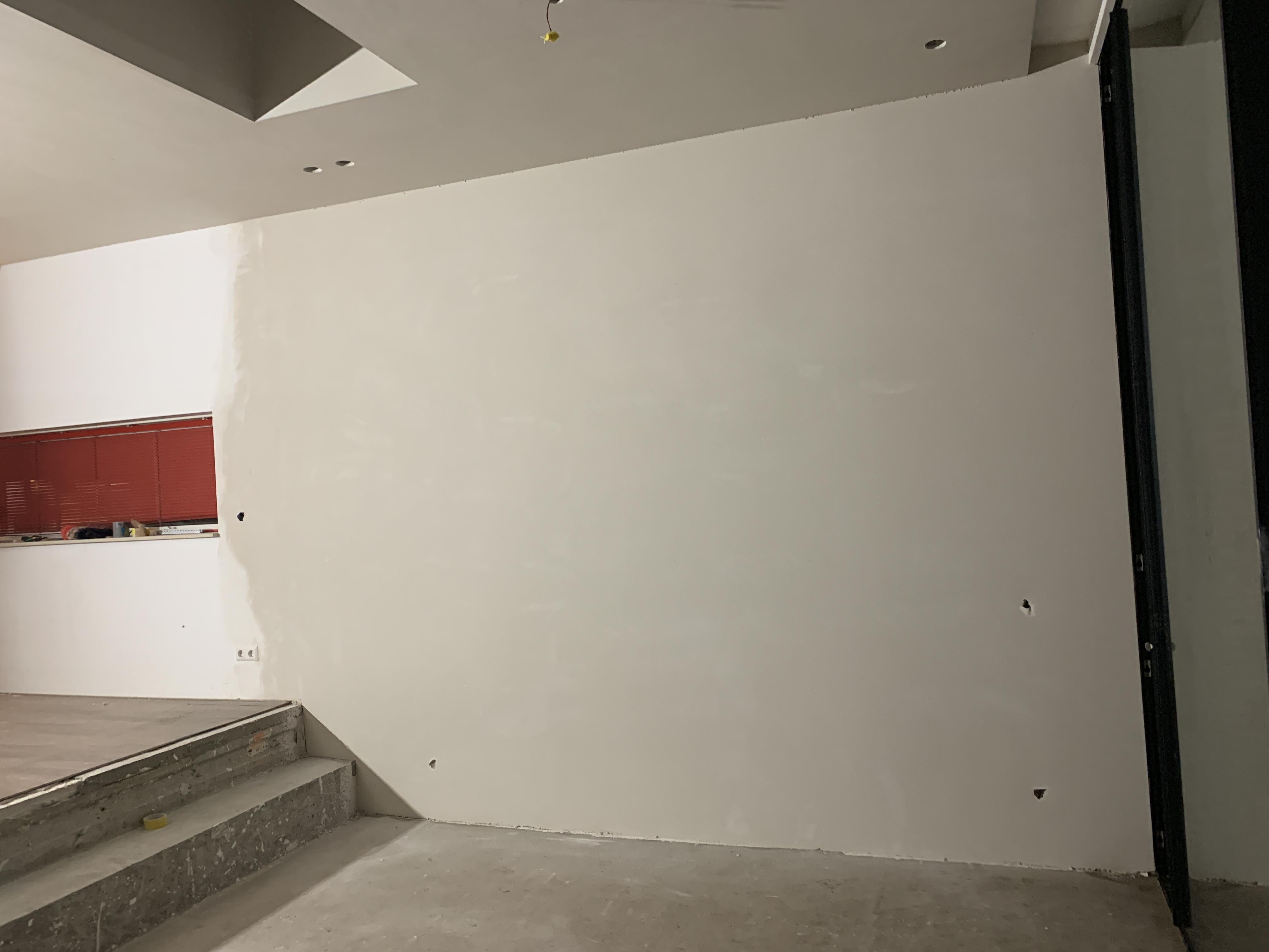

Thanks Temp, Onoff - i'll see if I can source those screws (I'm in Amsterdam here - it's just finding the Dutch word sometimes that is difficult! ? ) I use DeWalt - so I was actually going to get an impact driver for this project. If you have a recommendation that would be great. I always see two offered together and never know which one is good for me. On the step - actually, it's only at this point and about 800mm wide. if you look across the whole ceiling at this point it narrows to within plaster-skimming-range (few mm)...... I mentioned it to the builders, they said it's just the shape of the old house.... not sure I buy that haha. I don't think a layer of plasterboard is going to work - what you don't see behind (the new build, in the other direction) is about 22sq m of ceiling. @Temp - when you say join two pieces of 2x4, I'm not sure I fully understand this? I guess one option would be to run my top plate through my saw to make it a little thinner. Once it's all in place, the plasterer is coming to skim both ceilings - to have them match (all in all it's about 50 sq m of ceiling). thanks again, pic for reference. Neil

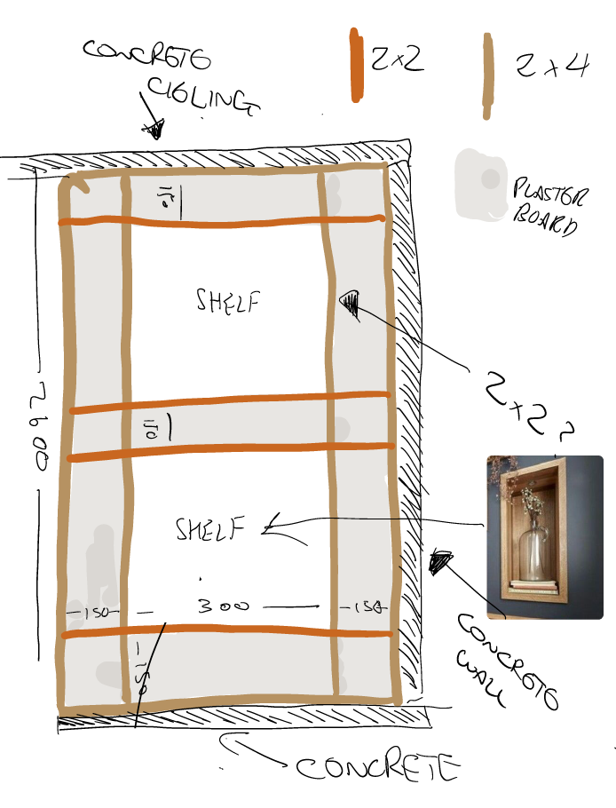

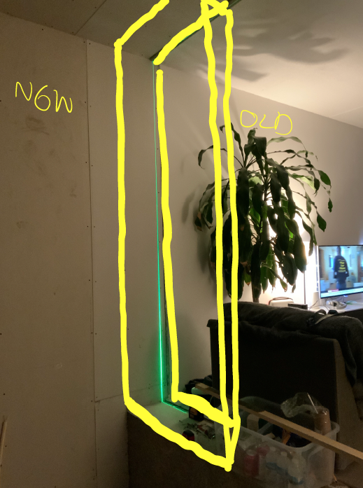

Hi All, I'm creating a very small 'divider wall' (total width = 600mm) - which will hide the side of our soon-to-be kitchen (on one side) and will house shelves on the other. The wall is a sort of divider between our new extension and the old house. Old is concrete, new is wood /plasterboard. I have many questions - so I thought it maybe easier to just list them out and hear from your experience. I'm fairly novice but competent. To get the depth (300mm) I'm thinking two stud walls. Is that good practice? I'll use some 4x2 to 'join' the two walls and 2x2 for the noggins and frames for the shelving to go in after plasterwork What type of screws should I use to go straight into the concrete? Do I need to pre-drill and use rawlplugs or is there a special screw that can go straight in? You may see a lip at the top /ceiling (between old and new house) it's about 15mm and unfortunately it is around the center of the 4x2 frame that I will place on the ceiling. Should I add some sort of shims here or just screw it on - and although the frames wont align perfectly the plasterboard will hide these discrepancies.... Hope to hear from you, thanks, Neil
