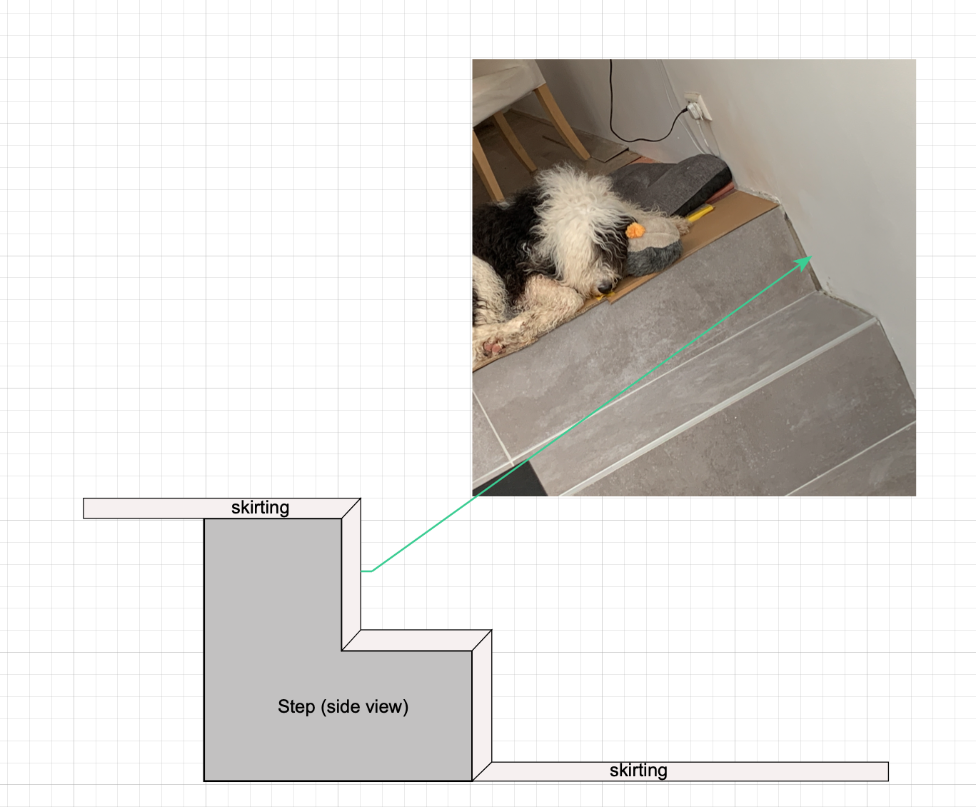

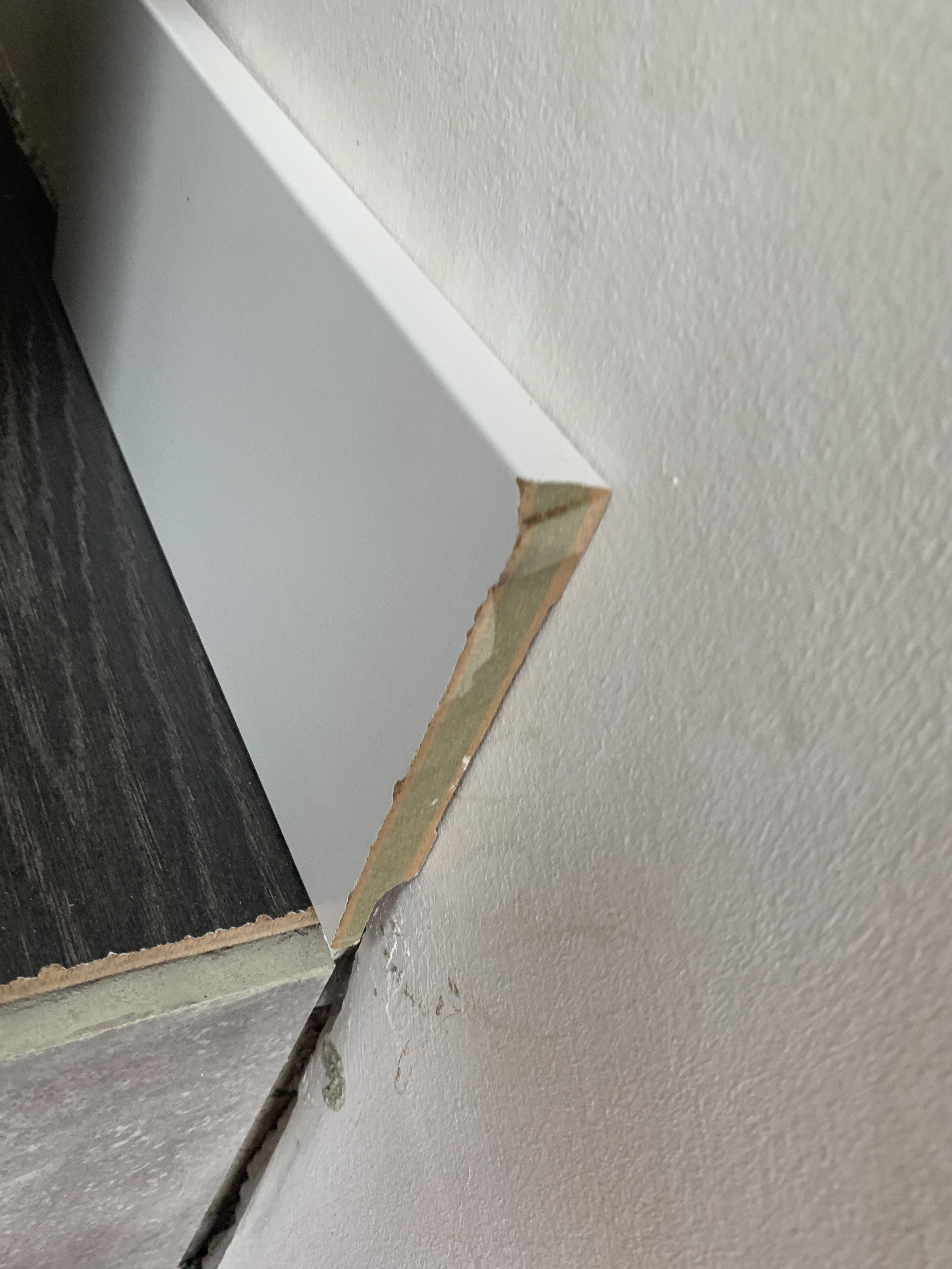

hi all, I have a step - and I'm looking for advice /example son the best way to skirt the side of this step. I'm using 100mm MDF board. Below is a photo (excuse the dog, she's everywhere I turn!) Also, the way I was intending to do the joins (mitre). An example of the board (in situ) I am using Keen to hear your thoughts, many thanks, Neil

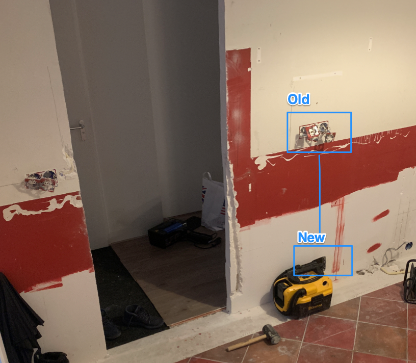

Hi All, I just wanted to know what best practice was when extending (moving a socket down) on a wall. I'm in Amsterdam, so I know the regulations are different - but still looking to hear best practice from UK perspective. My thinking is: I use a connector (I have wago 203 connectors for this) to connect the new cabling. Keep this in the old back box Chase the wall Wire new socket below Rinse, repeat. Plaster over once ll sockets are done (as whole wall will be plastered). My other question - if you need to take a socket no only down, but along the wall. Is it still ok /best practice to chase the wall horizontally? It doesn;t quite 'feel' right to me....but thought I'd ask. Edit: FYI, the walls are made of this soft white concrete block stuff (horrible! - same material inside plasterboard). thanks! Neil

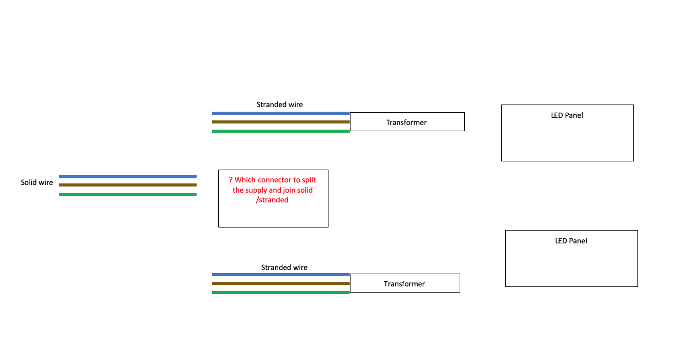

Hi Peter, The wago I had was lever type - the cable was too thick. I'll measure properly. The problem is - the wago is perfect for the stranded wire but not for the solid wire. And Prob vice-versa..... I could just use conductor block - but I like the neatness and quality of Wago. Neil -

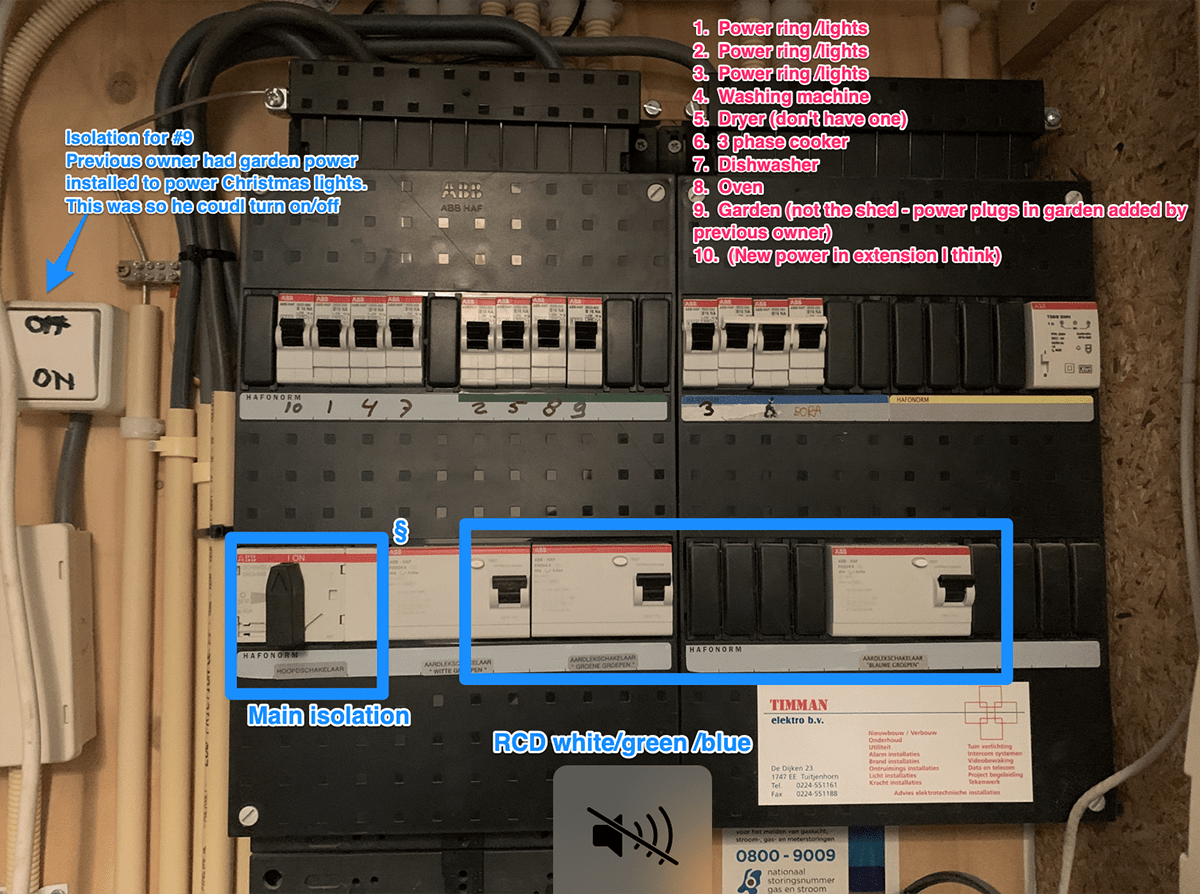

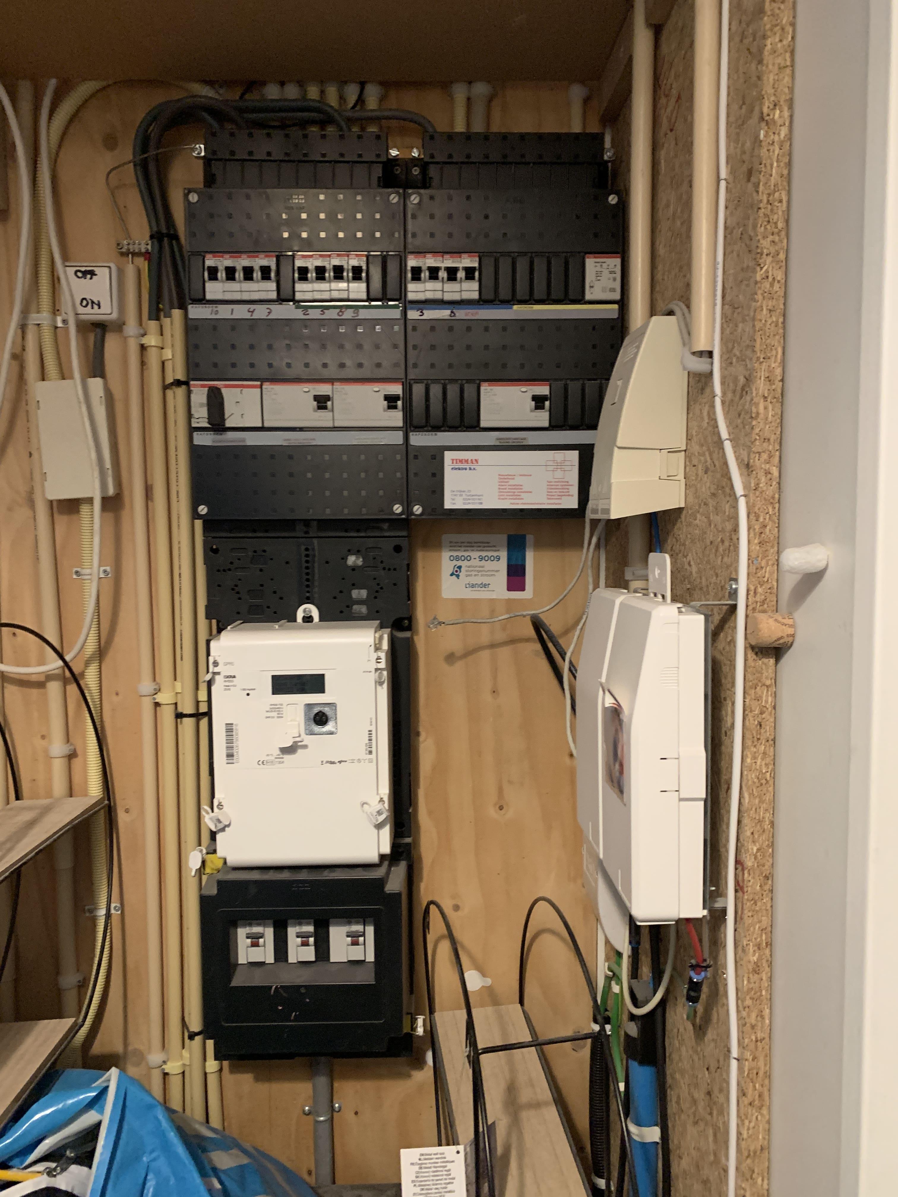

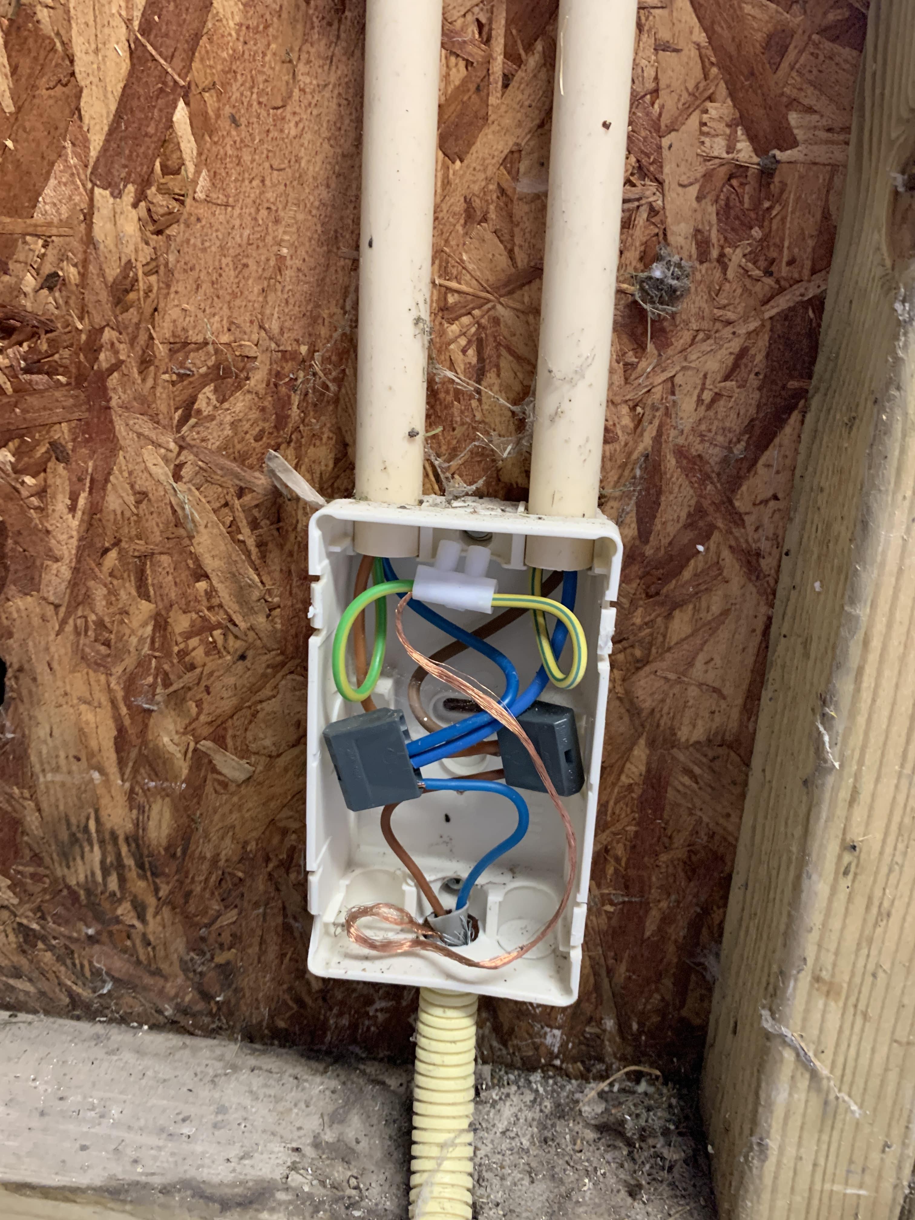

OK.. so here are some pics. - 1st pic is the main CU / board - 2nd pic - same but wider view - FYI - 3rd pic the switches for light in the shed (other line is for outdoor light) - 4th pic - this is the junction box where the supply that comes from the house goes into the shed (it's about 1m below the switch in pic above). - 5th pic - 'instructions' in Dutch. But has a diagram I've still to test which of these controls the shed. Can't do while Mrs is doing her work calls! - but I think 1 2 or 3 will control the power in the shed. thanks, Neil -

I'll take some pics. but we recently had the house extended - and I remember seeing the cable that runs under the garden to the shed (was done as part of the building of the house 12 years ago). It was a cable inside a PVC tubing (like a grey plumbing /drainage pipe). I should add, i'm in Amsterdam, their building practices here are a bit different. Neil -

Hi Nick, thanks for the reply. I couldn't actually see which circuit this belongs to - since there doesn't seem to be a separate circuit (oddly enough) for the Shed - So I think it belongs to one of the others. I'll do some trial and error to find out - and report back. The old light (fluorescent tube) was wired straight to the supply cable.... ? thanks again for taking the time to respond, Neil -

OK - that was my thinking..... I think my current waggo's are maybe too small.... because the solid wire wasn't staying. thanks! -

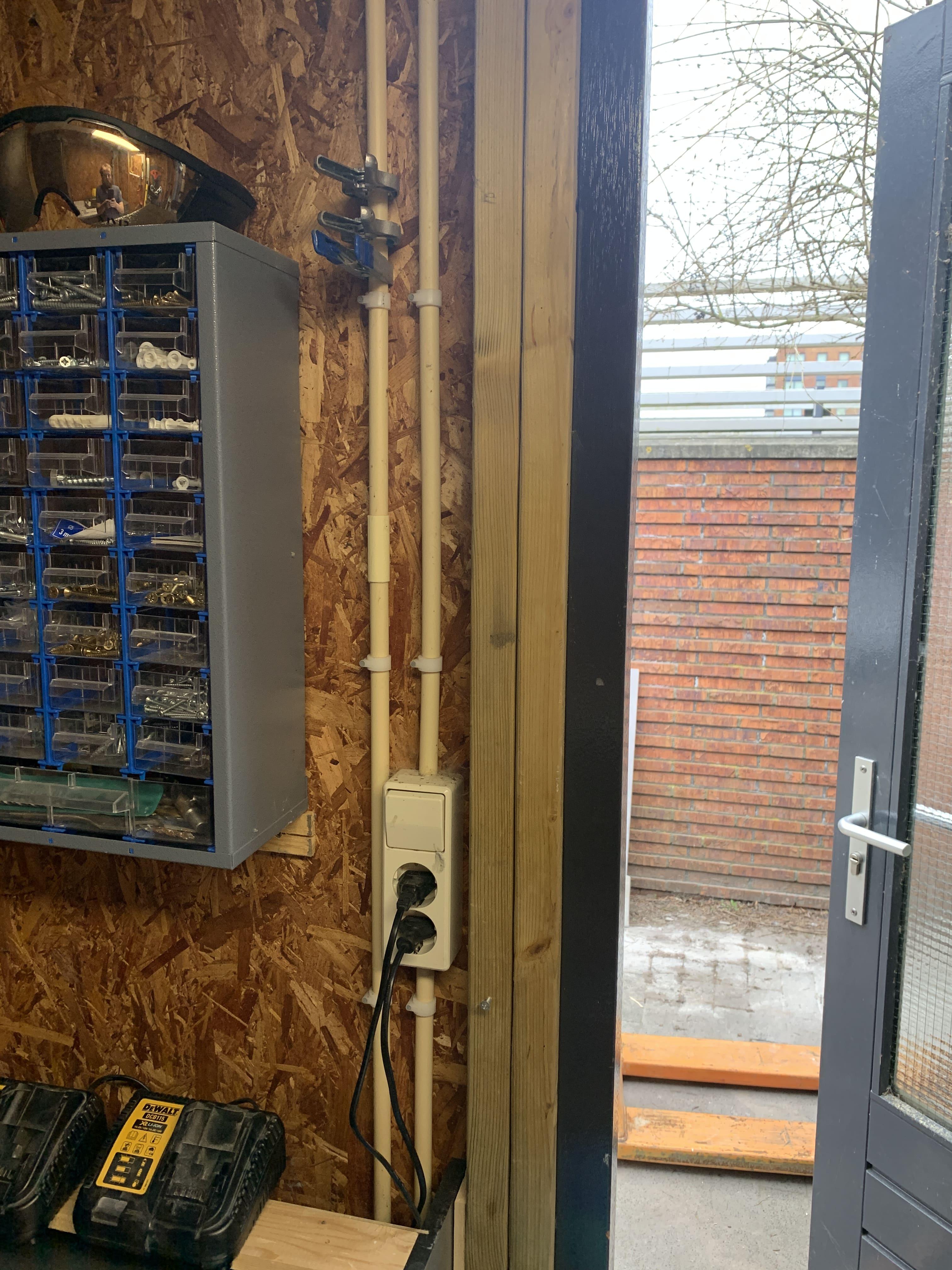

Hi all, Sorry if I'm not using the right terminology - or if this should be in the lighting forum, I couldn't work out where it should be. I'm rewiring some lights in my shed - which already has a supply installed by the builders of the house. It has a basic tungsten light, and I'm replacing with two LED panels - which have transformers. I have done this with a block connector to test it out, but I'd like to know the correct practice to make this better /neater - preferably with a Wago connector or something (and then I'll put a little box in place to house this). - The supply comes in, L, N and Earth - it's a solid wire. circa 2.5mm (I'll check exactly). - Supply has an earth - but the transformers don't... is this ok? - The wire I'm taking to my transformer(s) is a stranded wire, circa 1.5mm. I'd like to take the supply, and then split it into two - and then have each light supplied from this - you can see my drawing below - hopefully make sense. Thanks for any help, Neil
