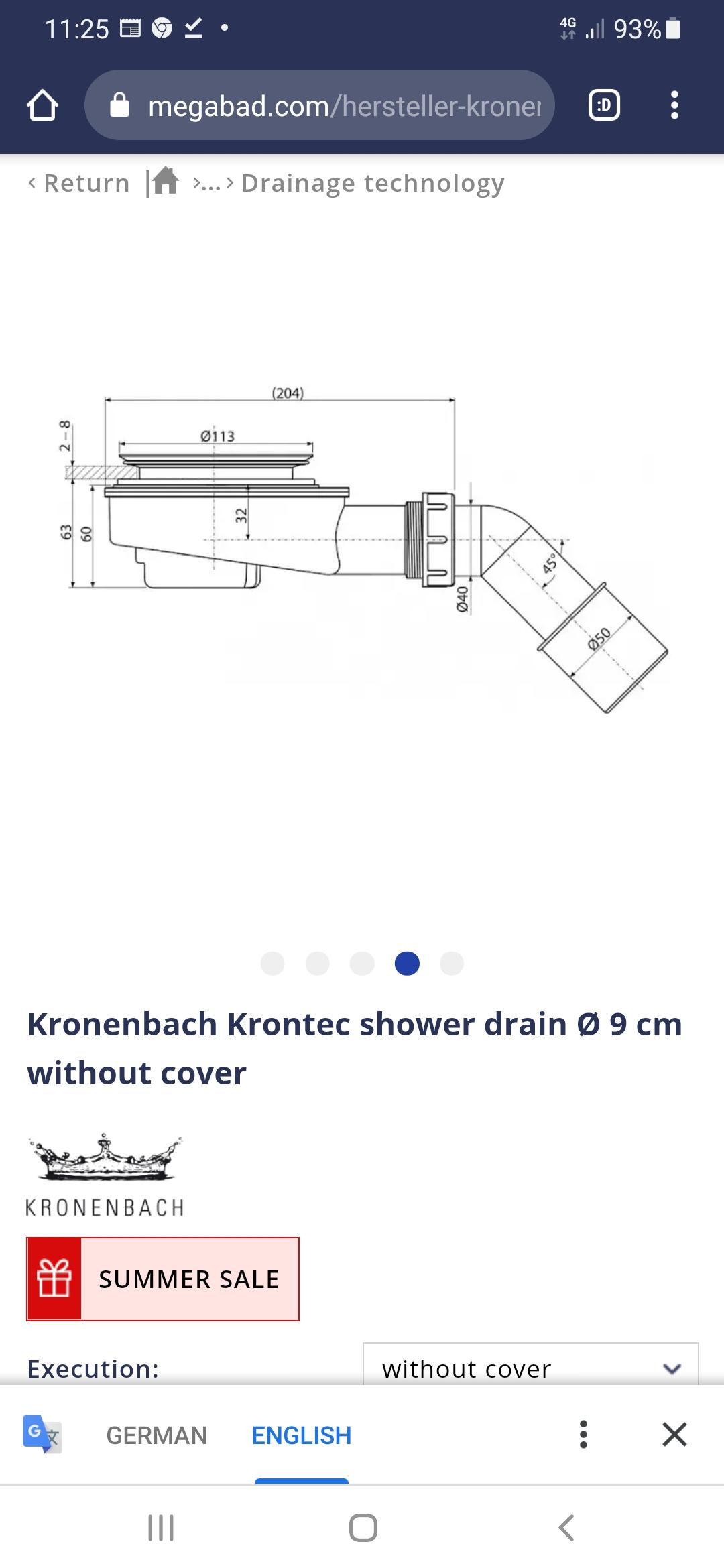

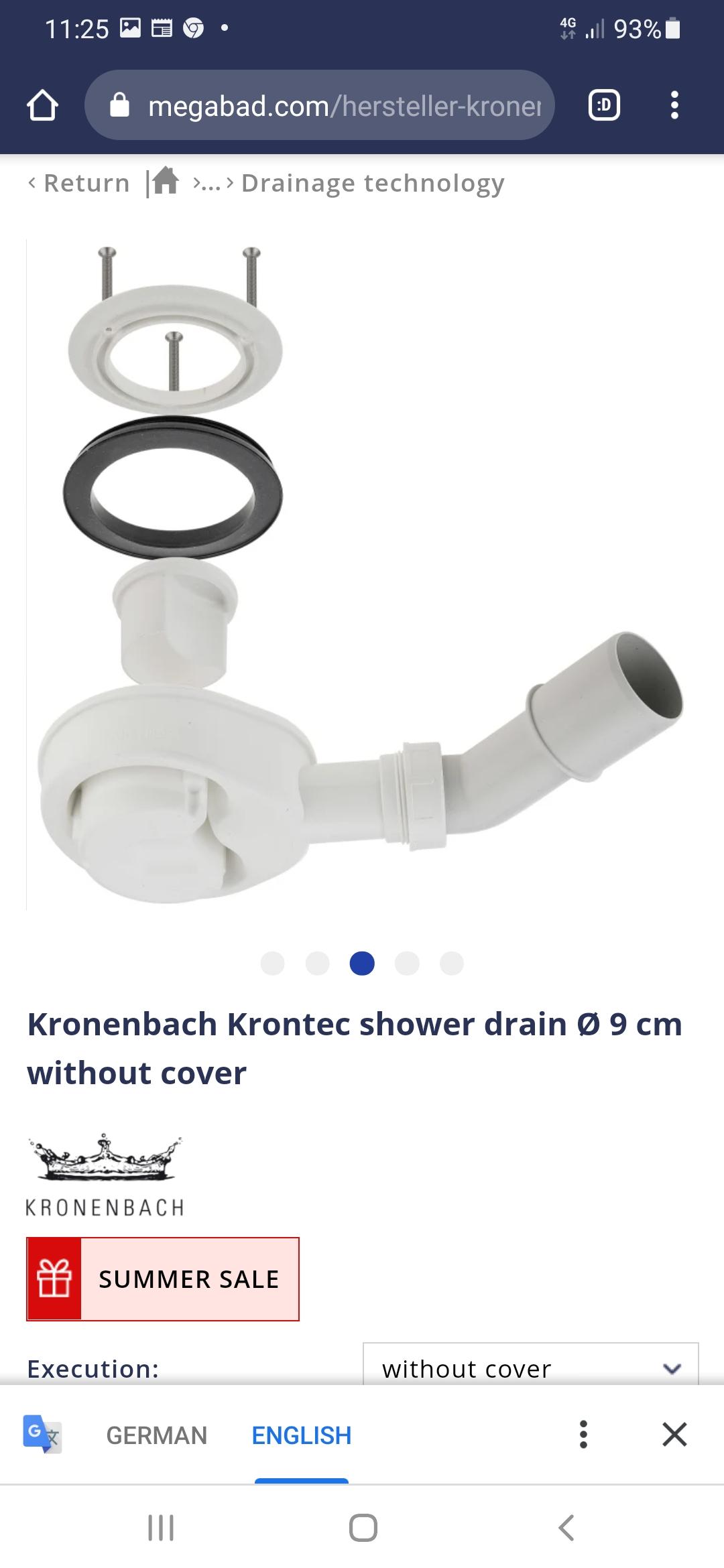

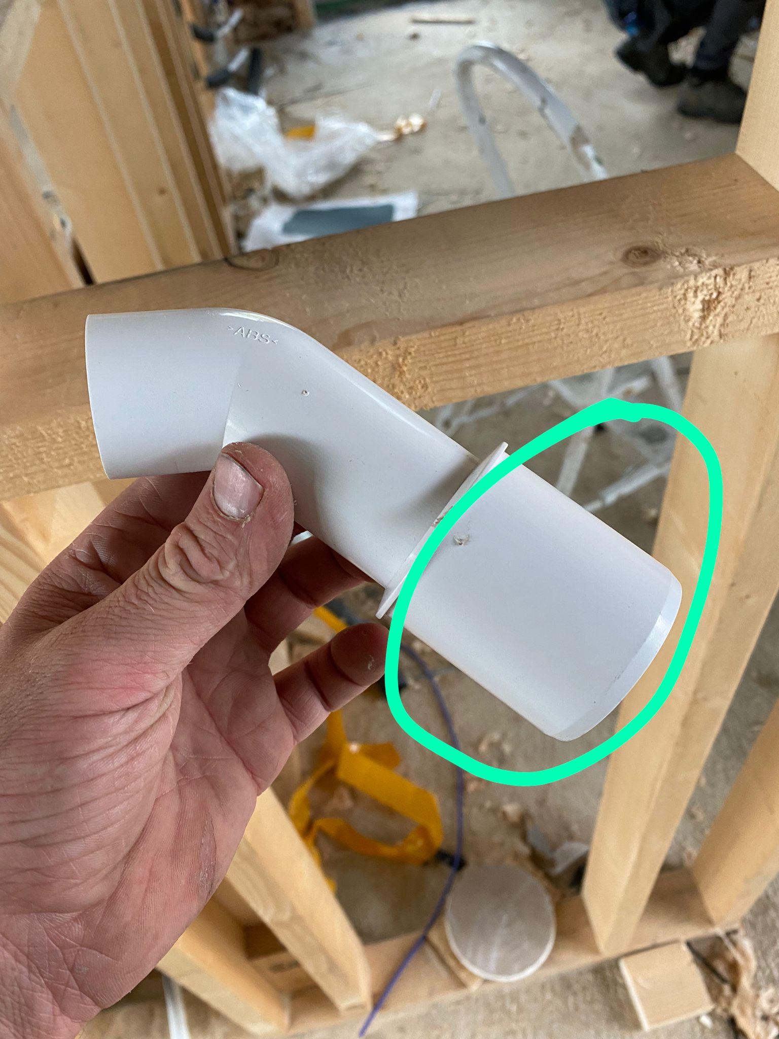

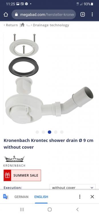

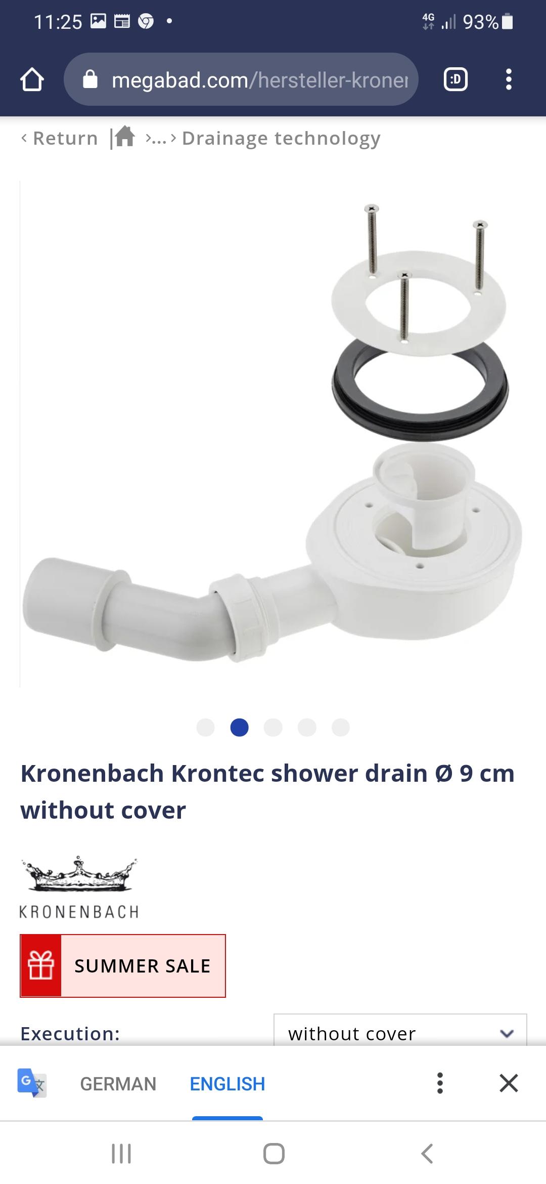

Shower trap compatibility problem - megabad.com order
Donegalsd replied to Donegalsd's topic in General Plumbing
Thanks, The plumber says Ok, I will try this….it should actually work. I got a 2” mechanical coupling to go onto the larger part of the bend but it wouldn’t work due to an inner sleeve that the fitting has whereas the smaller 1 1/2” fitting doesn’t have this. Which sounds good. Thanks a million - I have already ordered the wrong cage for the wall hung toilet, so hopefully it runs smoothly from here. ? -
Hi all, I just had a text from my plumber saying - this piece, from a megabad shower tray isn't compatible with irish fittings. It's for the the shower pictured below too. I'm not a plumber so any help would be appreciated.
