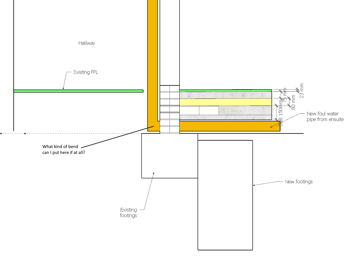

Can I get a rest bend to go through an existing external wall?
lstevensuk replied to lstevensuk's topic in Waste & Sewerage
Thanks @ProDave I understand now. I think that was just in case it was easier to run the pipe through the existing external wall first then down into the extension. But as you say much better to hide away in the hallway 😀 -

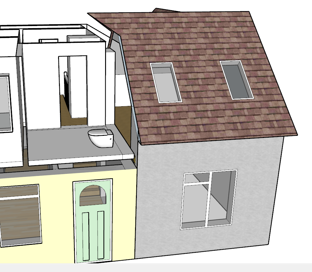

Sorry I'm confused where the stub stack would go, should it just be inside the bathroom? I was going to run the pipe up into the attic with durgo there. Maybe this image will help. -

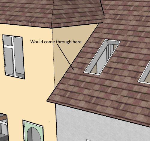

I could pass it through the external wall directly from the ensuite and then down into the extension but was trying to avoid having the pipe in my front rooom. As it is an attic truss could try and squeeze in the void but a bit tight, and then I believe I'd need to go up through the roof for the ventilation. Hence trying to keep it inside and up into the existing loft with a durgo. -

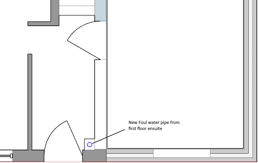

Thanks @Jenki that's a good idea, I've been looking for an excuse to dig up the hallway and put new floor down anywa and it would bring the pipe more central on my extension. Can I core through for the long radius bend or do I need to a bit more in depth brick removal and small lintel do you think? -
Trying to work out if it's possible to take a foul water pipe from first floor ensuite down inside my hallway and then through the existing externall wall and under my new extension (block and beam floor)? Can I simple put a 90 degree bend at the bottom of the stack and core through? I'm trying to avoid going through extrenal wall as it would then need to come up through the middle of my roof in an awkward spot. Thanks!
