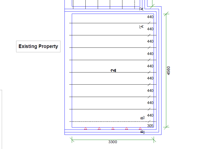

  4. Hi - Just had my specs for for the block and beam floor, and looks they are proposing I cut the beams into the existing wall on the left. That looks like quite a bit of work to me cutting 9 x holes? Would I be better digging a test hole find my existing foundations and see If I can fit a single block wall and sit the beams on that? Thanks!

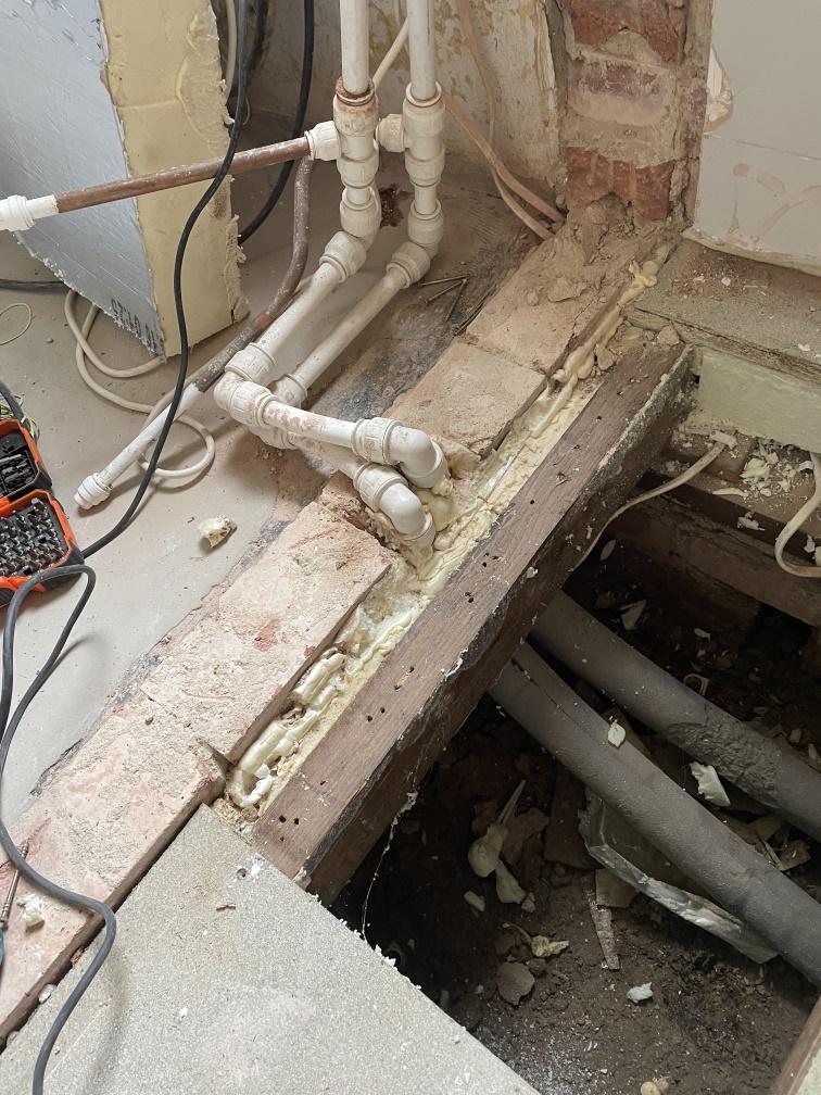

  5. Hi, Having removed a non structural wall to make my hallway wider I'm left with the last few rows of bricks. (Pipes etc I can sort). My question is how to best deal with the hole when I remove the row of bricks. Left side is solid all the way down, as you can see right is a suspended floor. Should I just shutter it off and fill with concrete then level. Could also remove few bricks and add insulation - only the brick width! Install a new joist and run my chipboard over the top? Remove the left and put new joists and insulation in. Think that's about all my options. Left side is about 850mm wide right the same.

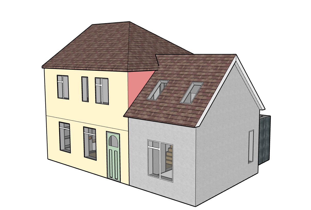

  16. Thanks for the feedback. I'm not sure if I have the room to move it to the right but possibly can rotate it around a bit so it cuts through the middle. Would mean digging up a fairly new tarmac driveway though
