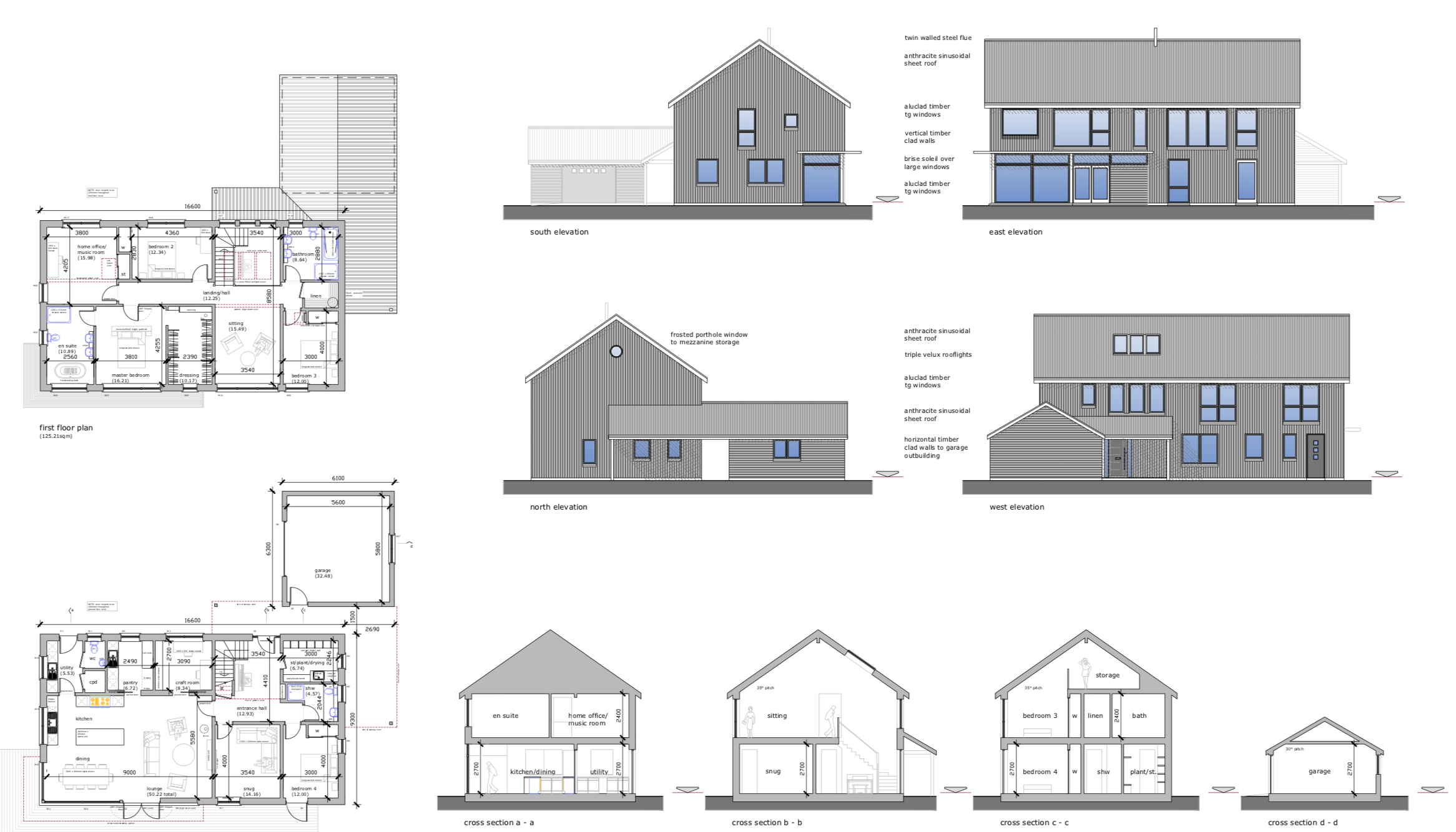

Hi, we've got a plot just outside Oban and are looking to built a tight, well insulated timberframe house with MVHR, ASHP, UFH and some PV. We're expecting the building regs drawings any day, and then it will time to find a builder and/or timberframe company.

These are the latest (although not completely accurate, particularly on windows) planning drawings. The idea was to create as simple a shape as possible to reduce complexity and build cost so we can invest as much as possible in the fabric -

Hello all I've been skulking around these forums for a few weeks gathering info (a lot of info!) in preparation for kicking off our build process. We're building on a plot on Loch Etive, just outside Oban on the West Coast of Scotland. Me, my wife and two daughters (at high school) live in Oban just now - the plot is about 15 minutes drive - and we're planning to stay in our current house until the new one is ready. The building drawings are just about to go in and we're about to start getting prices from builders. We need to save as much money as we can by doing what work we can ourselves (we're keen but fairly unskilled) and by buying materials carefully. It's daunting and exciting at the same time, but I reckon we can handle it. (You can quote that back to me in 2 years time).
