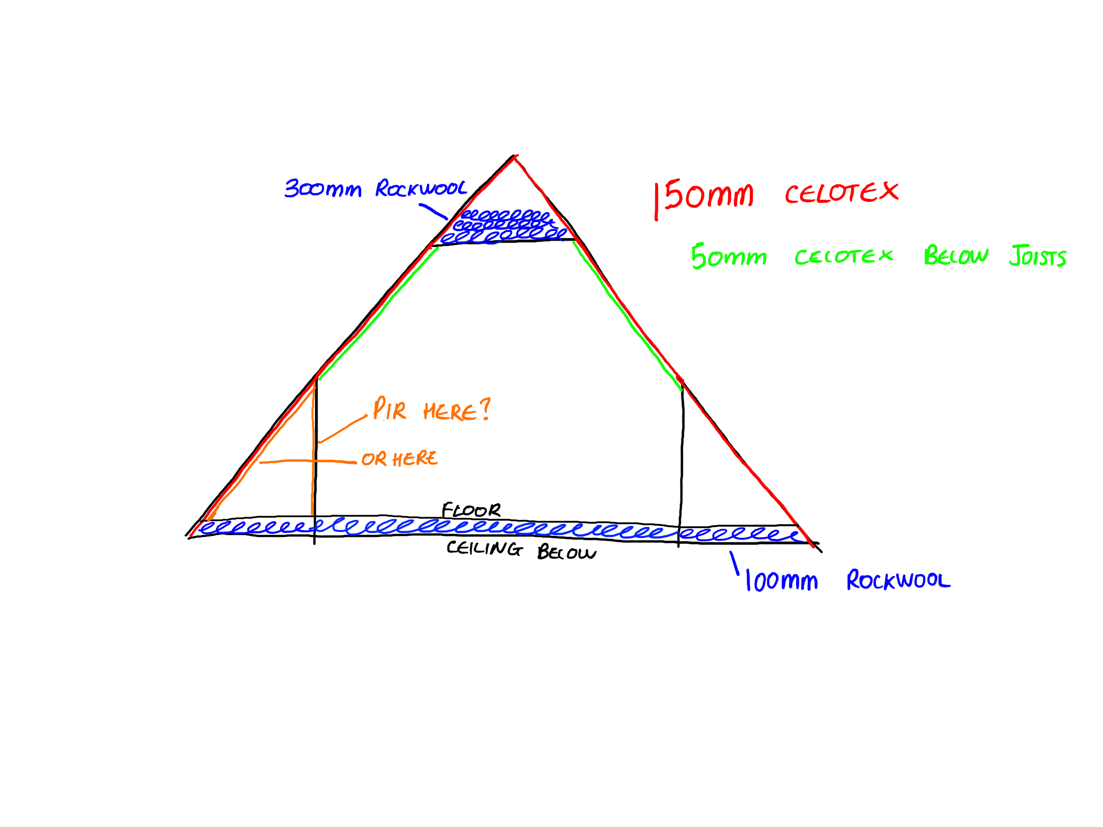

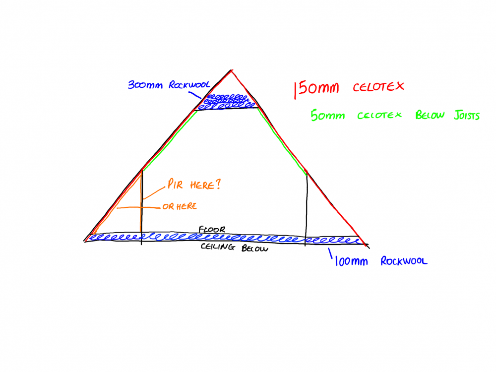

  9. I’m just calculating the amounts of materials I’ll need so I can work out some price comparisons. Would someone be able answer this for me please? I’ll just use celotex PIR for example. I need to put 150mm between the rafters and then 50mm below. I know I need to do this in the vaulted area and all the pitched part of the roof in every attic room but do I need to do this in these area’s I’ve pointed towards in the drawing? Sorry for the poor sketch lol. The 300mm rockwool is what the architect has put on my plans for above the flat ceiling in the attic. I won’t need that much if I can take the 150mm PIR all the way to the apex of the roof. I’ve spoken to Knauf, they said to use 150mm of loft roll 32 between the rafters and 75mm PIR below.

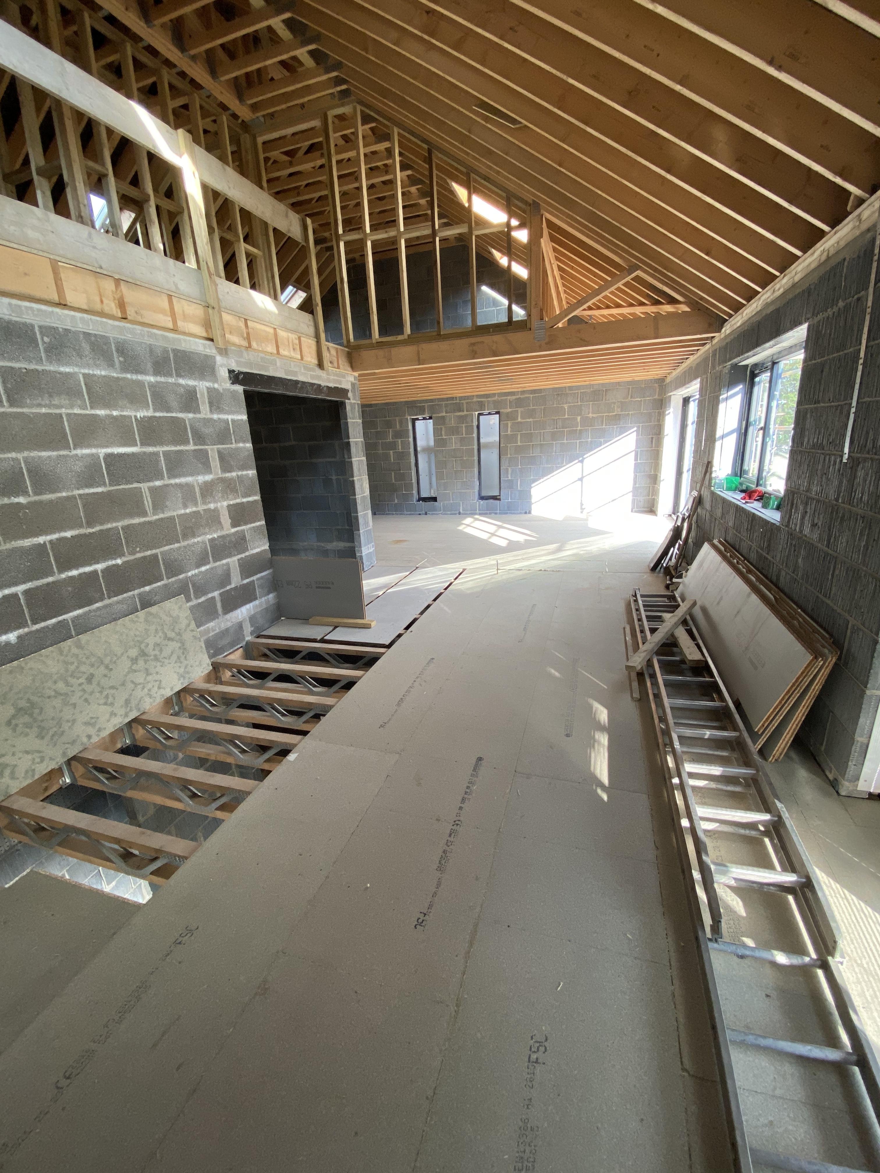

  13. Hi guys, I’m after some advice on what insulation to use in my roof. Its quite a ridiculous situation to be in but my local council have no building control offices in, all 4 of them are on the sick, 5 out of the 6 planning officers are also on the sick. I can’t get a building officer to come to site and they have turned all the phones off and we have to send emails which they will reply to when they can.. which as you can imagine is basically never and I can’t get hold of my architect as he’s away for a few weeks. I’ve got 8” trusses fixed at 400 centres and I have to allow a 50mm air gap and also lay a vapour barrier in the vaulted part of the roof. The U value has to be <0.15. It was recommended to use 100 or 120mm celotex insulation then use 37.5mm insulated plaster boards over that to achieve the u-value. I’d rather not have to use insulated plaster boards unless I have to as I’m trying to keep the cost down, as everyone else can probably relate the cost of materials is through the roof and we’re going over budget, so trying to find the cheapest alternatives where possible. Here’s the vaulted ceiling.

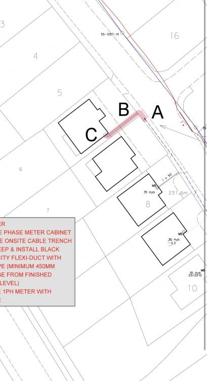

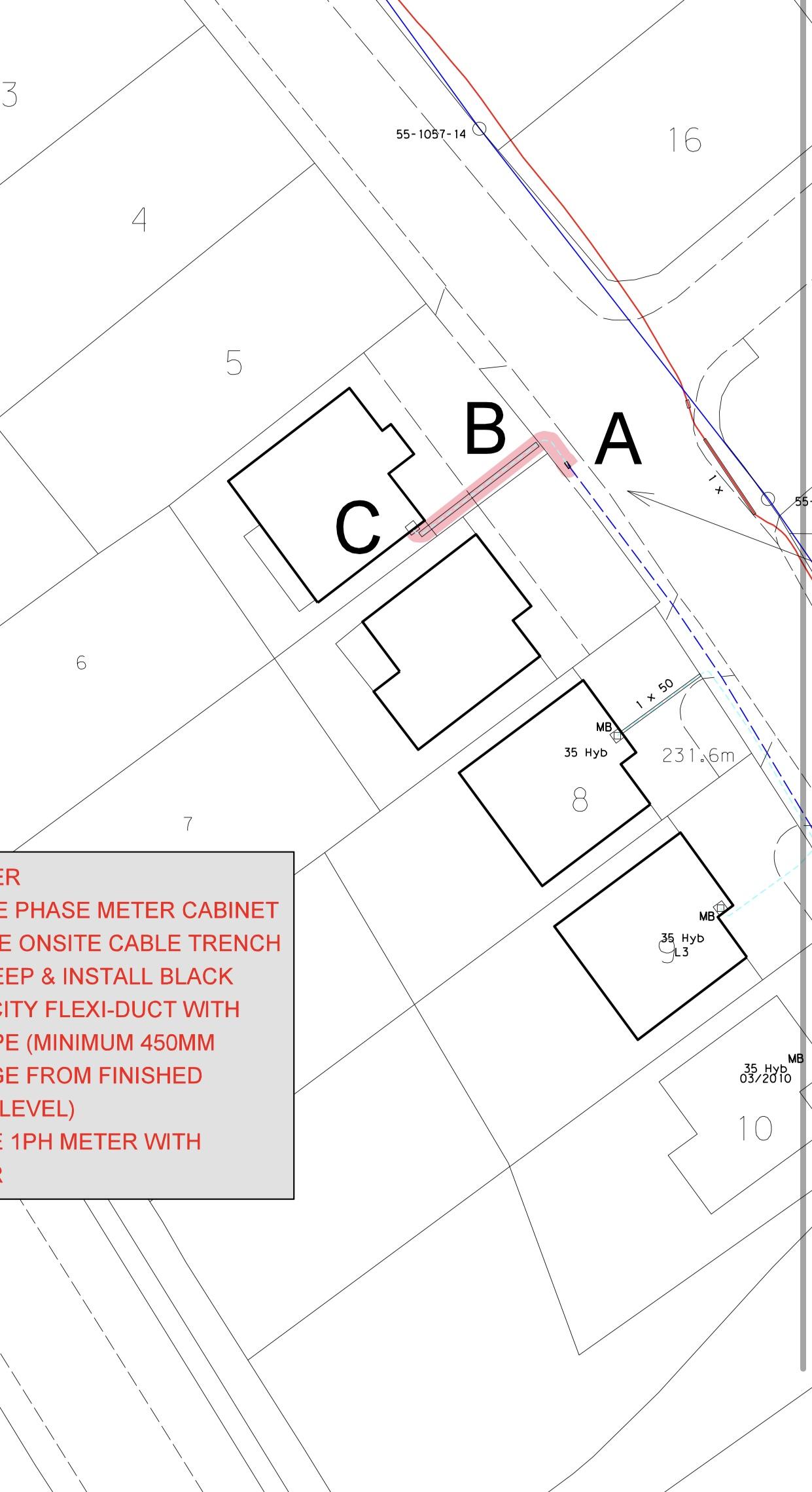

  15. I’ve just been quoted £3100 for this connection. 1m run under the pavement outside my ground and 10m run insid my ground. They’re pushing to install a 3 phase connection when I don’t want 3 phase and I can’t find anything online that says I have to have a 3 phase supply either. Its to future proof against EV charging but I’m a petrol head and no EV will ever be parked on my driveway. I’ll be phoning them first thing in the morning as I think thats absolutely ridiculous to try and charge me £3100 for that. I’ll supply the ducting and dig the trench on my property. I also want an internal meter box and they’ve quoted for external.
